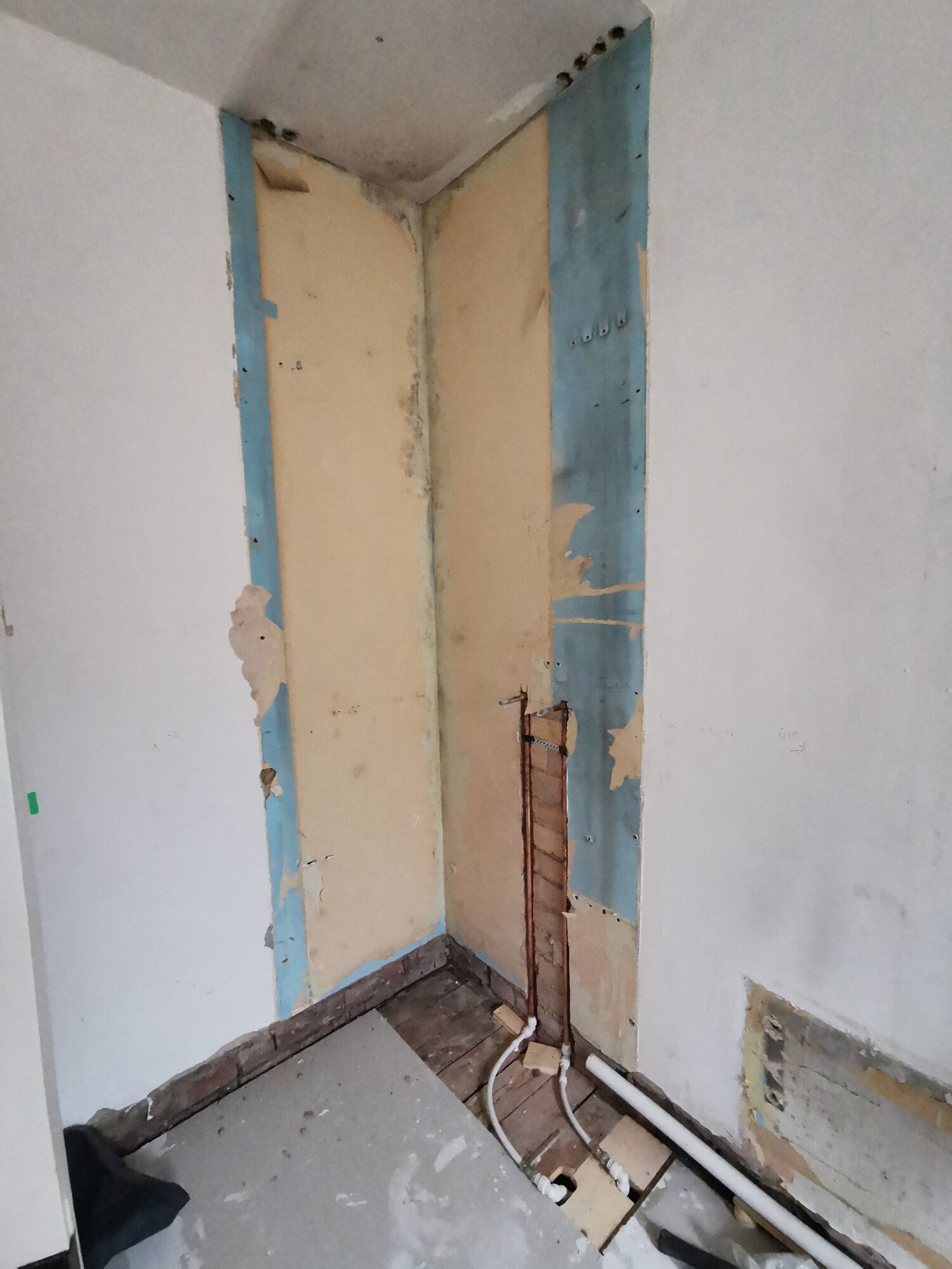

I've had first fix done on a bathroom renovation, my plumber advised I tank the walls before tiling, but I'm concerned about the walls.
The area behind the shower used to house a water tank and lots of the plaster is shot, surely this is not a good idea to tile on top of?!
I will be removing any loose plaster and if lots wants to come off I presume I should re-board. Which leads me to my main question, should I be looking at water resistant plasterboard or Hardy or other, and if so, is dot n dab enough to hold the weight of tiles, or should I be looking at mechanical fixing into the brick?
Photo of area behind shower is attached. It will be 900x1200, combi boiler fed, resin tray with R2 shower.
Thanks in advance for any advise!
