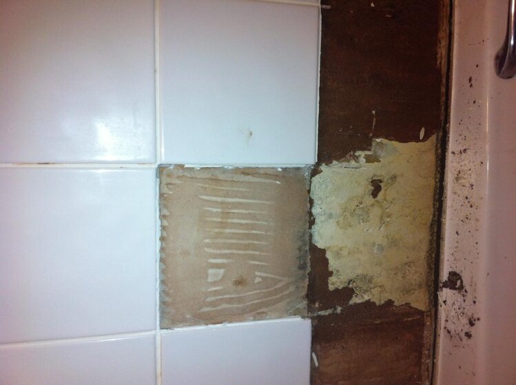

Right i have a big problem... I have taken 9 tiles of the side of the bath without damaging the other tiles.. I doing this because the tiles were lose and grout was crack and have been for about 2 years.. this is where i find myself being an idot for leaving it too long.. the adisive (not sure if that how you spell it) came off on the tiles so the plaster bored is intact.. or plaster on top of it is... But it damp and very damp if you ask me... been told the whole lot need to be rip out and replace will cost me a fourtune.. but this wasnt from a builder it from my father in-law.. will have to save a while to do this.. but is this a possible soloution below
Let it dry out for about a week
the re tile it???
mean i have to bath all week
Hate to say it but, your father in law is spot on. A lot of water damage there and I'd say it will be the same behind the other tiles.
Upvote 0
the plasterboard is ruined and needs replacing. you may get away with removing just a few rows till you get to some solid /dry board. it won't cost a lot to do, an 8 by 4 plasterboard is only a fiver and by the looks them tiles are 150 x 150 whites so only cheap too. you'll be wasting your time and money by retiling on that board
Upvote 0

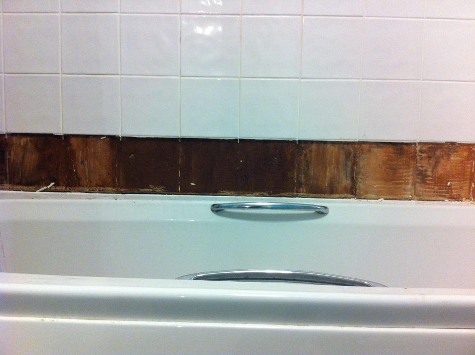

yes there is a shower where it realy bad it that where the water was hitting.... gonna cut it out and replace... water got in because crack in grount and left it for 2 years... i teaken above tile look dry but feels wet i up load a pic u think i should cut the ones above off too????photo.jpgphoto.jpg
Upvote 0
Then your father in-law was right you need to remove and re board (could use a waterproof backer board) or plaster and tank patching a small area is a temp fix
