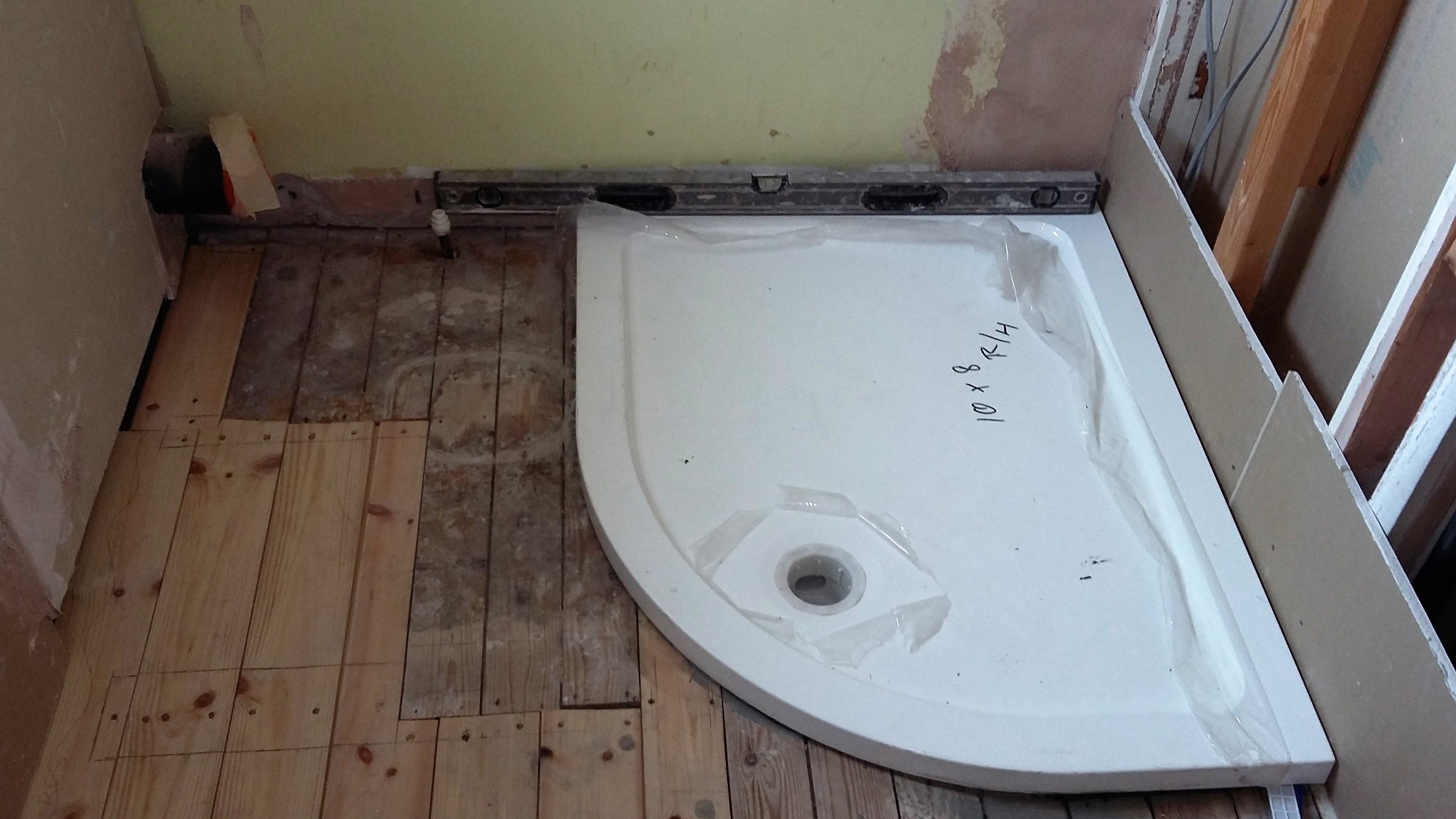

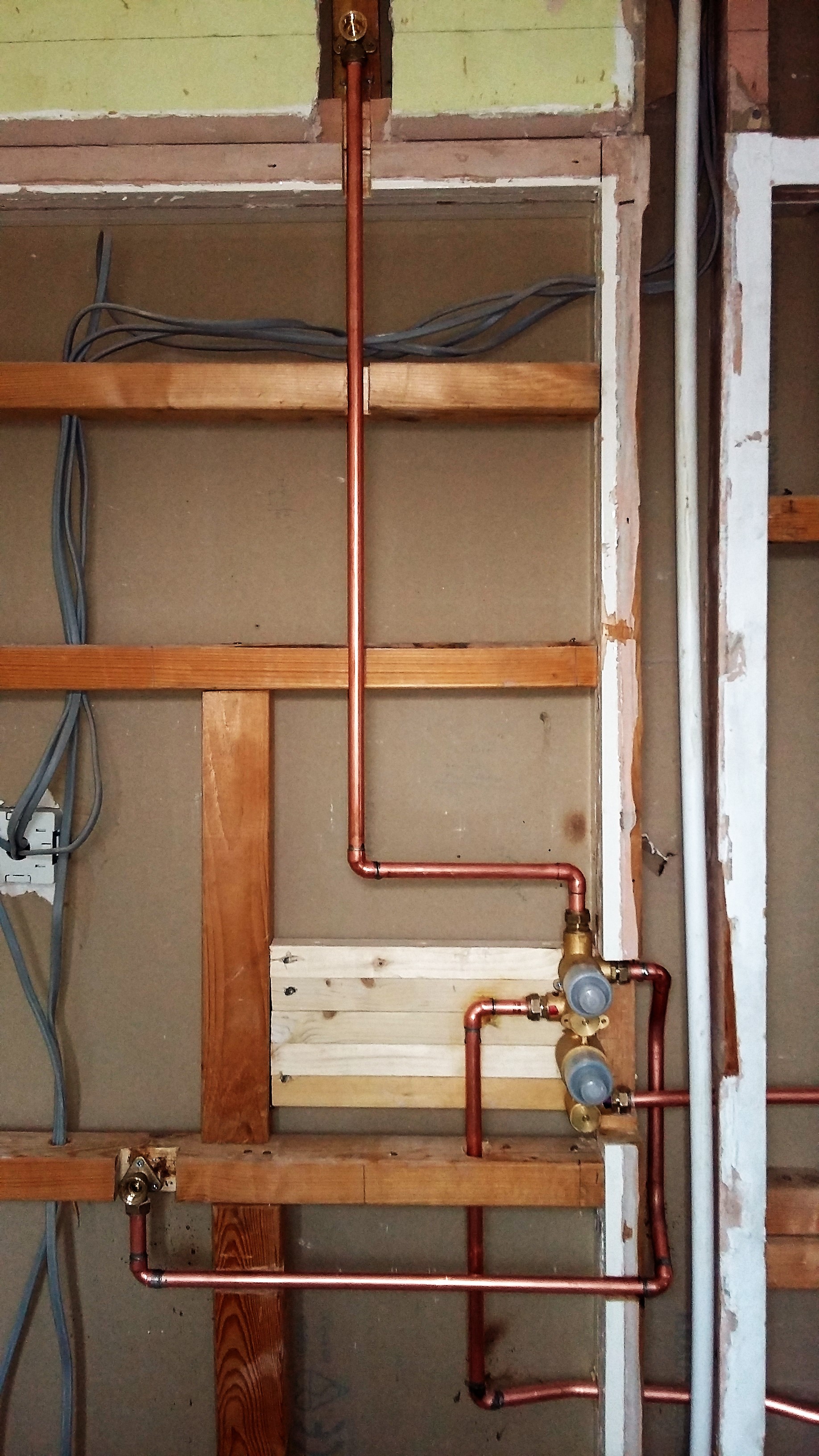

Got tray and waste fitted today. Originally had basin and shower waste exiting as one pipe when I did first fix 6 years ago - had to separate them now to get over the double joist problem and new tray waste hole position so didn't quite finish all of first fix as planned. I've had to core drill new waste pipe to outside, still at least they'll be no chance of gurgling now if basin and shower is used at same time. Also fitted valve and piped up for shower heads.
Tomorrows job is to tee into water feeds and join waste to stack outside. Also just sort feed and waste for basin now I know exactly where it needs to be. Then it'll all have to wait for a bit because I need to go out and earn some more money !
