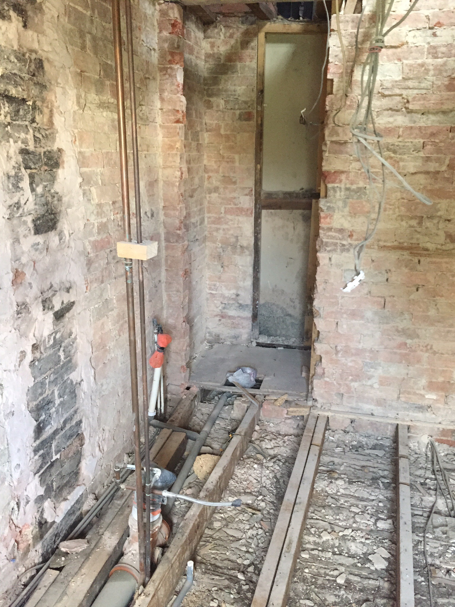

Thought I'd put up a thread with regards to a wetroom I'm fitting in my house. Had some great advice so far whilst in the build up to it which I appreciate.
So first day was Saturday just gone and the plan was to strip out as much as possible. I'm also refurbishing the 2 rooms and landing on the first floor but will concentrate on just the wetroom in this thread.
I still need to remove the existing ceiling, floor and the tiled shower cubicle but this will have to wait till either this Sunday or the following weekend.
Once the shower cubicle is out I'll be having a good look at that wall as a few of the bricks look in bad shape so would like that sorted before affixing hardie boards. The partition wall with the pipes in currently is going to be replaced for a deeper variant which will house the concealed cistern.
Is there anything other then a wire brush I could use to clean up the exposed brickwork? And would it be wise to prime this with something prior to affixing hardie boards?

Well this weekend has passed and I managed to get some work down on my wetroom on the Sunday (unfortunately had to work the Saturday).
So by end of play Sunday I got the tiles and shower tray out and also pulled down the ceiling. I'm also ripping out the 2 other rooms and the landing but will concentrate on just the wetroom in this thread.
This weekend (and all now till end of Sept) I'll be working on the wetroom and other areas so am hoping to get more done per day.
Plan for this weekend in the wetroom is to rip up the floor, remove the loft insulation and remove the partition walls. I need to drain my immersion tank ready for removal as I decided this weekend to accelerate the purchase of a zip tap for my kitchen. The basin will now have hot water fed via a Zip ES3 water heater so by getting the Zip tap for the kitchen means I can get rid of the tank in the loft and some of the plumbing.
Fingers crossed the whole floor is ready for the week after when I can get on with installing stuff rather then removing!
