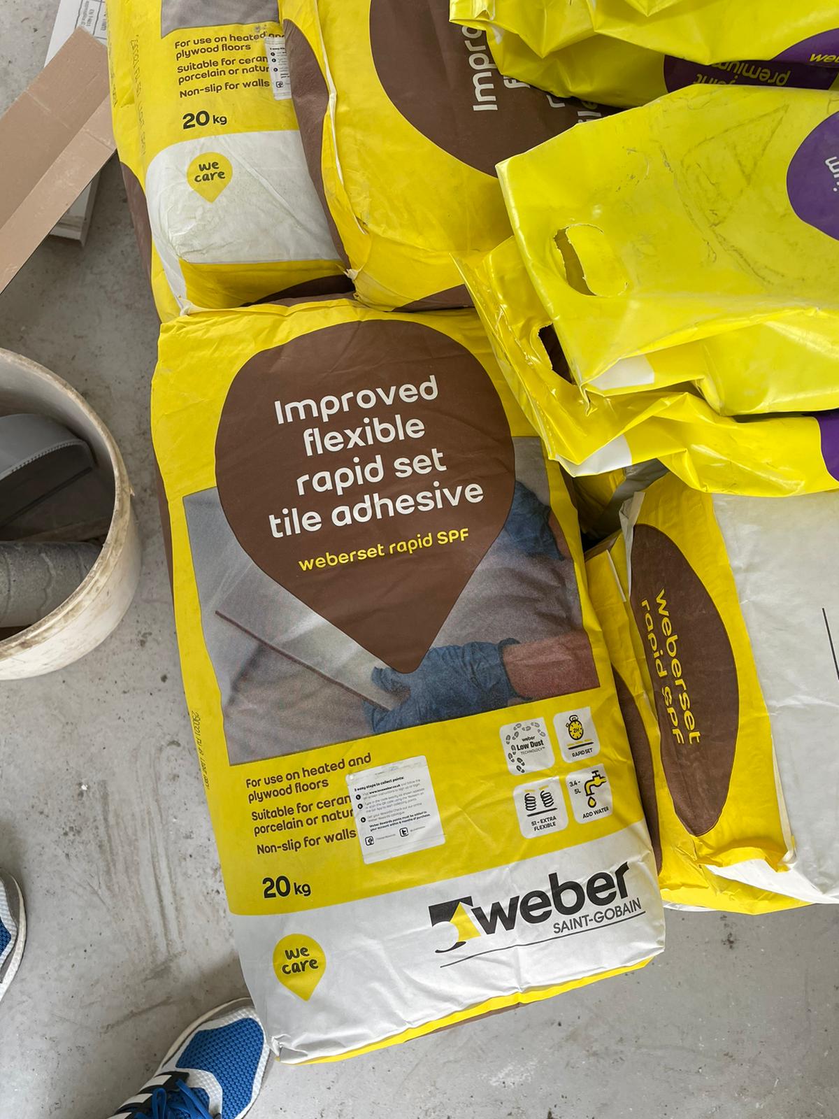

Ok thanks, it was sanded mechanically after a week of screed install , heat has been on a month or so ( which will be turned off come install time) it will be getting vacuumed, washed with clean water allowed to dry ,primed a couple of times .. control joints at doorways .Properly prepped cant see an issue. Prefer to see gypsum based addy used though.
