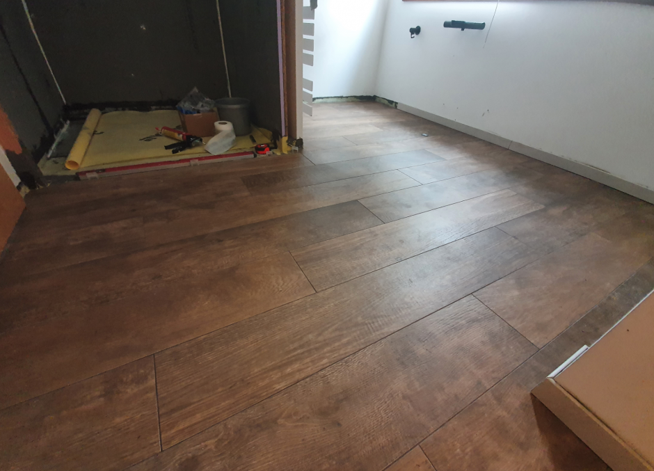

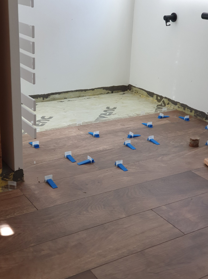

Oh I don't envy you there. Have you got any photos of your progress?
It's my first tiling job, so please be gentle!
This was the problem area...
which is now done :)
... and here are some photos taken earlier:
