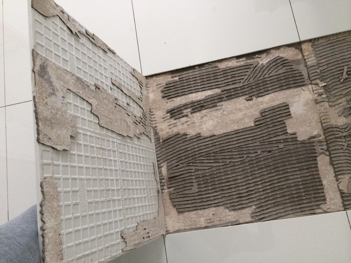

Hopefully this photo will help matters.

From the photo it looks like there is no bond between the adhesive and the screed and also very little bond between the tile and the adhesive. I'd say you've used an 8mm trowel and not backskimmed the tiles which hasn't given you a solid bed. Anhyfix is the best product to use IMO and yes, it is suitable for heated screeds. Have a read through the PDF on my previous link.
8mm yep - too little? :(
Not backskimmed - you're right. I've probably ballsed the whole thing :(
So the Keraquick is not to blame?
If i strip the whole area, prime, 10mm trowel, back skim tiles, you think i'll be solid for good?

I always start with a 10mm and backskim the tiles, if the floor is a bit up and down a 12mm may be necessary. You really need to remove the lot and start from scratch. Get the floor sanded and hoovered, prime, then tile with anhyfix. Don't forget to backskim the tiles to fill in the waffles and lift every other tile to ensure the ribs in the adhesive have collapsed and you have a solid bed.
