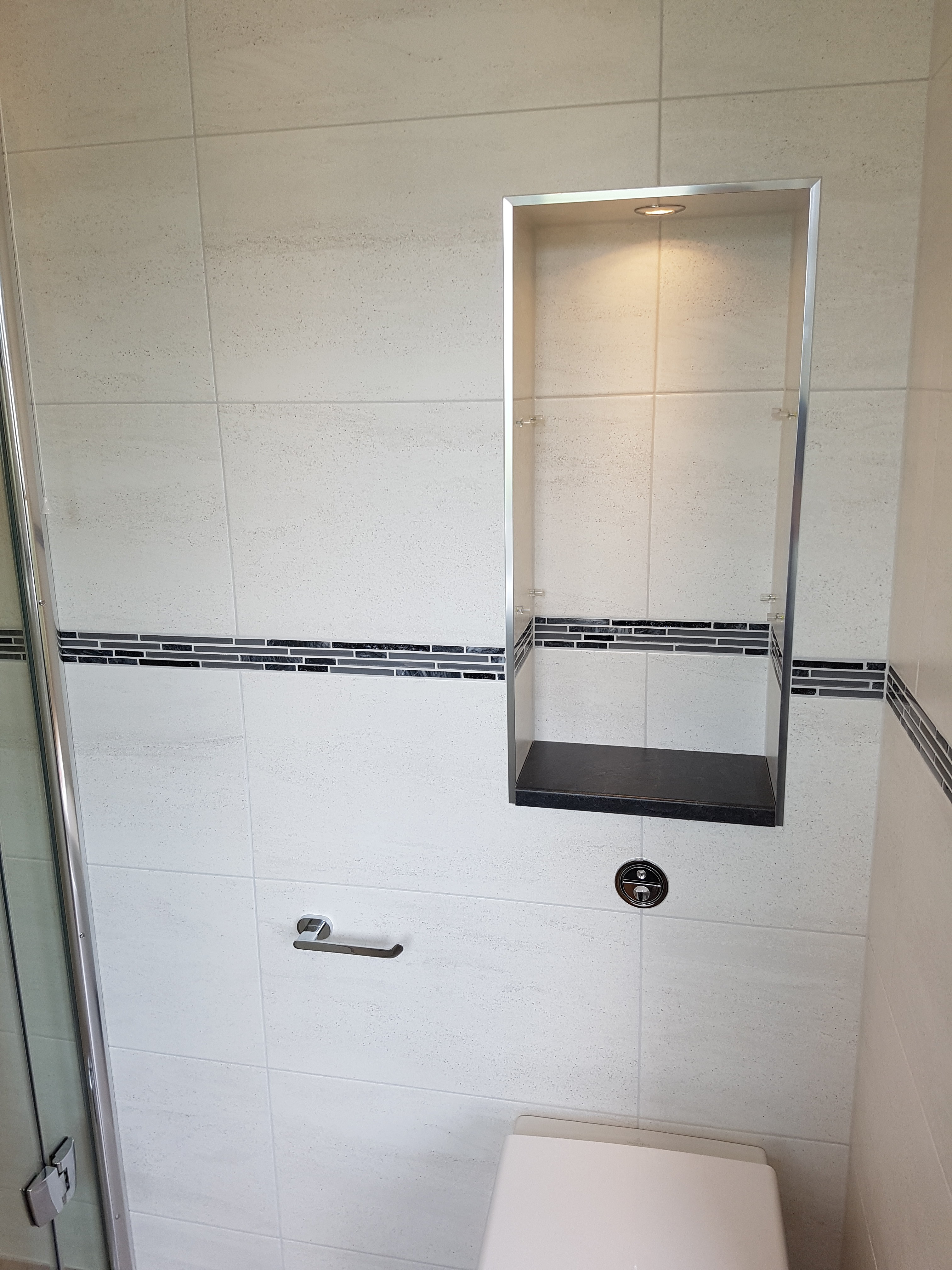

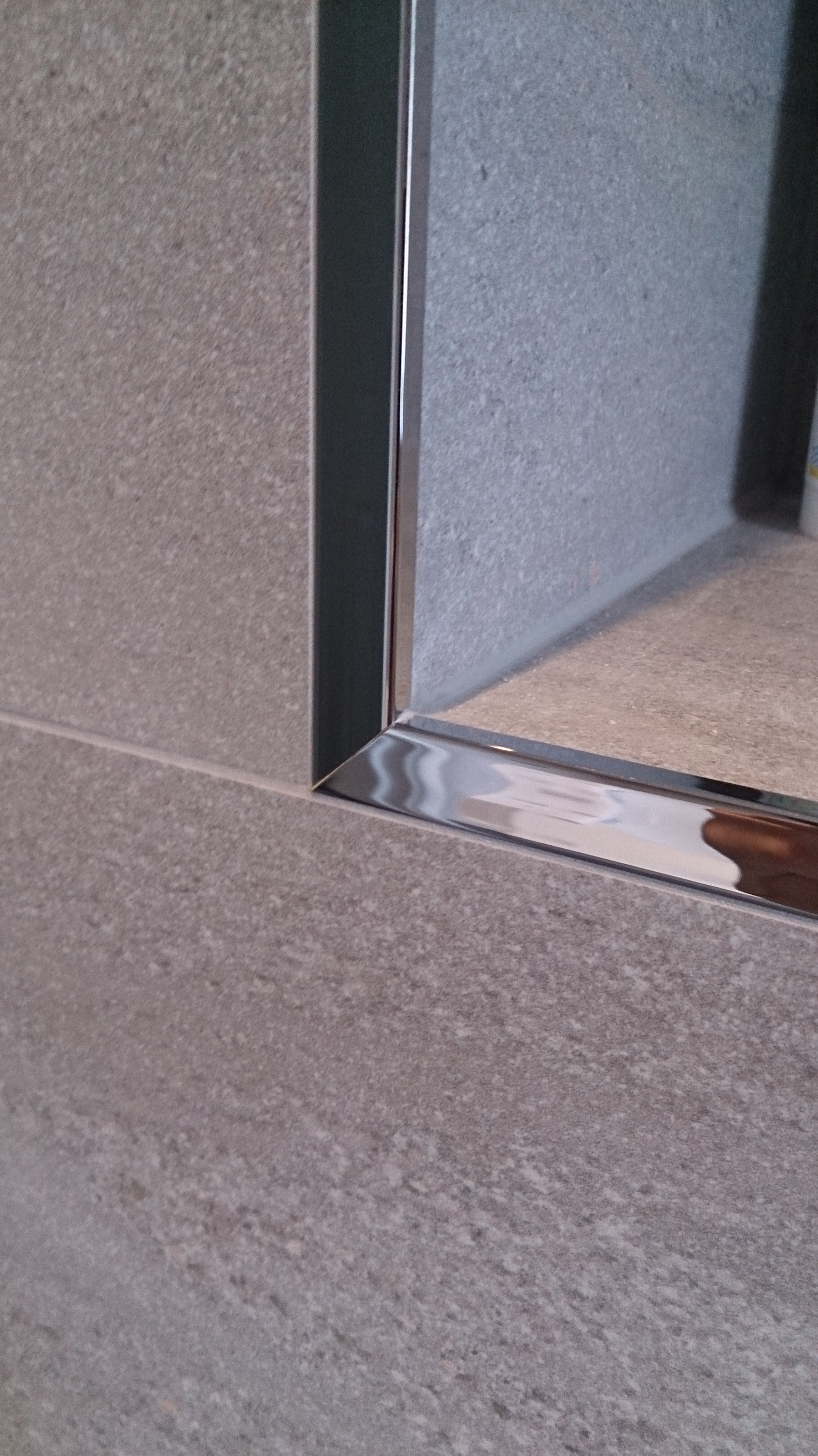

Here is a Porcelanosa ceramic tile cut neatly around a niche. With the correct tools, technique and experience it is easily achievable. No excuses IMO

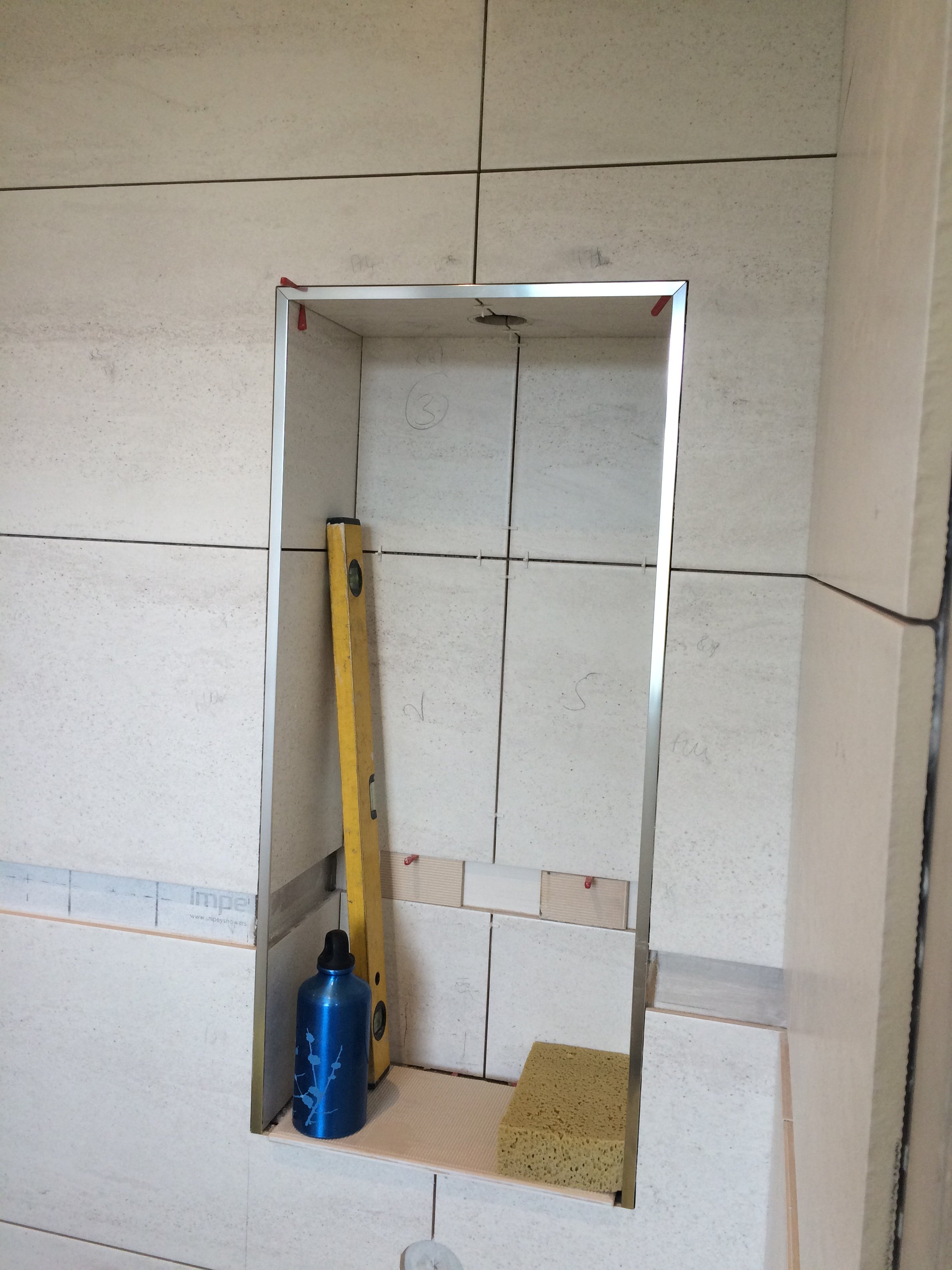

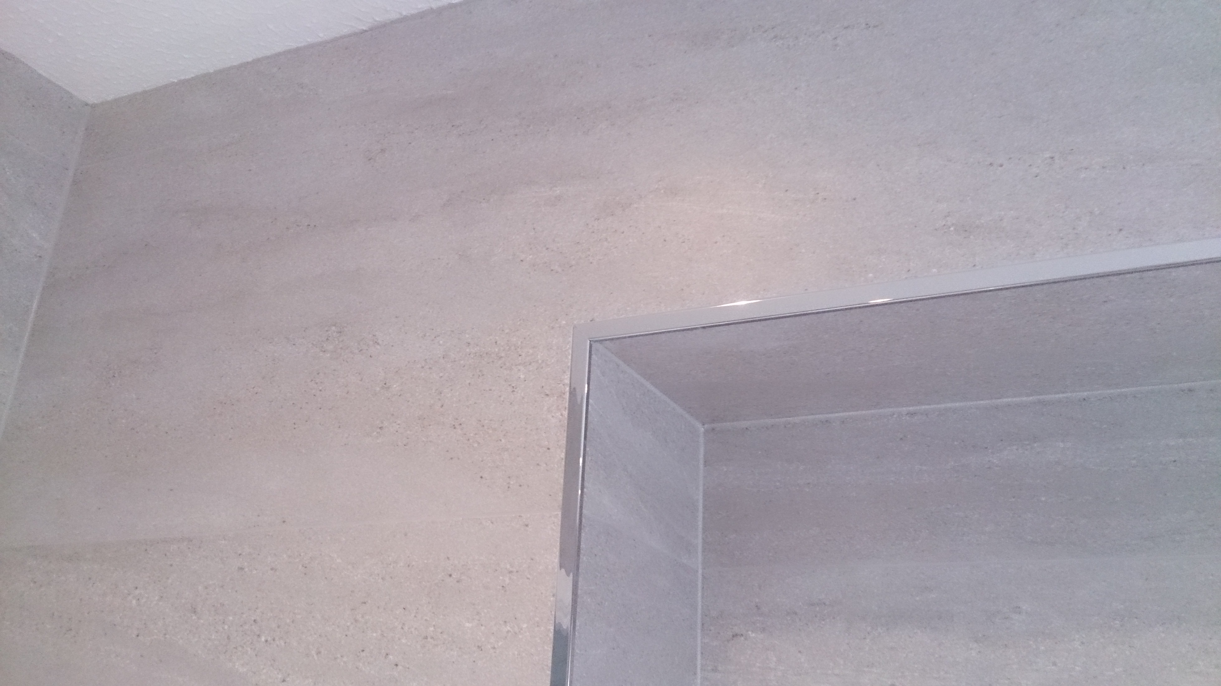

That looks fantastic. It's off topic and I will probably never do it but how did your get the tiles to stick on the ceiling of the niche? A high inital grab tile adhesive mixed quite thick or normal mix with a block of wood under it to support it.
Geoff - Why did you mitre the tops of the trims but not the bottoms?

Is that the porcelanosa 11mm £60 a pop trims. Once did a bathroom with 12 of them cost a bomb.
