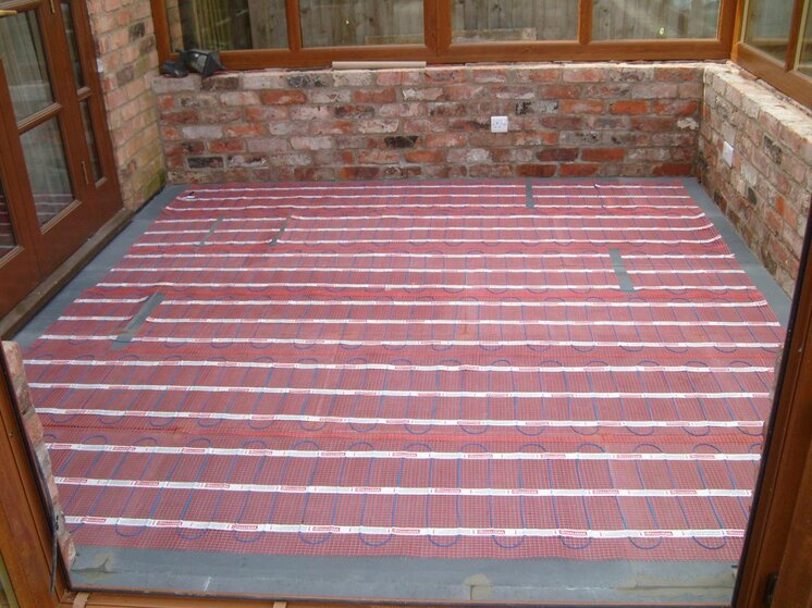

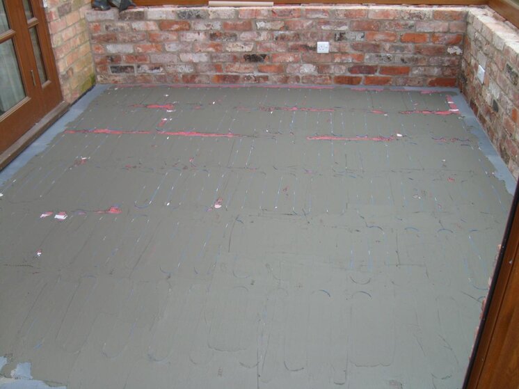

Cool post..Why do you need to apply the self levelling over the tile adhesive screed?
Q
Qwerty
Apart from making a level surface to tile onto, it also protects the cable when troweling the adhesive as well as fully encapsulating it to ensure no air pockets and an even transference of heat to the tiled surface.

I happened to of quoted for a UFH install last week and was asked the same question about the SLC. Another thing I mention is if you ever have to break out and replace a broken tile. Less risk of damaging the wire if it's in SLC and not burried in the adhesive.

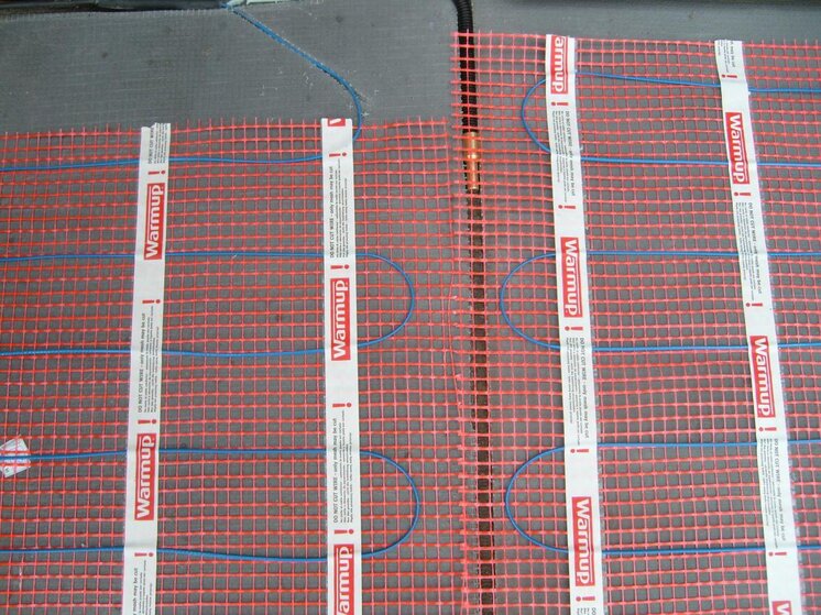

Was wondering why you don't just pour over the mats in one pour instead of thin set first? Seems to cut out one more steep and the tape on the Warmup mats will hold very well to the primed surface of the boards.
Ian
I find there's always a bit of cable that floats. I've tried both ways and putting a layer of adhesive down before SLC gives a better finish and also takes away the risk of snagging a cable when SLCing.
