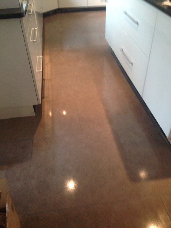

Matt, I admire your patience. As has been said already, your builder has done a shockingly bad job, the worst I have seen. You also seem to know what needs to be done, a total rip-out ( at the builders expense). You have paid to have your floor tiled correctly, and that's what you should expect. His remedial works are getting more and more bizarre, and will never cure the huge problems that are clearly evident with your floor

As promised some pics - so embarrassed, no-one's tidied up!
First is the dot and dab and UFH cable for everyone's entertainment. Next two are really just cardboard over where the tiles are up. Just shows the extent of the job really - it's a 5m x 5m square with a passageway of one end. 4th is what I'm worried about with end panels which probably have stone stuck to them 5th is the end of the island. Last is showing a tile space with all but the corner dots lifted off the cable and insulation. The genius idea is tile adhesive in the larger space between the corner dots, ridged a bit then Gripfill on the dots. Adjacent tiles not lifted to have foam injected under then as much adhesive pushed under the edge as possible. You probably gathered I'm not crazy about this idea.

I haven't studied them or read your post properly but just in case you're about still I wanted to quickly ask for a picture or two under the plinths.

All depending on your budget, and wether your builder would pay for it , if it was me I'd try and keep the kitchen in, every bloke on here has tiled a floor a with kitchen in , it is doable and certainally not a bodge job as long as its prepped right.
not the best pics but this was tiled with the island and kitchen in, granite work tops ect, and these were 1200x600 🙂
Thanks Dan
Won't be until tonight but could pulls plinth off and get a picture

Another vote for s redo
not the best pics but this was tiled with the island and kitchen in, granite work tops ect, and these were 1200x600 🙂View attachment 73128View attachment 73129
I'm sure it's possible and less upheaval

He's admitted its been a **** up - sort of had to when the tiles started knocking. Staying a bit quiet on bare UFH cable.
A request to get it all up with kitchen out if needed will go down badly but I think he'll start to realise he's not really in a position to have an opinion. His options will be to comply, get another opinion (and then comply), or walk away in which case he'll need chasing.
Hasn't got a leg to stand on if he disputes the request. The adhesive used doesn't stick to porcelain. The stuff he thought he used says on the bag (I'm stood next to it) that floor tiles must be laid on a solid bed. The UHF instructions say level with SLC then solid bed. Any how to do it DIY website or a leaflet from B+Q tells you what's wrong here.Then there's all the opinions posted here.
