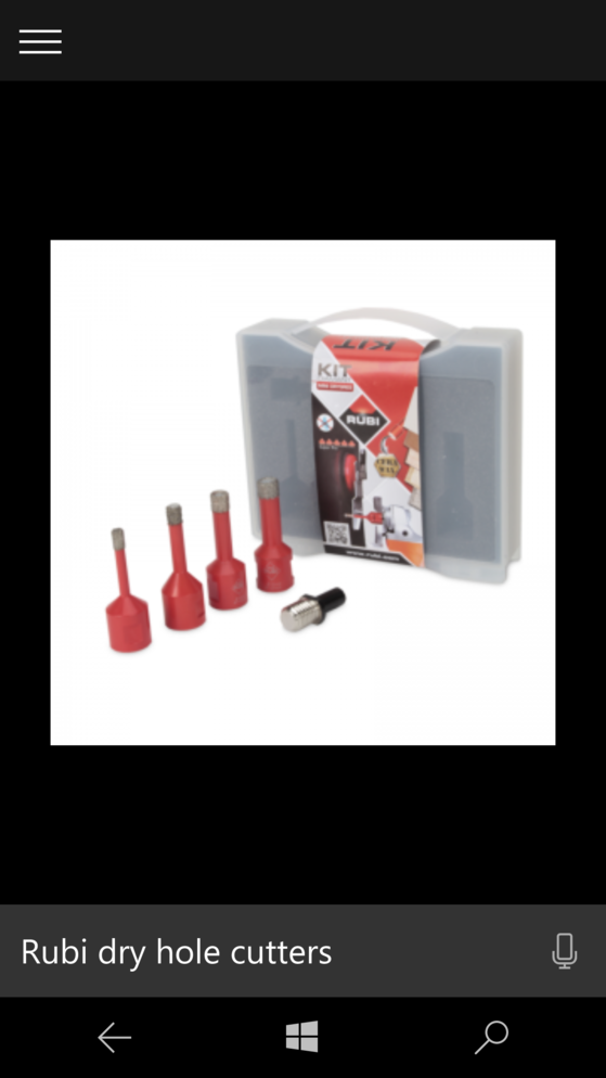

That Rubi grinder kit is about £230.
How many and what size bits does that include?
Can imagine that what sometimes takes 5 - 10 mins would take 5 - 10 secs!
Rubi kit Julian posted is about £50 I think.
6,8,10,12mm something like that.
I use the M14 dry bits too, excellent kit used correctly.
