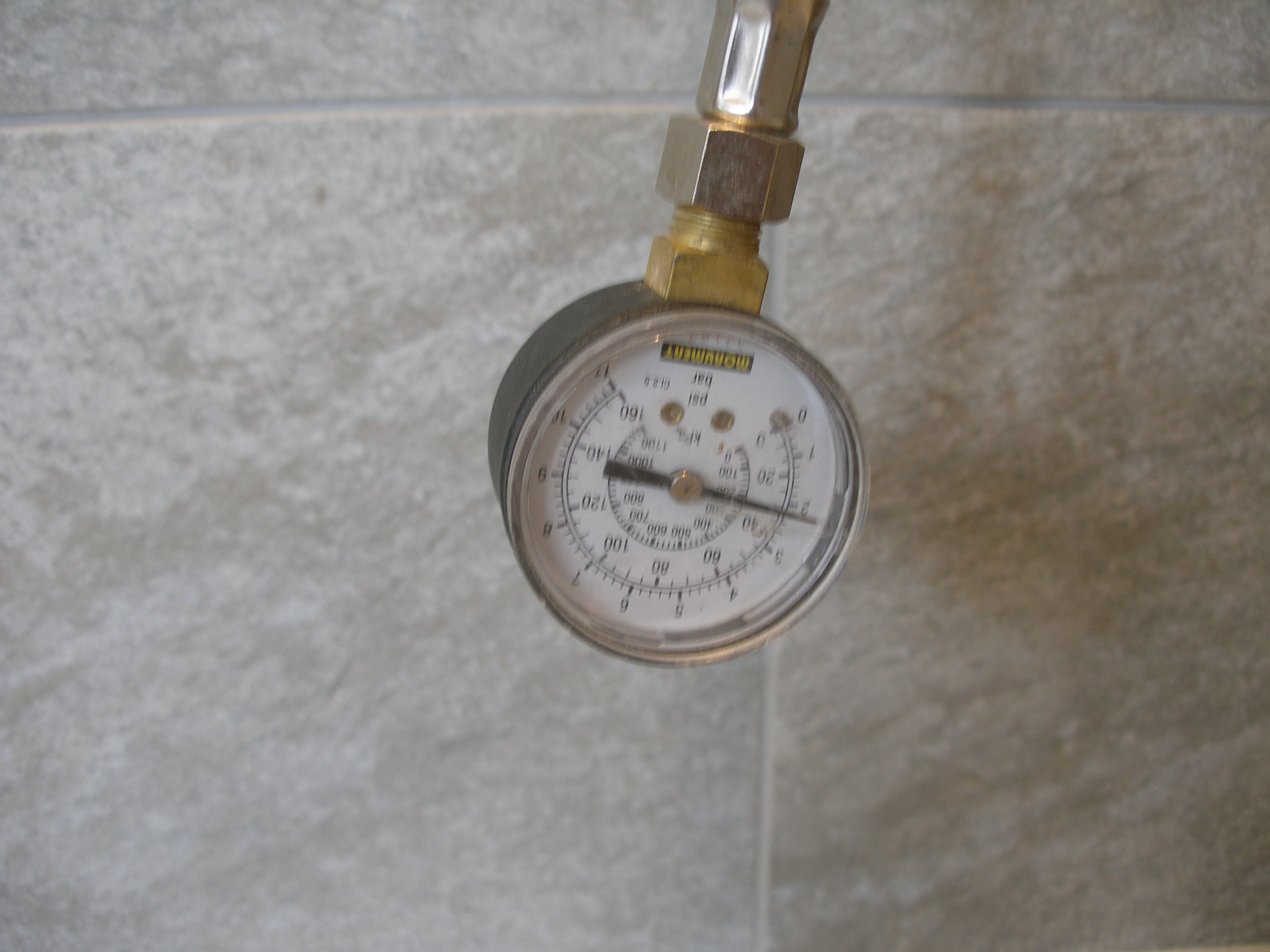

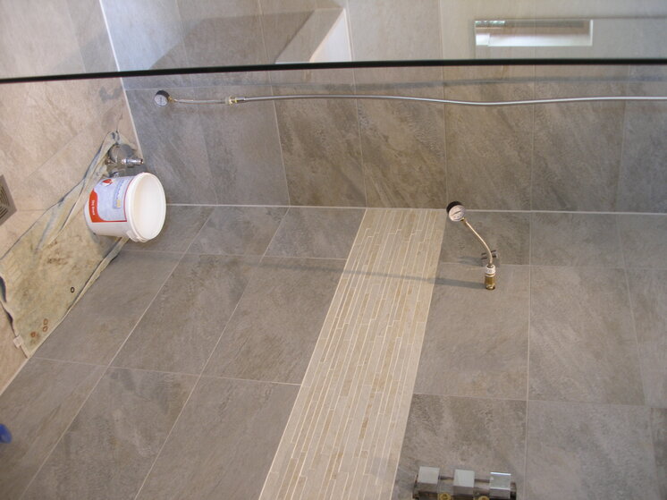

Anyway, was just going to update you as the plumber came today (at last!). It was the first time he had been back since installing the bathroom and was quite surprised at the extent of the damp patches on the grout. He pressure tested the two outlets (see the picture attached) at 2 bars and there was no drop in pressure over half an hour or so. He seemed to mend the drip in the elbow of the hand-held shower by putting some more tape on, but thought this had been unlikely to be the cause of the problem as we hardly ever use the hand-held shower. When he dismantled the valve there was no sign of leaking behind it.
So....not sure where that leaves us now! He wondered if there was still a pool of water under the shower tray tiles dating back to pre-epoxy, and that since applying epoxy grout, this dampness can only escape by travelling to the areas outside the shower tray which still have normal grout. I suppose that it is possible that this drying out is not an even process, and that maybe some days there is more evaporation than others, which we mistook to be leaks from the pipework, but could be unconnected?
He thought the only way to test this was to turn up the underfloor heating (which is all over the floor apart from in the shower tray) and try and completely dry the damp patches. Then to start using the shower again and see if it comes back. If it does, we know it's not coming from the pipework, but getting through the shower tray somehow. I wonder if it is getting in around the drain, as the tiles have been cut very tight to the drain here, so there is not much grout in the gap?
In any case, if it is getting through the grout it should not be pooling under the tiles, should it? The tiler thought he had fixed this problem by pouring more adhesive down the gaps when he removed the old grout, but perhaps this didn't work?
So that's how we left it. I'd be interested if anyone disagrees with this logic, or has any other suggestions on how to proceed? It seems we have ruled out plumbing problems!

Yes, there is tanking all over the floor, which goes straight into the drain. I am just thinking that if somehow water is getting under the tiles around the drain (but on top of the tanking) then it could somehow get wicked away into the rest of the floor (although it would have to go up a slope!). Obviously any leak from the drain would be below the tanking and would appear on the ceiling below.
So surely it must be a tiling problem?
I can't really see how it is as the water must be coming from something to do with the water inlet or water outlet. As we've ruled out condensation and whatnot.
The tanking is doing the job, and as you say the drain isn't leaking below the tanking. Water won't climb uphill even in a warm room. So I can't see how it's evaporating up to the grout in the rest of the floor personally.
I'm still on the leak side of the fence so am assuming it's plumbing.
The tiles and grout aren't the cause of the water though that's for sure. I just don't see how that can be the case.

I was looking at his pressure test , the way your plumber has had that rigged up its only testing the two outlets unless hes done the test from the main stopcock and not the actual shower valve , by using the main your actually testing the whole house but its the only way to test the actual shower valve unless youve access to the pipework,
