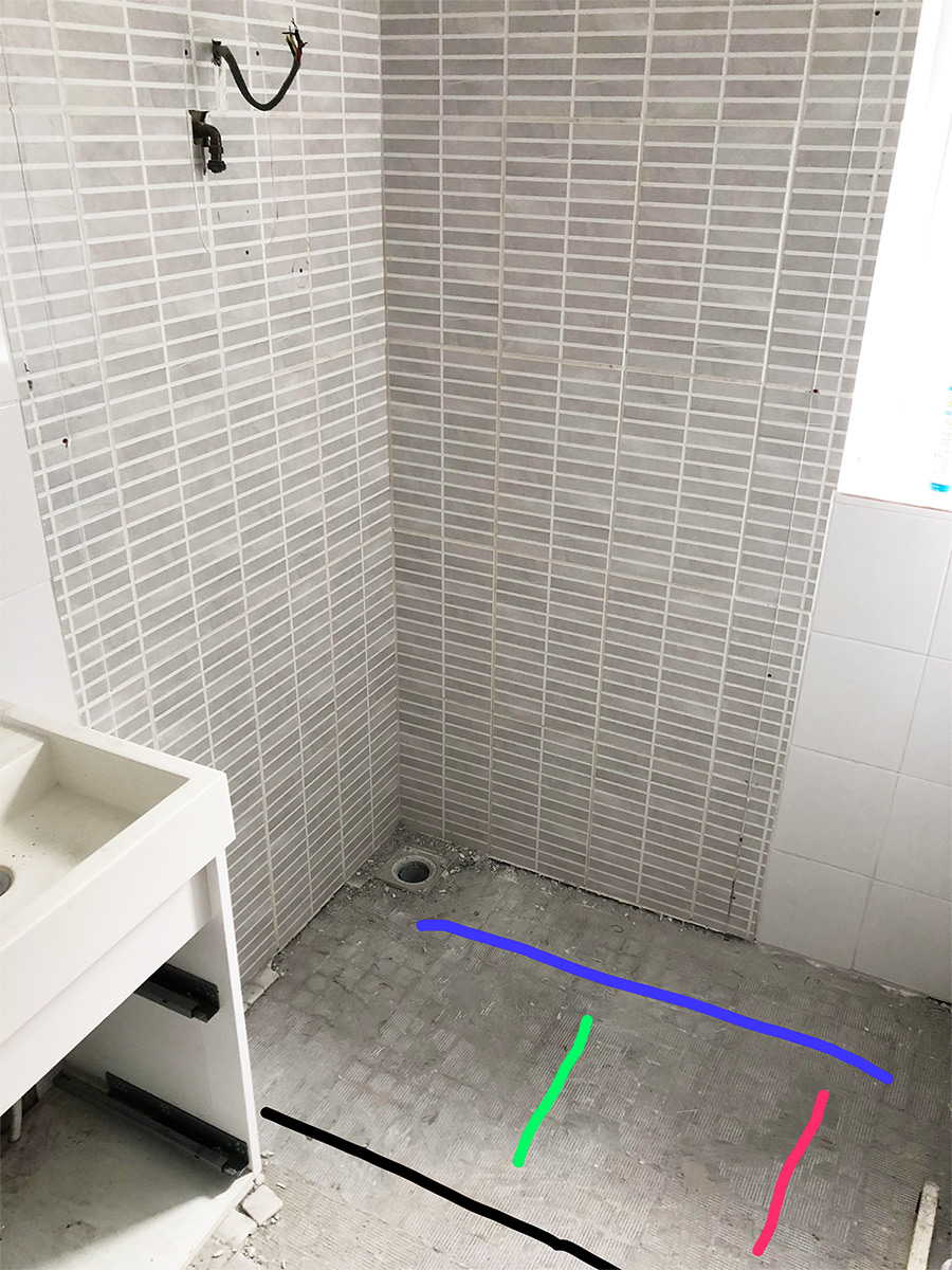

I've attached a picture of the room, before I stripped the wall tiles off. As you can see there is a drain in the corner, and the floor slops towards it - along the blue line towards the drain, and along the green line towards the wall (it levels out a bit horizontally at the red line). The black line is where I'll be running a sliding shower screen.
Can the walls be tanked to 'fall' into that drain? Or do I need a new unit?
Please excuse my ignorance but when you say they do need tanking, does that mean boards or is painting it with the polymer based paint enough? I'd like to understand more why the taping is necessary as in my mind the waterpoofing tanking paint would protect the walls and cement floor, and the cement wont get damaged anyway from water.
