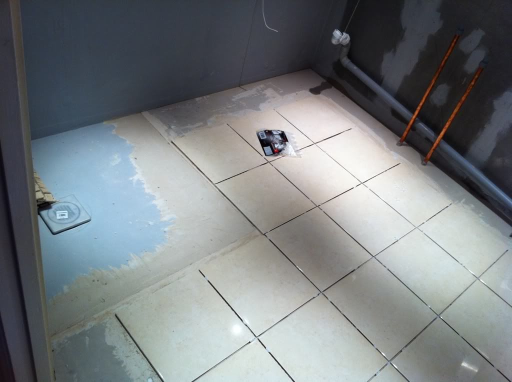

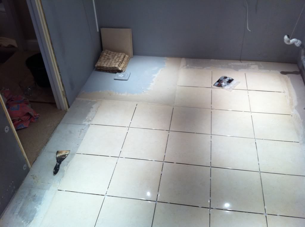

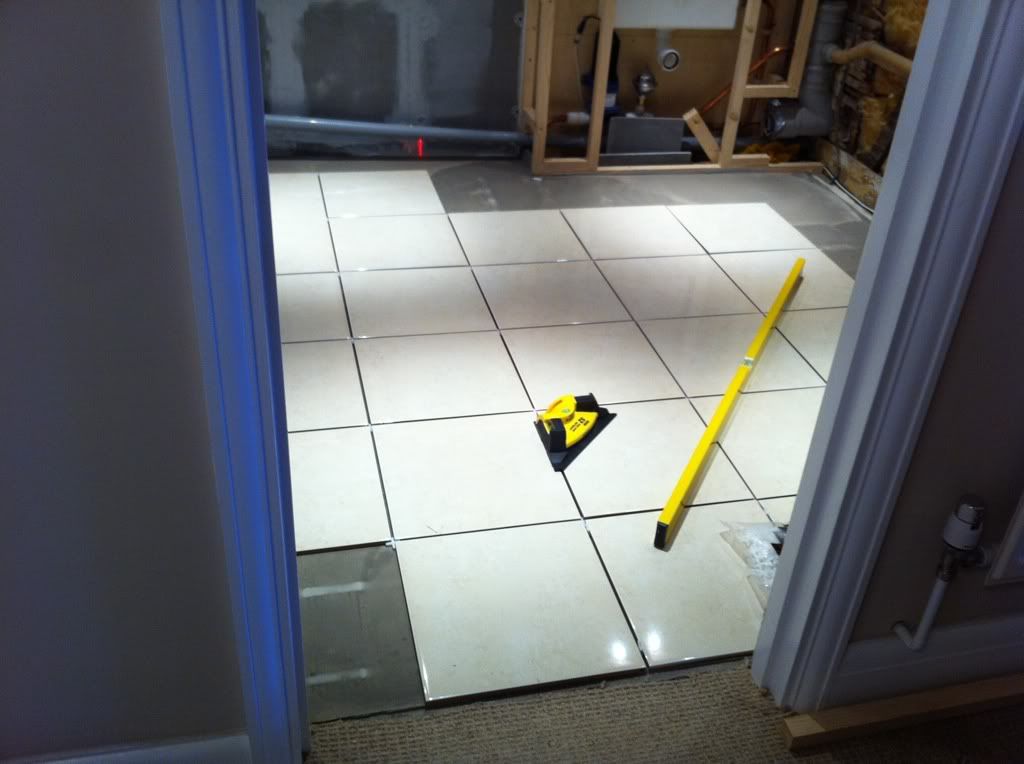

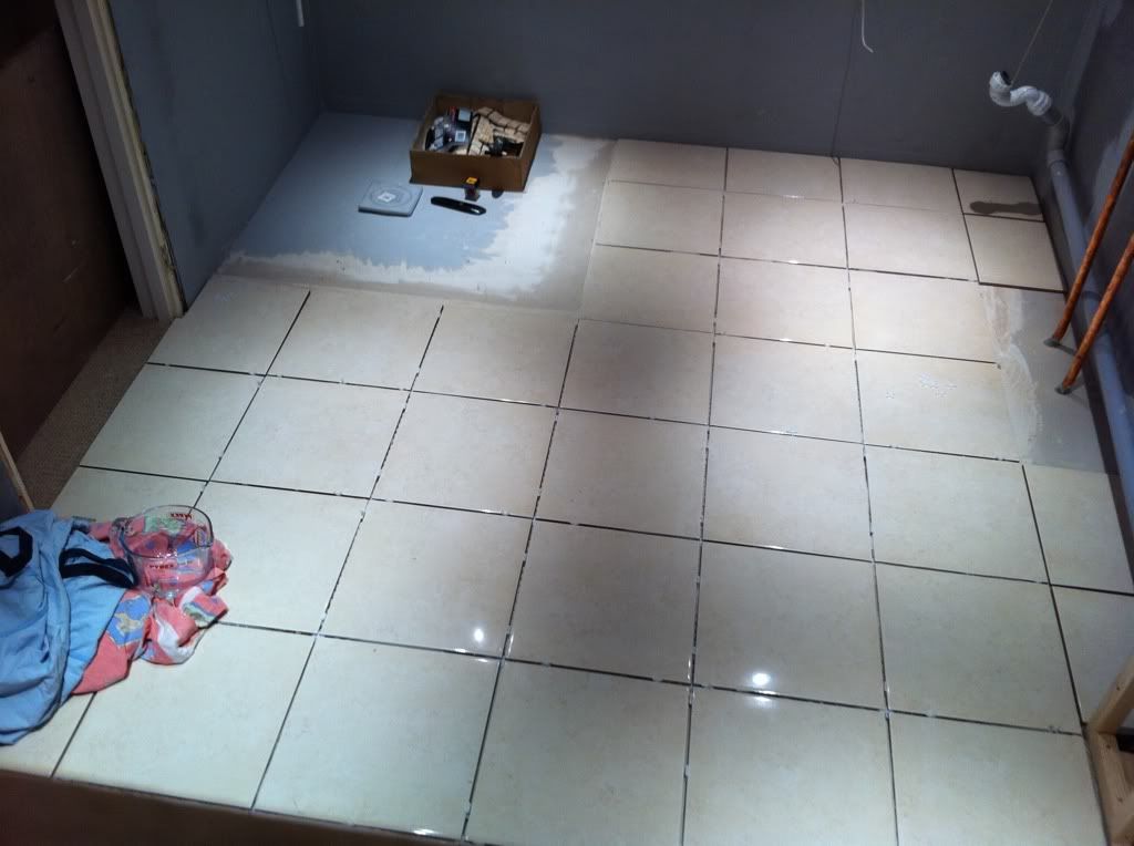

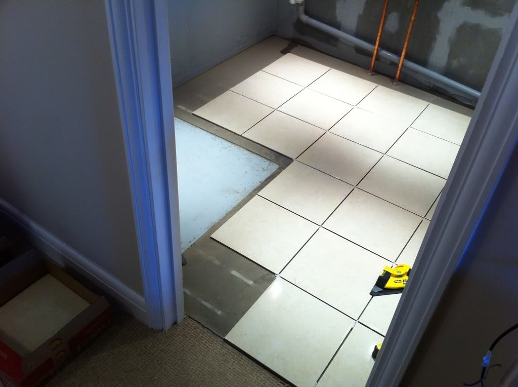

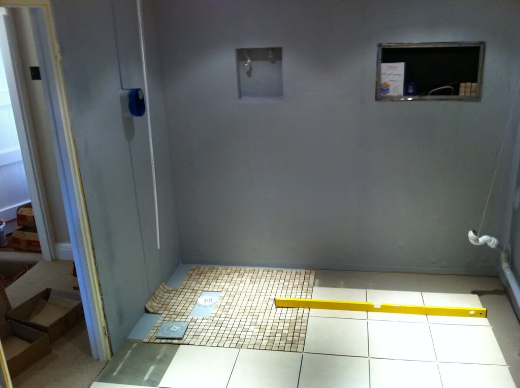

Layed some tiles...
Only joking.. just setting out, being a bit curious.
All seems ok from what I can see... anyone see any pitfalls? I set out from the doorway. First thing you see I guess.. made sense

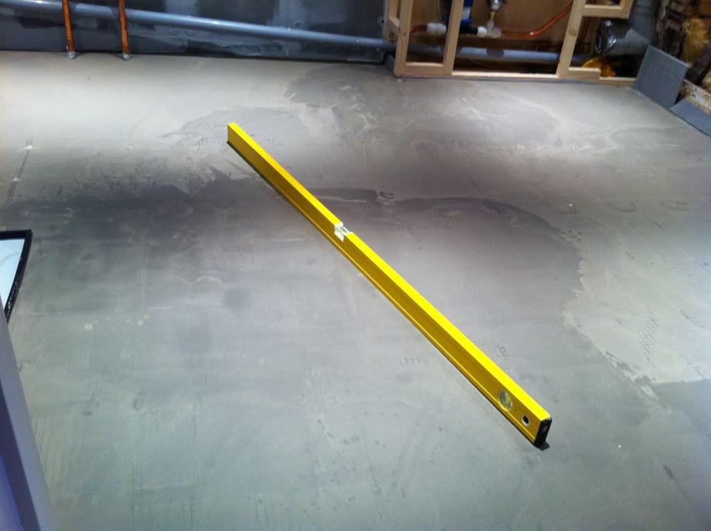

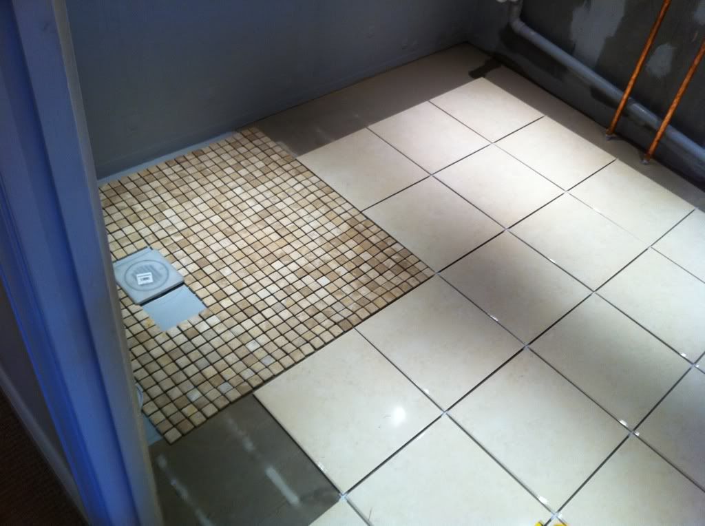

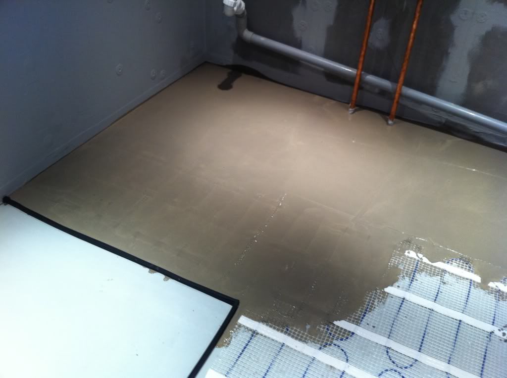

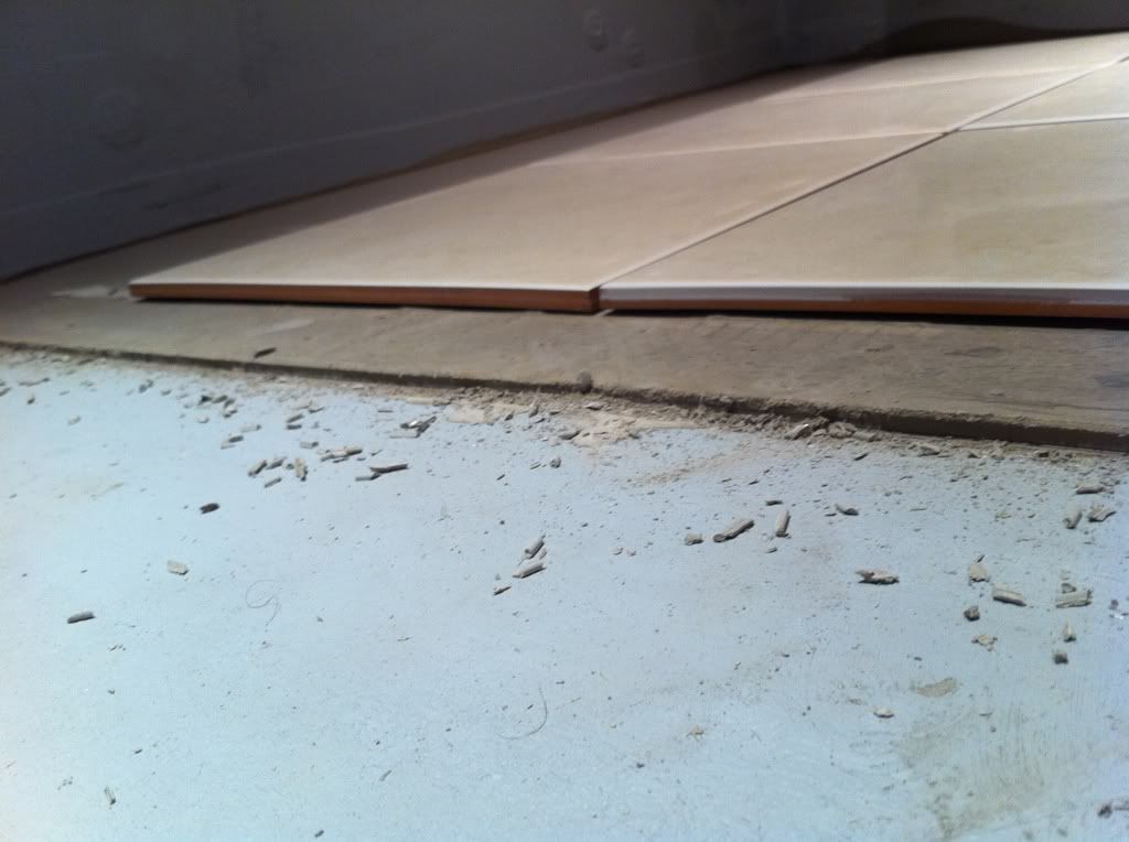

I do have one question right now.... Now the SLC is down, I have a 5mm or so step down to the shower tray.
Would I be ok to use some tile adhesive to smooth from the SLC surface down to the shower tray? kind of like a gradual slope? I dont mind the slope, could be worse, the tray could be higher! :lol:
Im using mosaics for the tray so they should follow the slope ok...?

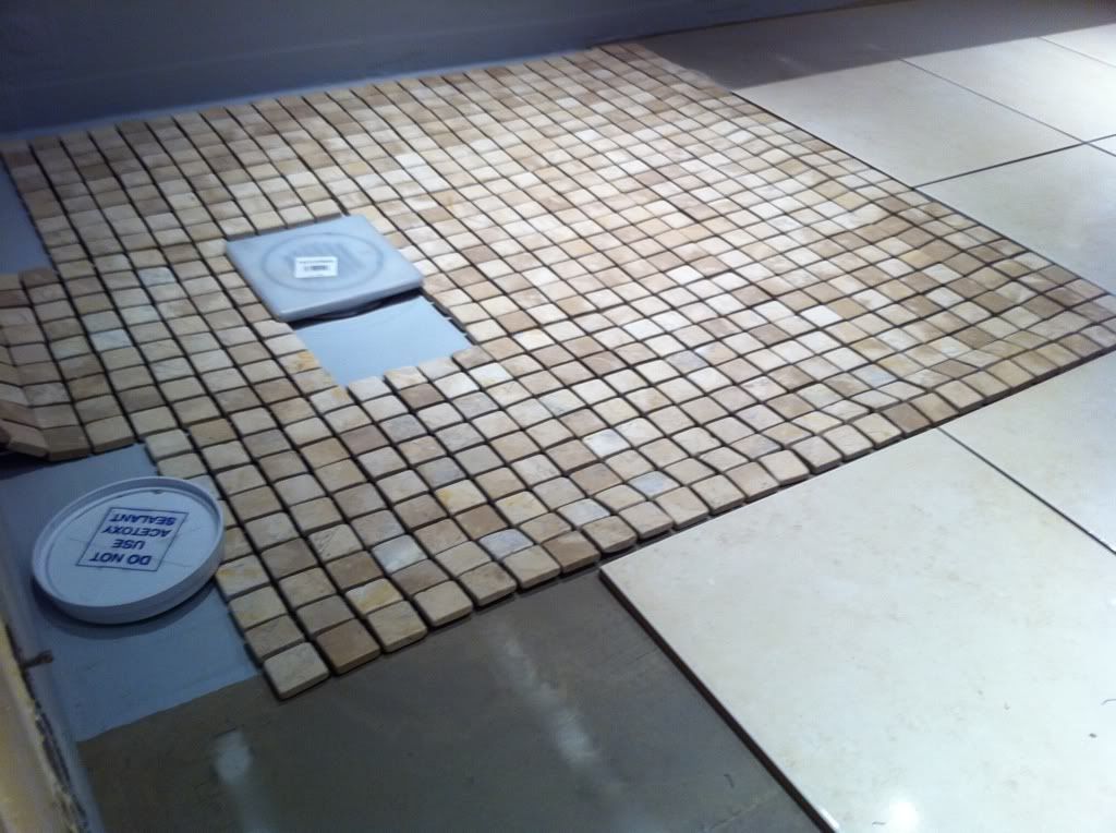

Whats the best way to cut mosaics? has anyone done it with a big clinker (hate that name!)
Should I cut by the drain? or should I cut where the mosaic meets the floor tiles?
Looking good mate :thumbsup:
I would personally cut where it meets the floor tiles. Is there any way of keeping full tiles at both areas? Do what is right for the wet area, then work out from there. It is the feature area of the floor after all. It looks pretty good to me though, may need the floor tiles shifting a few mm here or there to get the required look of no cuts in the mosaics.....hope that all made sense :lol:
Perfect sense mate, Thank you :thumbsup: I think I will cut the tiles down on the doorway row, this will enable me to bring a full tile to the mosaic where the screen will end.
Feather the edge of shower tray with adhesive and allow to set....
Created on iPhone.....
Just going back to this point... can I use tubbed adhesive to make this feathered join?
Not that im being stingy as I have 6 blimin bags of keraflex maxi... but rather than open a bag and mix a small lot... I do have a tub of mapegrip that I used for the kitchen.... still some left so would be great if I could use that?
No Dave, use the keraflex.

i would have laid the row opposite the door in one go, laying the drilled/cut ones at the same time, this would ensure all the tiles match up height wise. i always work in an 'L' shape not a 'U' shape. it will probably be okay if the floors flat. looking good so far btw mate :thumbsup:
