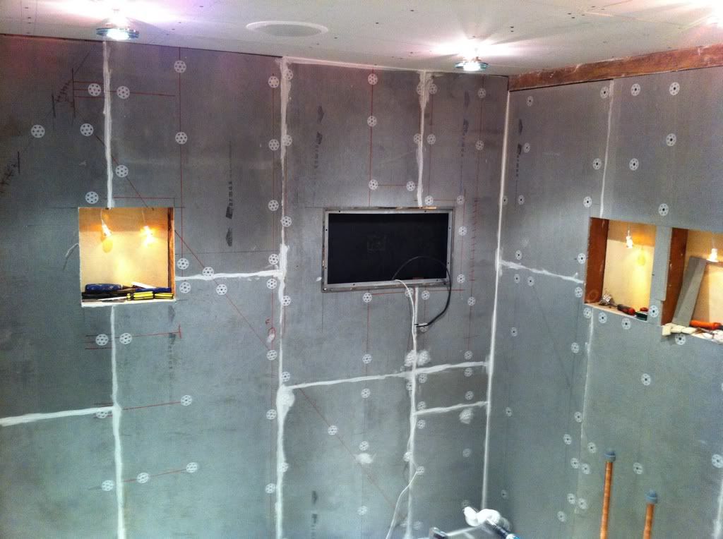

BLOODY NICHES! laser level is a god send
note the new stud additions, may aswell have built a new frame ! well they do say its all in the prep!
wall done!

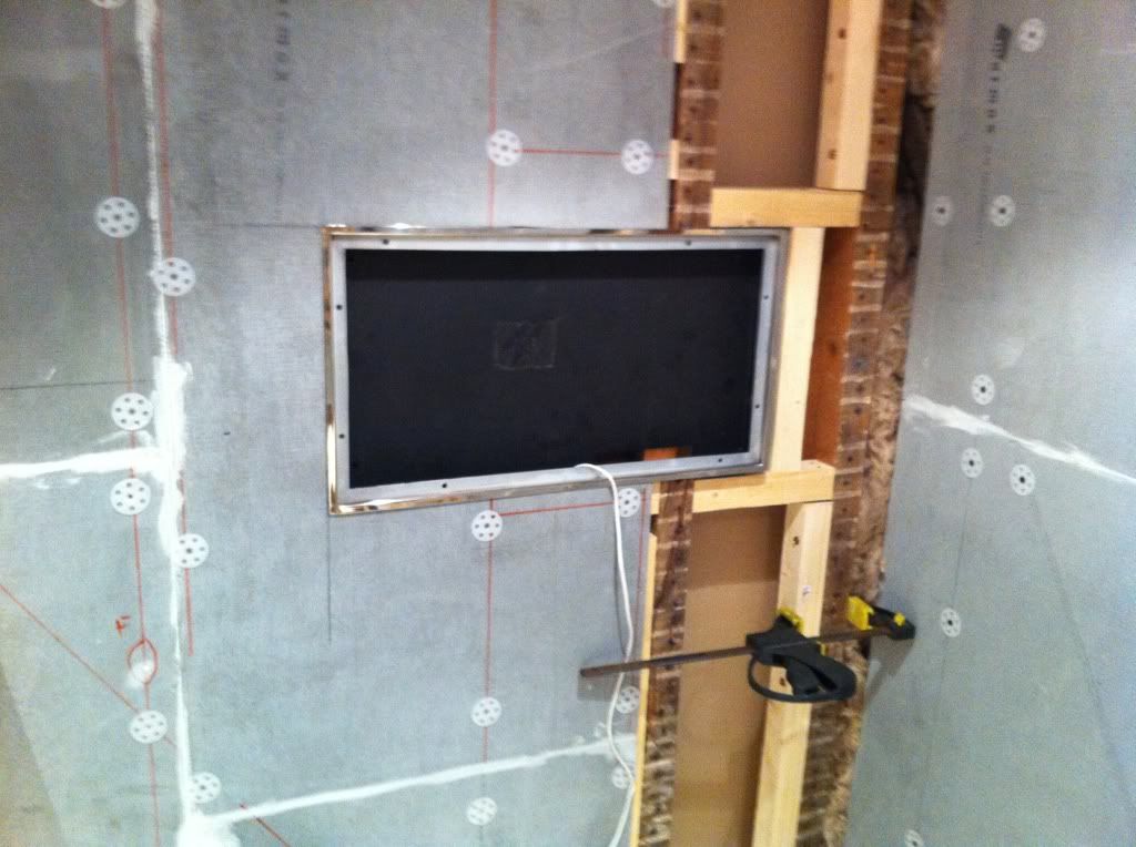

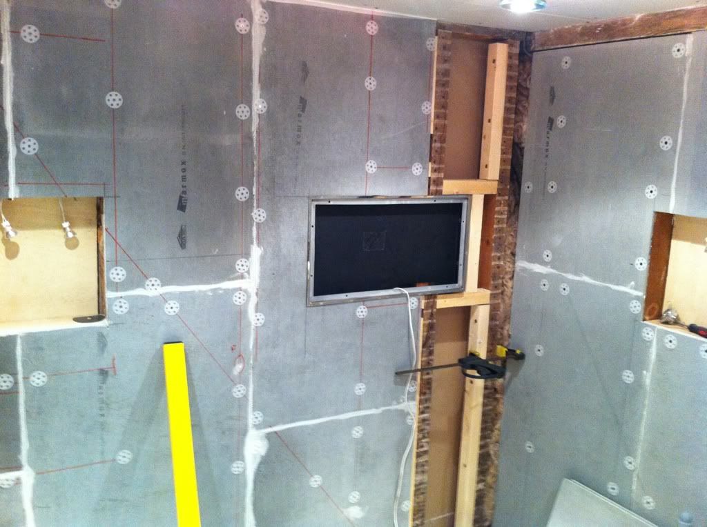

That's just a spare mounting box, I'm still waiting for the tv to arrive but I've already routed and fed a twin sky cable so I can terminate it with an rf fitting that goes to a sky hd box in the room above the bathroom. Then there is a feed cable that goes to the next room where the power brick will be plugged in. That should be all that I need. The tv when connected to the sky hd rf2 output gives me all our sky channels and lets me control the sky box a la magic eye With the supplied waterproof remote control
Theoretically it's an ideal set up....! Don't quote me though!
Sounds good :thumbsup: What TV is it.....is it a mirror TV? Ive seen a few of these recently and they really are good.
The missus is surprisingly on board about the TV! It will be a sovos one. This video actually sold it to me.. cant really get much more waterproof than this I guess...
19" Waterproof TV Submersion Test SOVOS SVBTV19 - YouTube
Bit of a wait for it though, but the suppliers sent me a back box so I could get the walls/tiles up which I thought was cool of them.

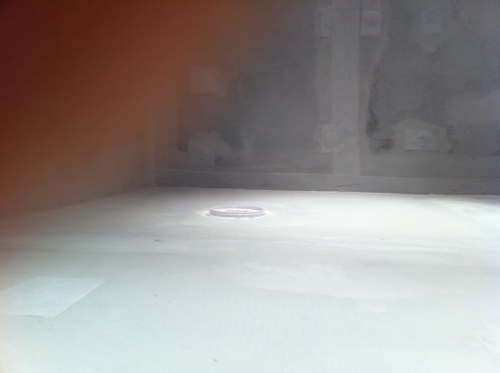

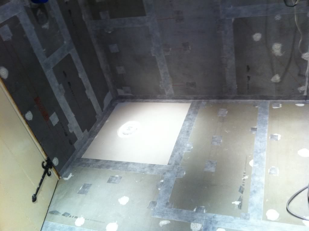

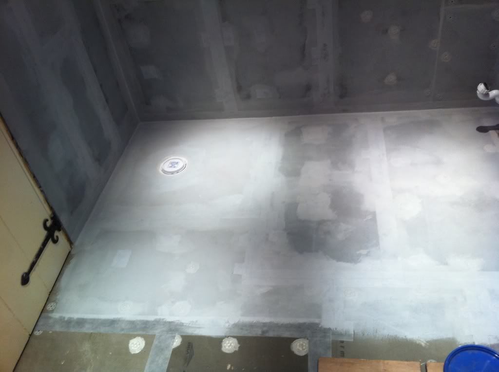

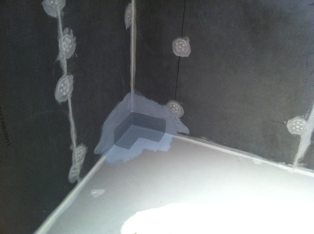

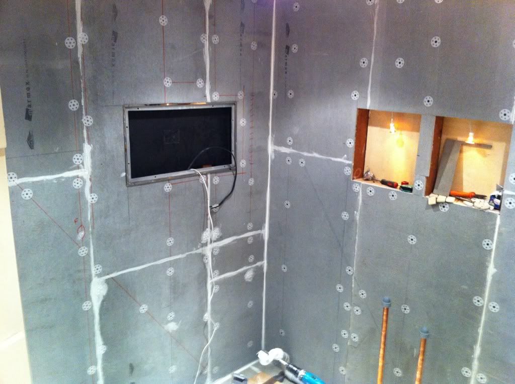

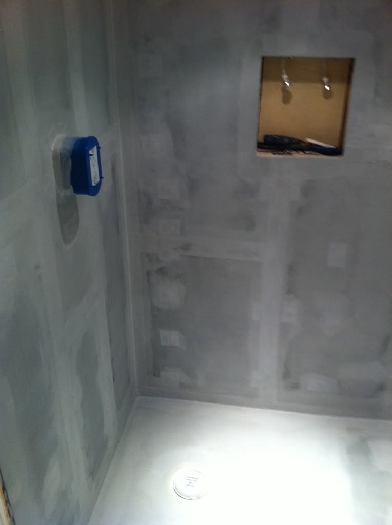

WELL, today I have been sealing, taping and tanking. Horrible job.. especially when you run out of tape. 30 metres not enough!? So had to run down to Marmox AGAIN!
Tomorrow i'll do the second coat... tell you what.. this mapegum is THICK. doesnt seem to go very far either. NEarly done a 5kg tub for what you can see below.
Ohh I ordered a load of tools/goodies from tradetiler and kwikstick (or something similar) so tiling wont be long!
Im knackered, time for a steak and vodka tonight!
Out of interest Dave, why have you tanked over the Marmox board faces with Mapegum? I always seal joints, then tape & Mapegum for piece of mind, but tanking an already waterproof tanking board could prove to be very time consuming & costly
Just for peace of mind mate. I'm paying attention to the tape and taped over screws/washers really. But I have the mapegum so may aswell use it
