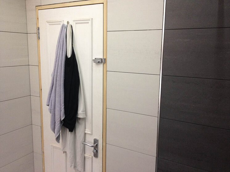

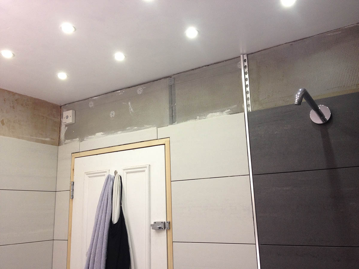

Further progress and a quick question please.

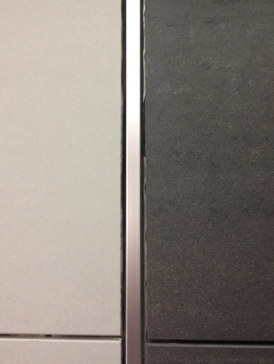

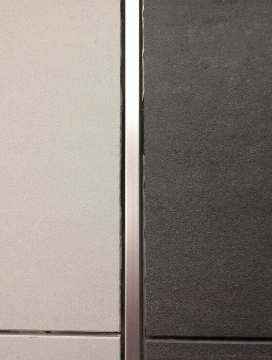

I've bridged the join between the two colours (shower screen going across on one wall) and was just debating whether to grout or Silicon the joins. The metal trim is a little below the tiles (measured the tiles, but didn't allow for the 'ribbing' on the reverse).
I'm getting BAL grout and the matching Silicon, so will have both. I will tape one side and do the other. I am thinking it might be slightly easier to go Silicon as I'll be trying to meet a snapped edge. Would welcome any thoughts.
Cheers.
Graham
Any thoughts re the grout/Silicon question either side of the trim?
