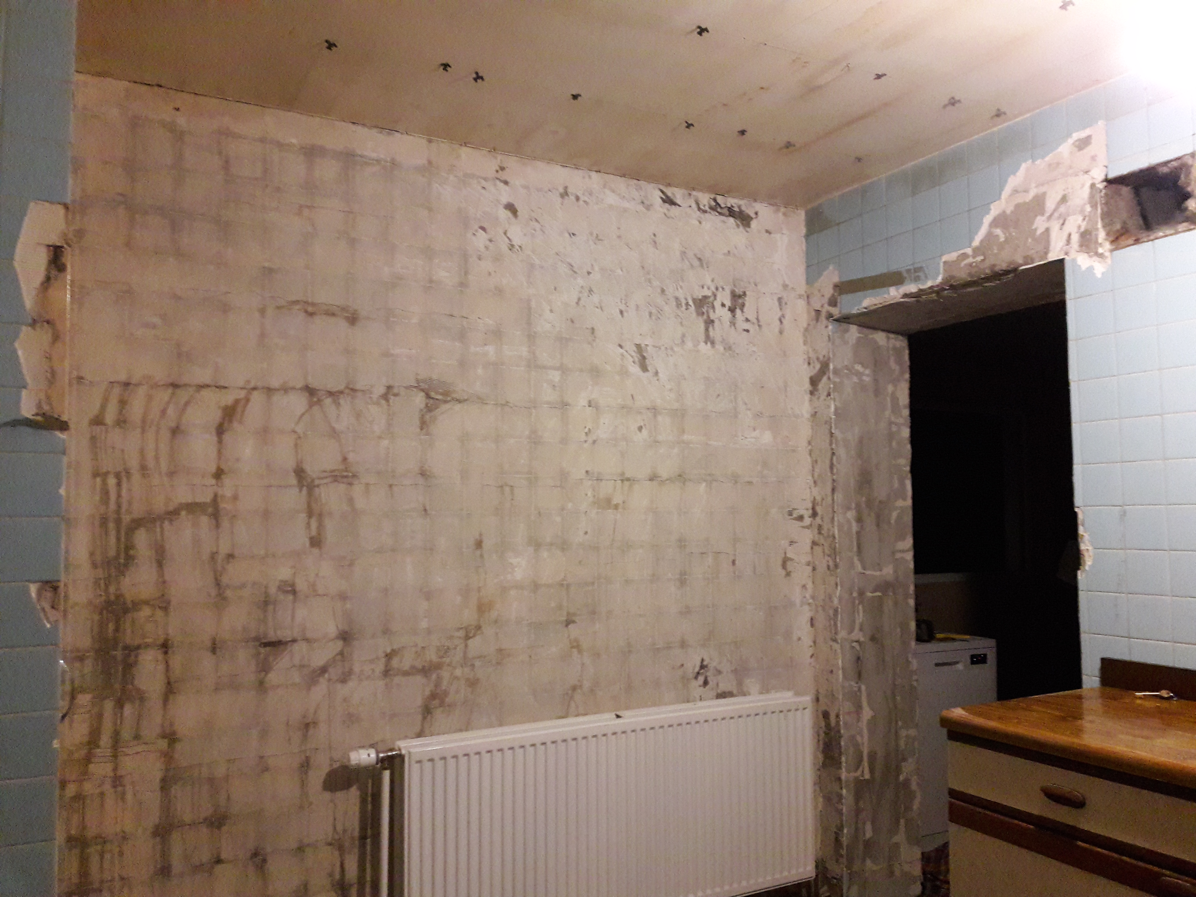

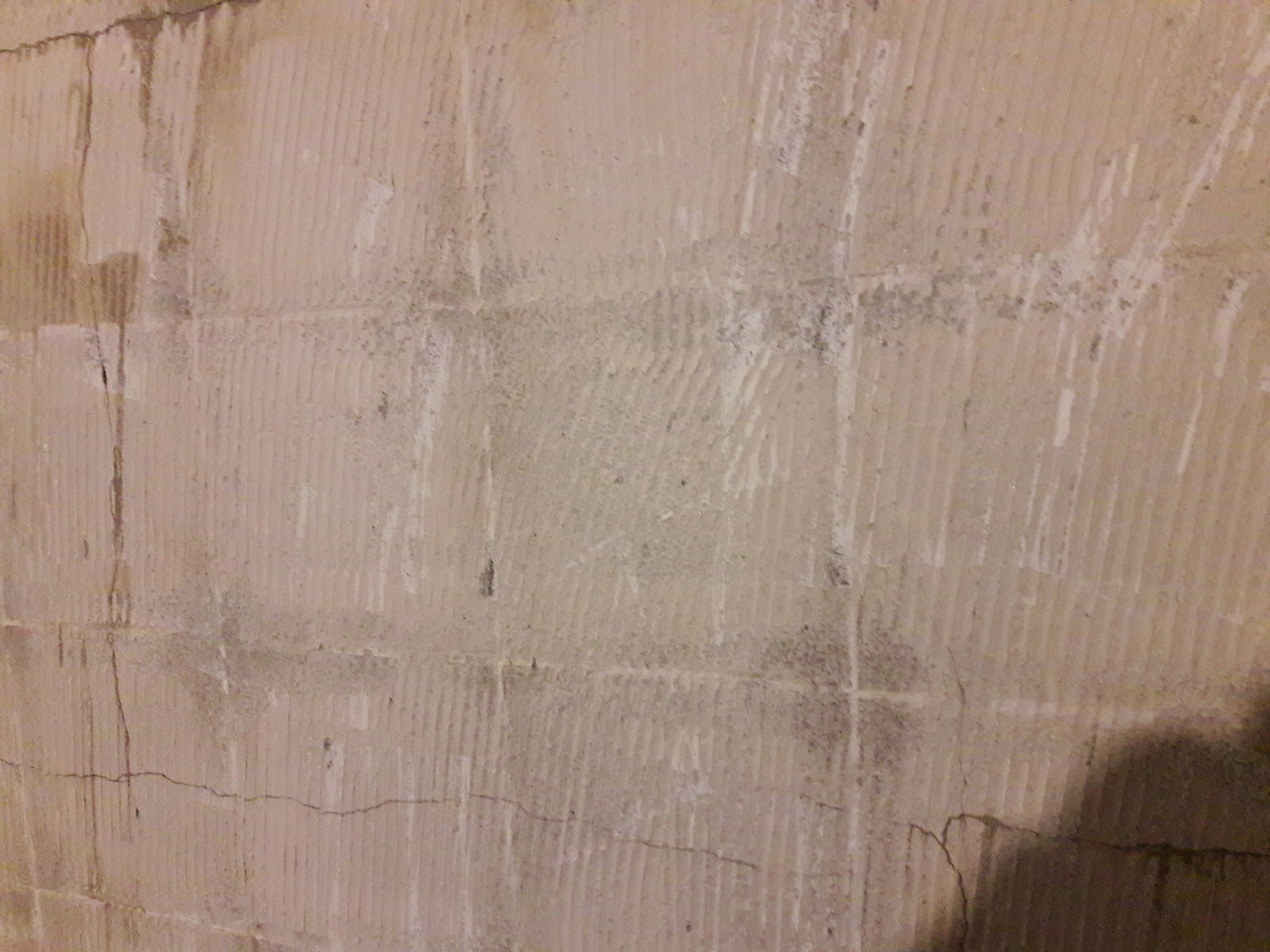

It's not too bumpy. I have attached a picture. I used an SDS tile chisel to to get the tiles off and could attack the cement with that, but would rather not!
Thats an extremely thin skim of plaster and then render underneath. Looks a very friable surface. I would scrape back/ rub off high spots, clean, prime, glue & screw (mechanically fix) tile backer boards to the wall.

After seeing the pictures .. I stand corrected...It looks like serrations on the wall over finish plaster..
Tiles look like 4 1/4s pilks...Stuck well and can be a bugger to get off..A few hair line cracks... which if has blown you should chop off and make good
As mentioned already ... Quickest fix is to overboard
Some were murder to get off - a particle at a time! Others just fell off. The whole kitchen and utility room are the same. I've already detiled utility room and still the rest of kitchen to do. I'm still leaning towards backer board for that wall. the other walls are just getting plastered as normal. The SDS remover made all the difference , although the high up tiles seemed fixed better so a bit of a strain.
