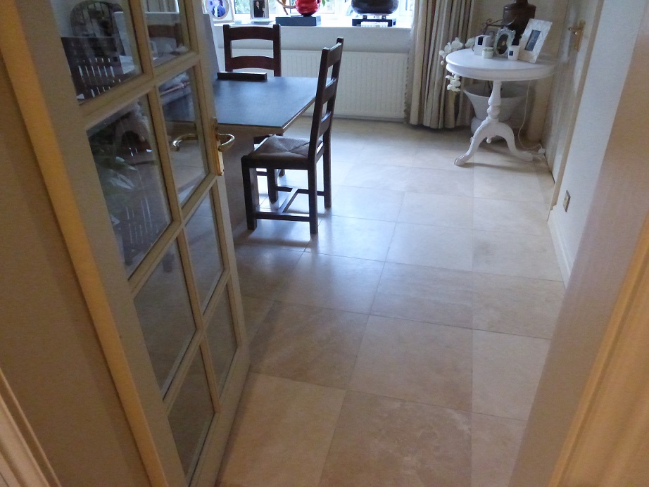

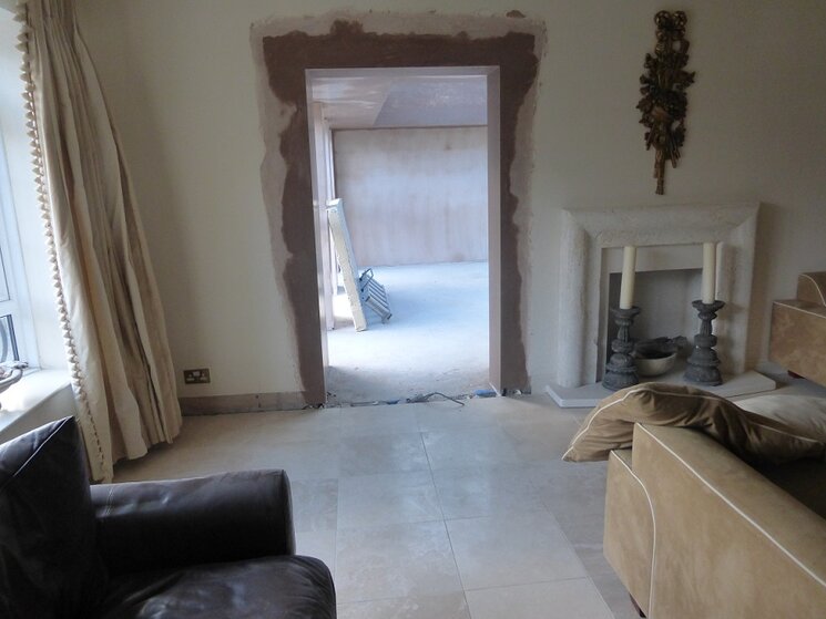

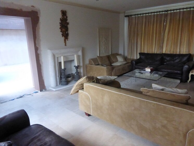

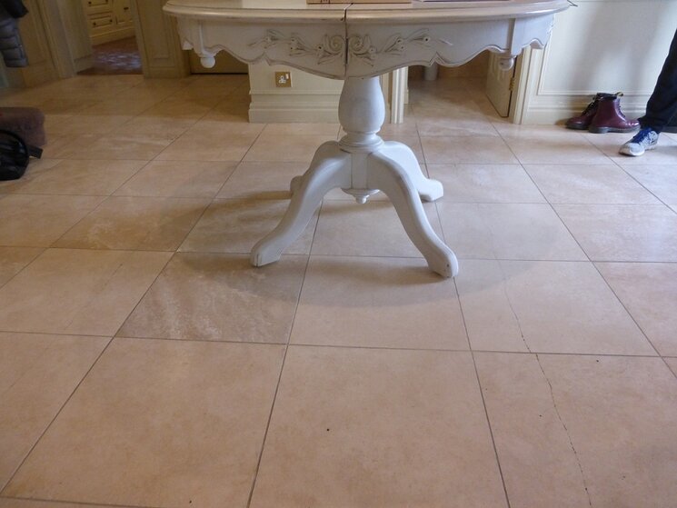

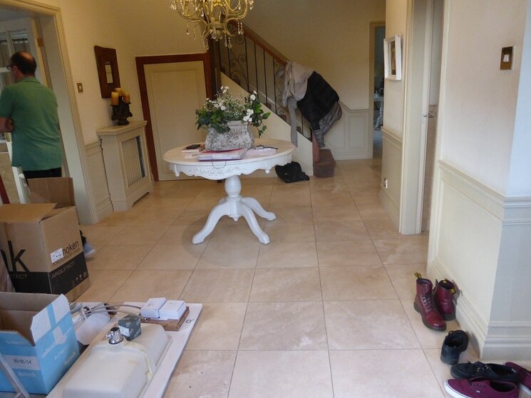

Just been to check out a possible job and soon sitting down to do a quote.
I have attached a couple of photos.
Hoping if any folk could estimate roughly the cost they would be charging and possibly the time to complete bearing in mind the size of the porcelain and cutting.
Presently there is an 88m2 floor running through 3 rooms.
The floor at the moment is floorboards, over boarded with 12mm ply then stone.

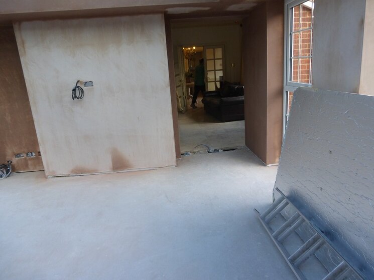

As well there is a recently built 30m2 conservatory with a concrete base.

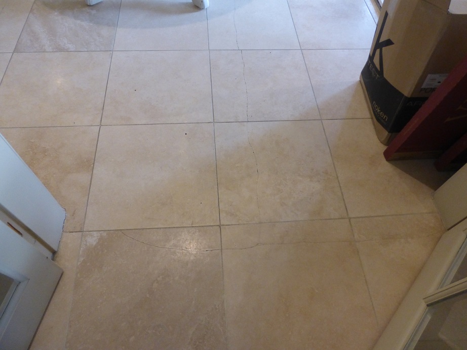

There is one area where there has been previous cracks(see photo) which suggest an issue with the plywood.
I'm suggesting to rip out all the stone floor, remove skirting, lift the ply, strength any joists if required then re overboard with 6mm Hardie then tile.
The tiles for the 3 rooms are 900x900 porcelain.
The tiles for conservatory are the random length plank affect.
I will be popping back to check heights of the floor so presently do not know if the floors need leveling.Also if anybody can think of an other issues that may occur that i need to cover myself for.
Cheers All
Kevin
