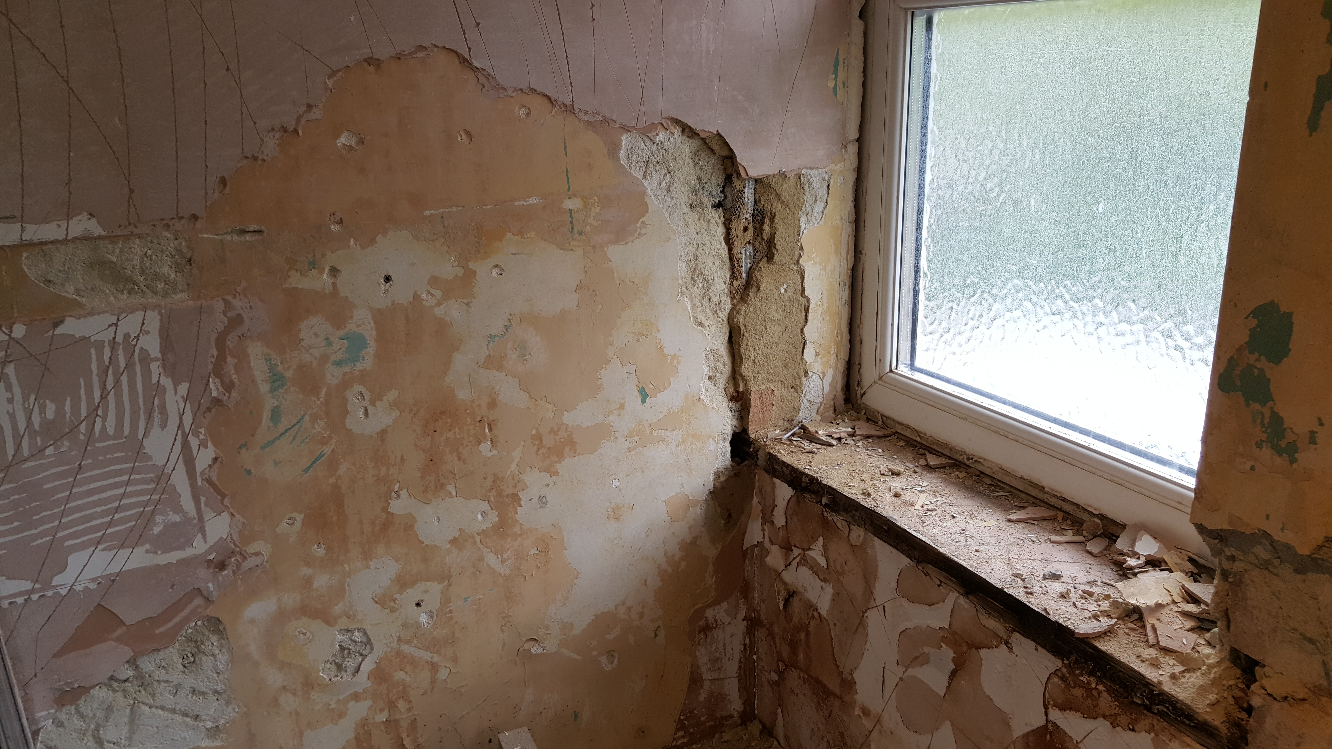

This bathroom was tiled 2 years ago. Water has been leaking into the kitchen for the past 6 months. Customer said it was re plastered before tiling but as you can see it wasn't.

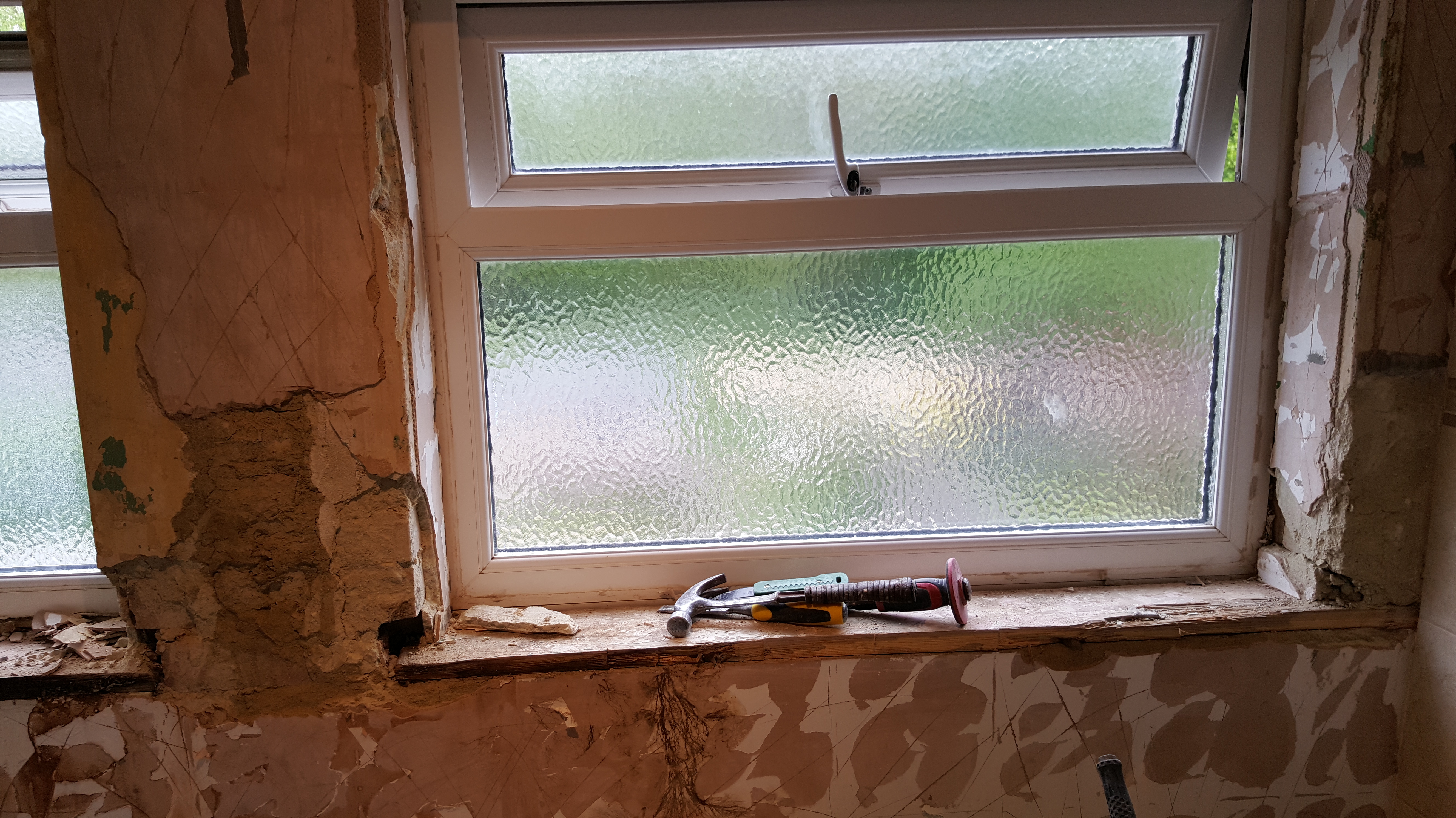

The wooden window cills were left in and tiled over.
Ive just spoken to a plasterer on phone and he says 250 plus mats (£300 total). WHAT!! This cant be right?

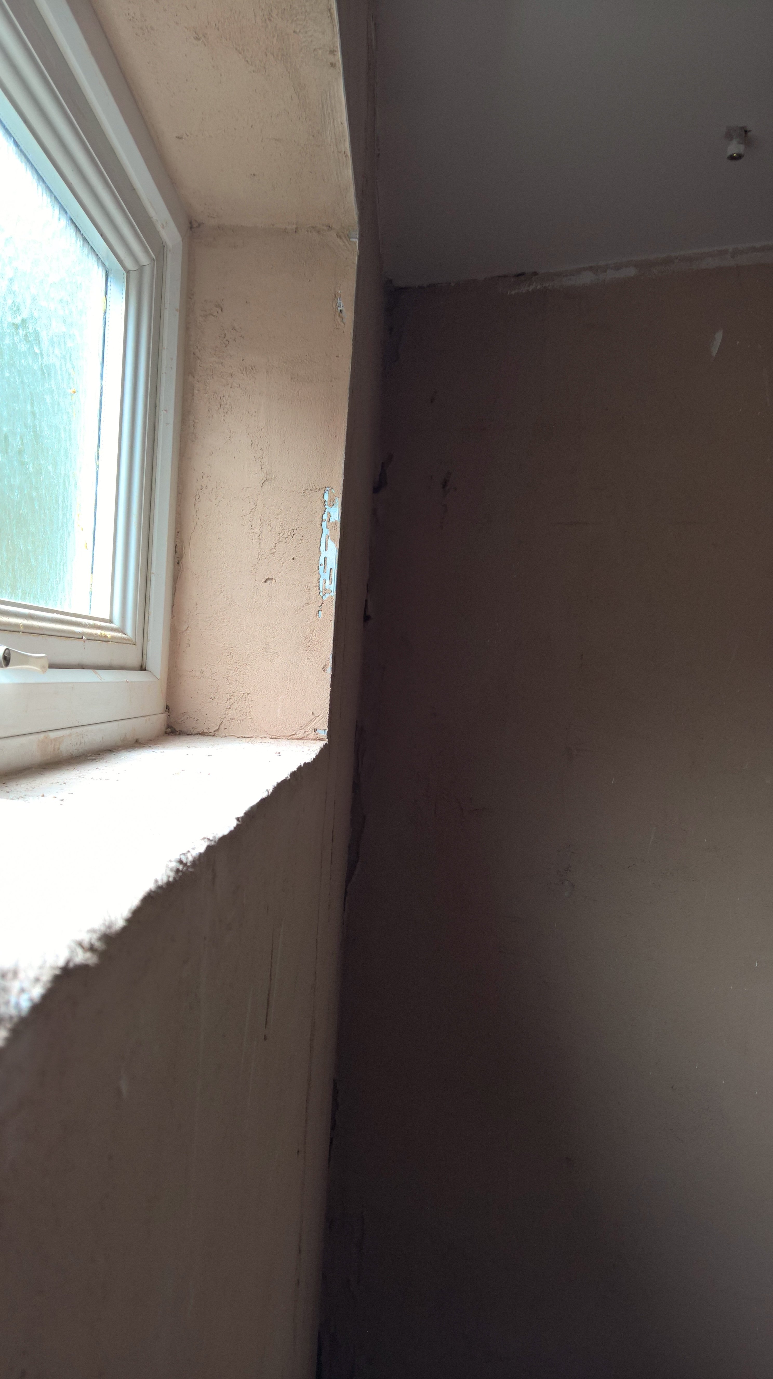

I'm going to replace cills with plasterboard.
Any other suggestions please.
