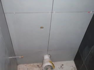

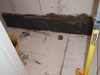

Rip out, first fix and reboarded with Aquapanel.

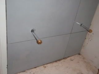

Rad tails replaced with chrome. Basin to be retro-fitted as per bathroom. Toilet feed was surface mounted

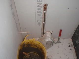

in the corner with big stop tap. For neater job and avoid boxing in pipe work altered for the unusual back feed to new toilet:
Imperial pipe. No space to cut in ideal place so double backed through joist.
