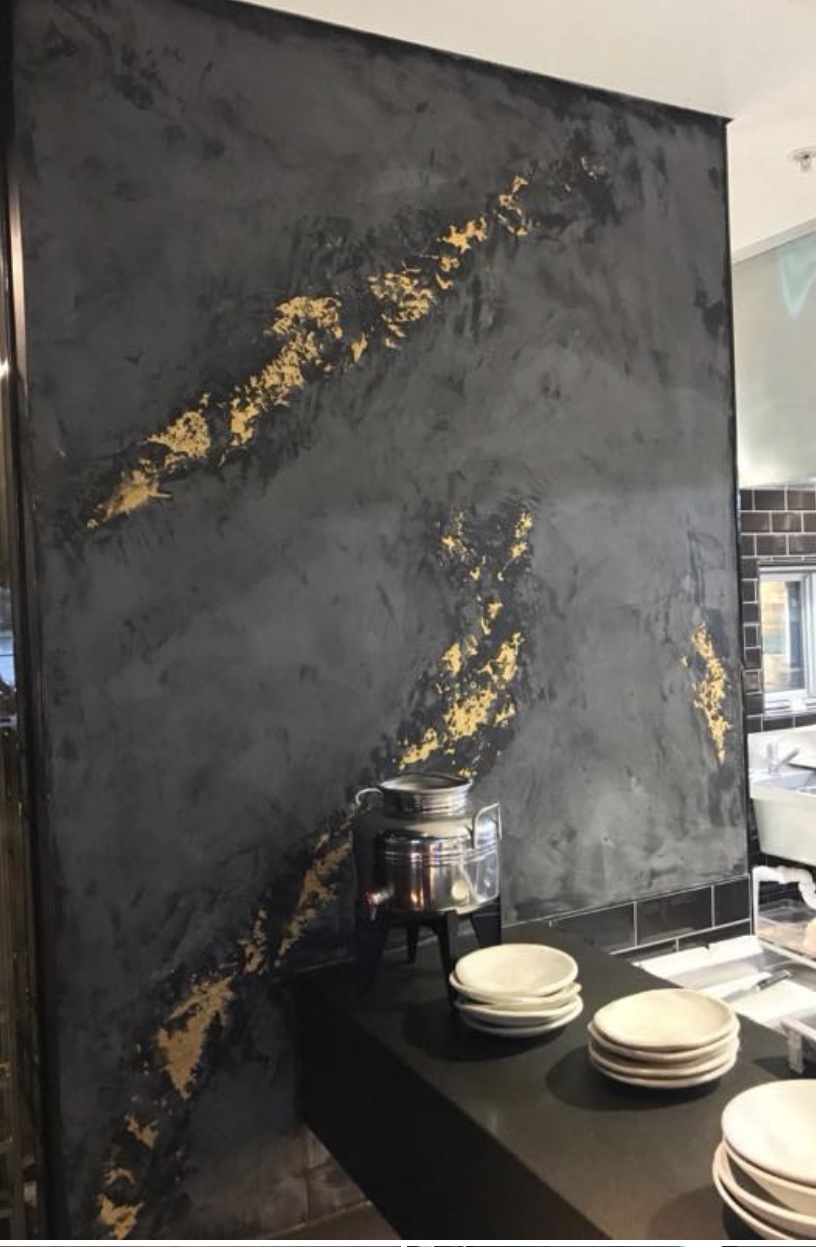

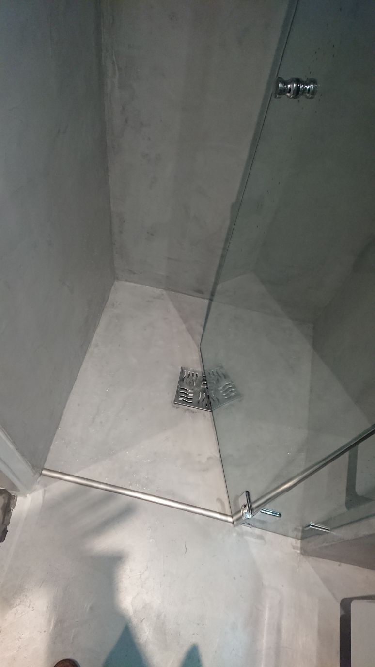

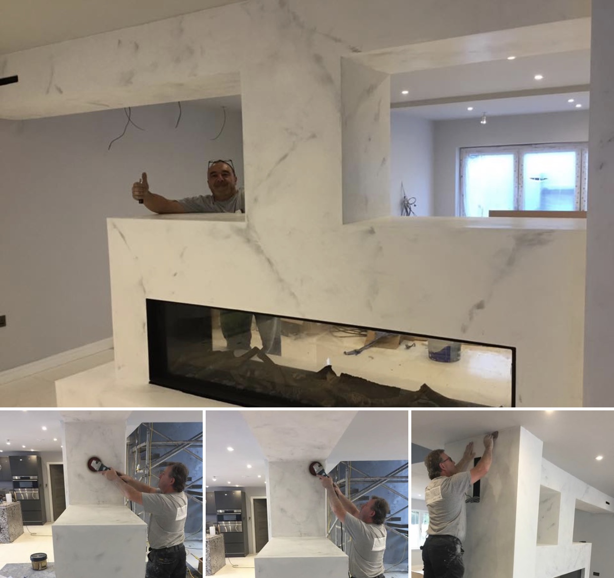

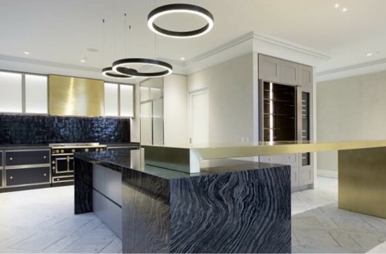

I appreciate thisisabit of ‘after the horse has bolted’ but Microcement is widely used for this type of application, it’s like any specialist trade, it’s about the installer, NOT the product.
There’s a guy that lives in North Wales I think, you should check him out.
Ex tiled, been using this product for almost 20yrs, his work is truly unbelievable.
If you want it done right, you gotta dig deep, like anything else in life.
His name is Juan Pallicer Saballs from
Microcement technologies.
Polished Plaster Group - http://www.polishedplastergroup.com/
This is what he does.
Truly incredible.
