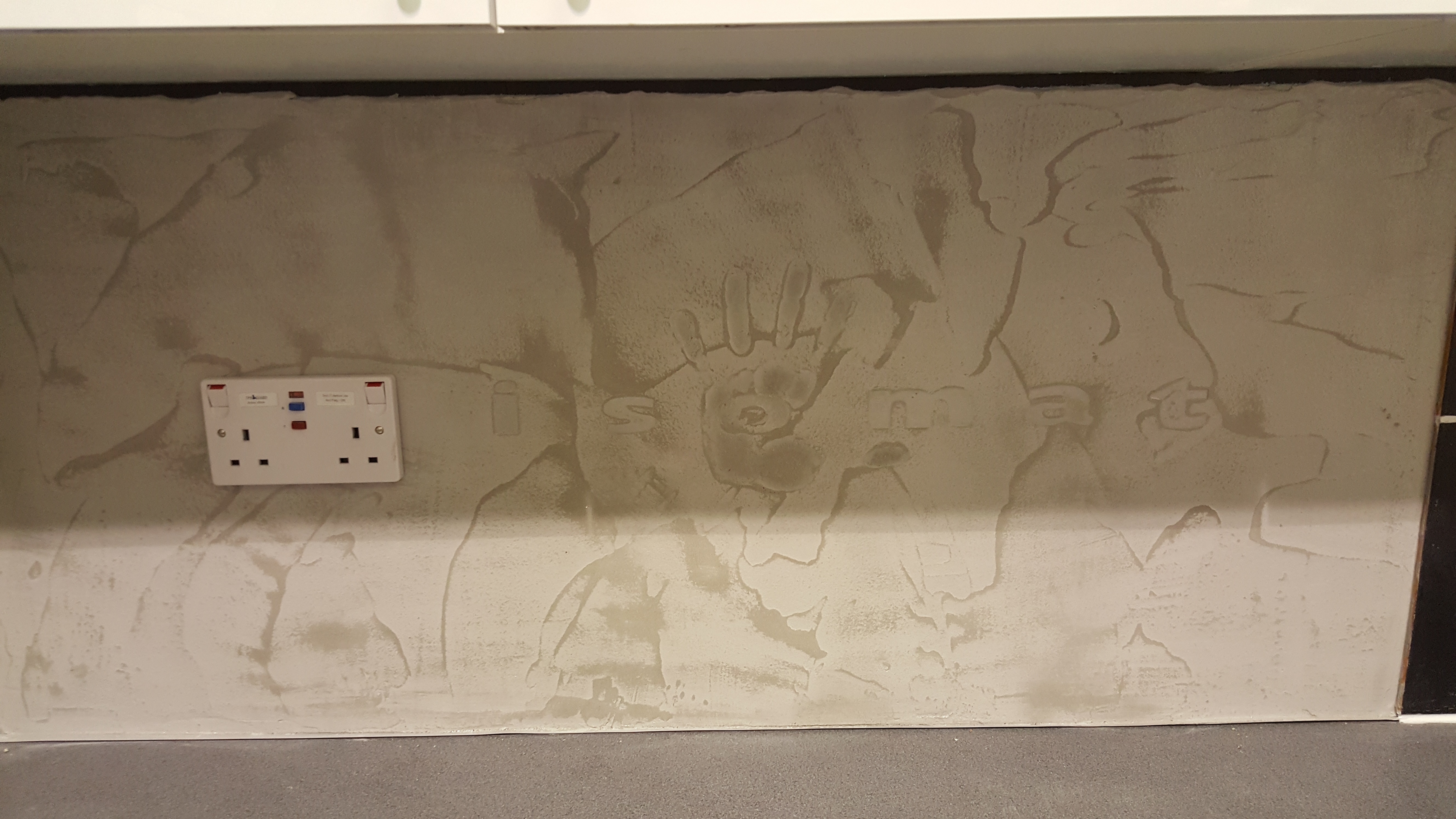

Did you notice the grey sofa in Isomats meeting room Geoff?
That’s just a block of polystyrene sculpted in to shape and covered in Microcement. Bit hard to sit on, but it’s certainly crack free.
All their sinks are custom made, and are all constructed from mdf and again coated in Microcement, it’s a pretty amazing product.
