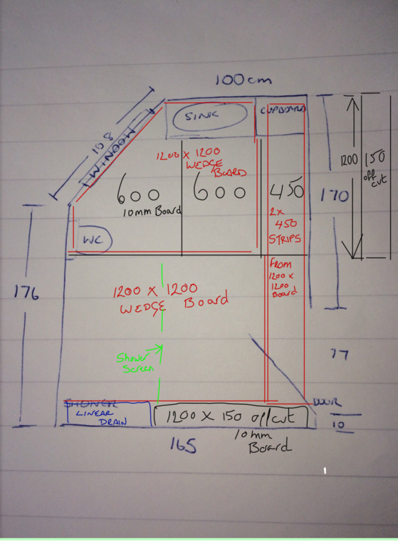

Thanks for the reply. Have attached a sketch of how I envisage it at the moment based on current layout of pipes etc. It could be re-configured. The tiles would run parallel to the door.
I would like to avoid any perimeter lines if possible (could even change the length of the tile to 90 cm). Your advice would be appreciated. Thanks.

A seamless floor can be achieved using PCS Wedge boards available from Lee@TileTown,
First lay 10mm flat boards at far end of room, 3x1200x600, this will leave a 150 off cut, keep to one side.
Then overlay with 1200x1200 wedge boards, these boards are graduated from 20mm down to 10mm.
So now u are left with a 20mm step across room in the middle. So now lay a second board over remainder of floor, this will take u from 20mm down to 10mm and leave a 150 strip. U can in fill this with the first off cut flat board. Then place your linear drain in desired position.
That's a very basic description of the method and there are other things to be taken into account, like the small wedge across face of door, but in reality it wouldn't be much of a rake.
So I've just outlined it. Otherwise it would be a very involved post.
If u wish to go ahead then each element can be tackled along the way.
