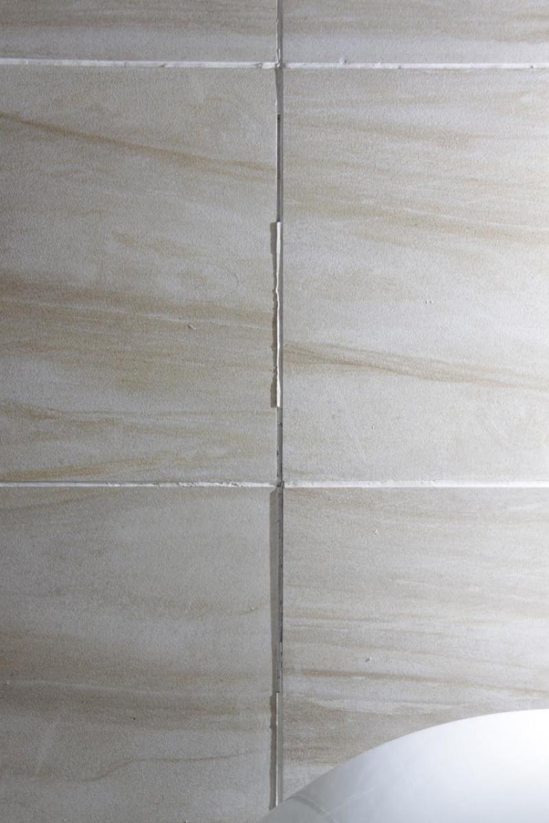

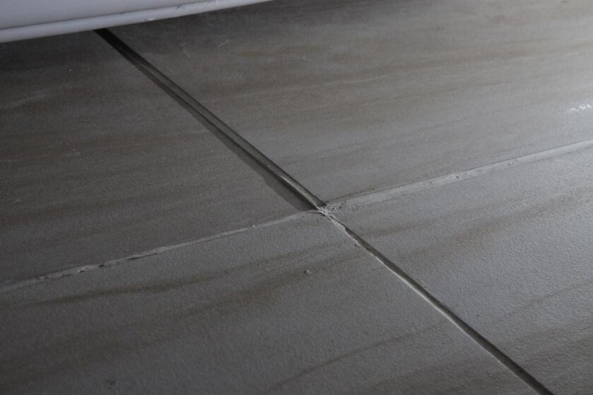

Hi all. First post as I found this forum whilst searching for my problem. Had a builder round last March to "do" my 1st floor bathroom (move wall, plaster, paint, tile install new suite). The floor which floor boards was covered in 6mm marine ply, screwed every ft and flexible adhesive and flexible bal grout was used.
Within 2 weeks the grout had cracked and some bit had risen. I asked him to sort which he did by just scraping out the offending areas of grout and redoing. That seemed OK for the couple of weeks he was finishing off. Over the last 10 months the tiles have slumped and risen, grout has come out and cracked and the whole floor looks really tatty. I have contacted him and after a few words he has come round and agreed to take the floor up and re-lay saying it maybe the movement between the floorboards and joists that is causing movement. He also says if it happens again it will not be his fault as it must be a "whip" in the joists causing it.
I really don't want another tatty floor in a few months so am wondering if the same will happen again or if he is saying all this to absolve a sloppy job done in the first instance. I know loads of people with tiled floors over floorboards without this problem.... Have any of you heared about tiles moving due to flexing joists? A bloke at tiles-r-us recons that it should no way happen with BAL adhesives and grout.......
Could do with some impartial advice so I can bite the bullet and lay laminate or lino if it is a no-brainer.
Cheers
Mark

6mm ply is too thin. 15mm minimum is recommended. 18mm more readily available. If the Floor was free from deflection before you had the tiles laid then a 6mm tile backer board would have been the answer.
Only way to cure your problem now is to redo it.
This is exactly why 6mm ply as an overlay is a no no! I'd recommend he removes the floor boards and installs 18mm WBP plywood and then overlay with 6mm hardiebacker board. Whilst floorboards are up, he'll be wise to put some more noggins in too.
The tiling is appalling. Get someone else to set them next time is my advice.
It would not have mattered aqua if the tiles were perfectly laid, they are on the wrong substrate and were always going to have problems.
:thumbsup:
6 mm ply is way to thin, if floor high is issue, then you could remove floor boards, and put ply straight on noggins and then overlay with 6mm hardiebacker board, or 12mm ply +12 mm ply and overlay floor with Ditra mating, that works too :thumbsup:
sorry this has happened to you pilsburypie
the above advice is spot on and i wont add to it
the guy in tiles r us is clueless and I would ignore his advice
tell your builder he has specified your job wrong and he needs to come back in and redo it or you will take legal action against him
i wouldn't bother to get him back to sort it,i would demand a full refund,take it up yourself(shouldn't be too hard by the looks of the pics) and get a decent tiler in to do it properly because if thats his first attampt then i'm not sure his second would be much better:thumbsup:
ps- welcome to the forum
"Have any of you heared about tiles moving due to flexing joists?"
Could be true, but had the job been done correctly he would have been able to check for that and added noggins if needed. With the correct flooring most of the flex in the joists would have been taken out. All joists have some movement, that's why it's important to have a thicker more stable floor upon which to tile.
