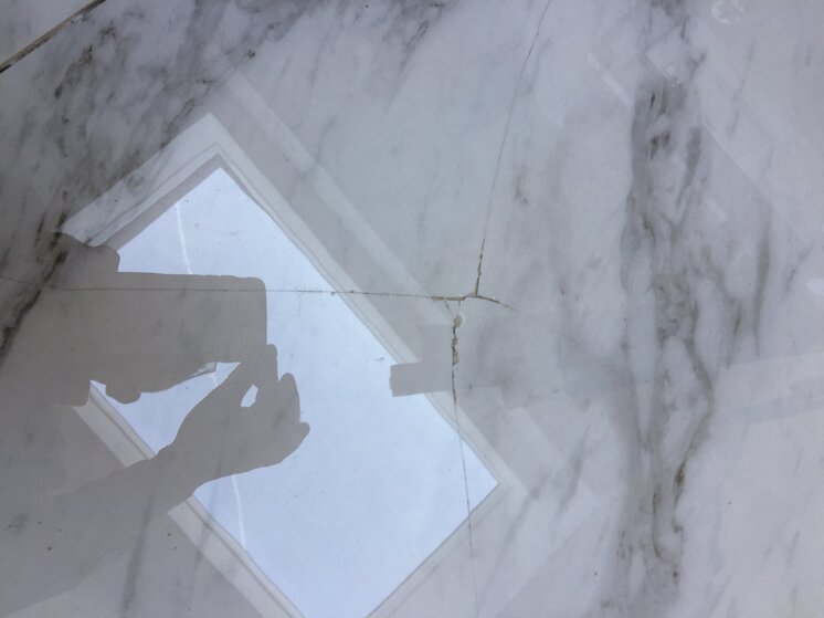

Funnily enough Andy, NO, however, this client did call me around 6 weeks ago to get to try and help his fitters/builder because they were struggling.
I was too busy at the time.
They were struggling with one particular aspect.
So I talked them through it on the phone, and they managed to overcome it. (Nothing to do with the laying before you ask 😀)
I heard no more, until yesterday.
Apparently about 30% has cracked.
Given its failed so quickly, and trying to read between the lines of the info I've been given, points to two things I feel.
1. Complete installer error in technique.
2. Concrete plastic shrinkage. 😉
So we'll see in a little bit.
Won't be fun lifting a tile tho and leaving it in a worse state than it is already.

not b&q tubed adhesive then 🙁

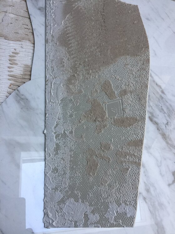

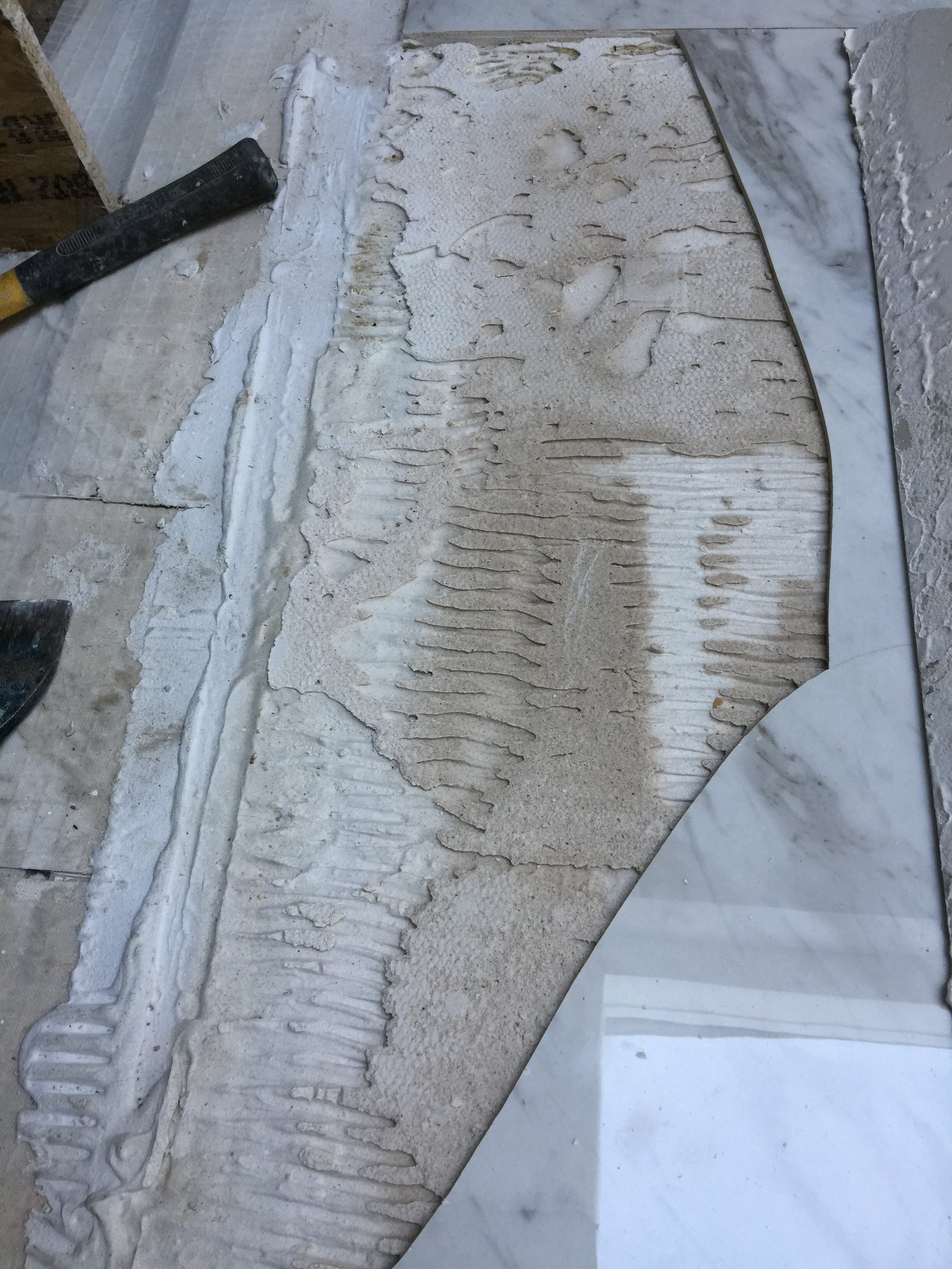

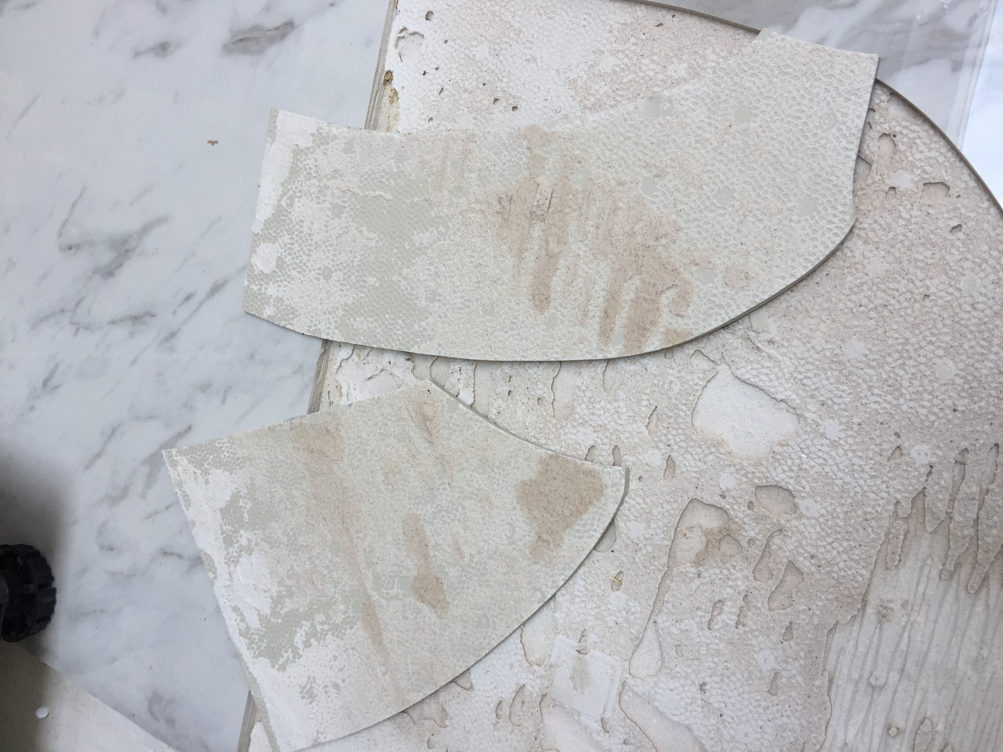

Well we have a winner!
15 tiles on floor @timeless john
9 cracked!
Full ripout and retile, no question.
And our winner was.......nuuuuumberrrr 1
Spot the mistake apart from tiling directly over Polypipe boards fitted with only a 1mm antifracture mat.
No back buttering at all and about 15-20mm deep adhesive.
Oh and a couple of unique design changes cos they cut the tile wrong and patched it in.
More lips than mick jagger (sorry mick)
Grout joints 2-6mm and more stepping joints than an aerobic class. 😀😛
