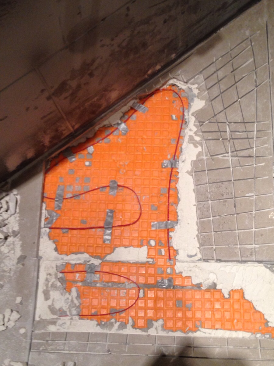

I want something that can do this
For reasons I won't bore u with (not my floor tho) I was brought in to repair this floor, and part of that process was expose a broken UFH cable.
I managed to do most of the cut lines with my Rubi TC 180 and the depth gauge worked well but took time to set it accurately.
However, because it wasn't at full cut depth the shroud was not in the down position because it rises and falls with the blade.
This caused an enormous amount of dust that I couldn't control and this was a extremely valuable lived in property in Fulham, not ideal!
The rest I did with my Flex and dust extraction hose held separately, again not ideal, whilst the dust extraction was more successful I couldn't risk plunging too deep!
So I want something that will do the job, it needs next to perfect dust extraction, which can be accomplished with a fixed shroud, and something with millimetre perfect cut adjustment!
I don't think that's too much to ask for, do you? 😀
