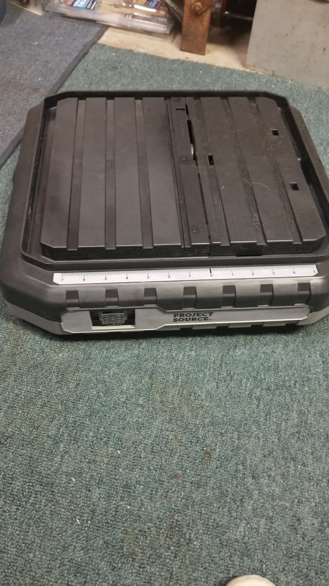

I bought a portable wet tile saw it was only around $50 or $60. Others have borrowed it and liked it. Of course I haven't used it yet. Not at that stage right now. Which is why they feel free to borrow. Lol
