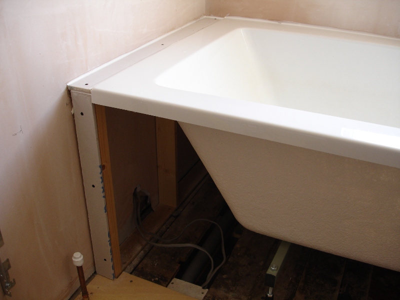

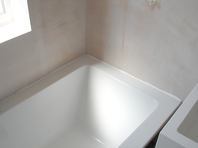

Thanks for all the advice, I'm trying to take it all on board :) I've shuffled the bath up and boxed in at the end. I don't have any cement board, so plasterboard will have to do - I'll tank it just to be sure. Siliconed all round the bath last night, and I'm starting the tanking now - wish me luck!

That silicone seems to be quite proud of the bath, you need to cut it flush with the surface prior to fixing any tiles.
bodgermatic
I'm not sure I understand about the silicone. The tiles are 9mm thick, so it'll disappear behind them quite nicely I think. I've also got to add the tanking tape over that silicone too (If I've correctly read the kit directions)
diamondtiling
The silicone should be flush, otherwise it will hold the tiles up too high from the edge of the bath. You should be aiming for a 3mm gap from the tile to the bath in order to acheive a nice silicone finish. As you look at the first picture the silicone needs to be cut flush to the bath now before you start tiling.
