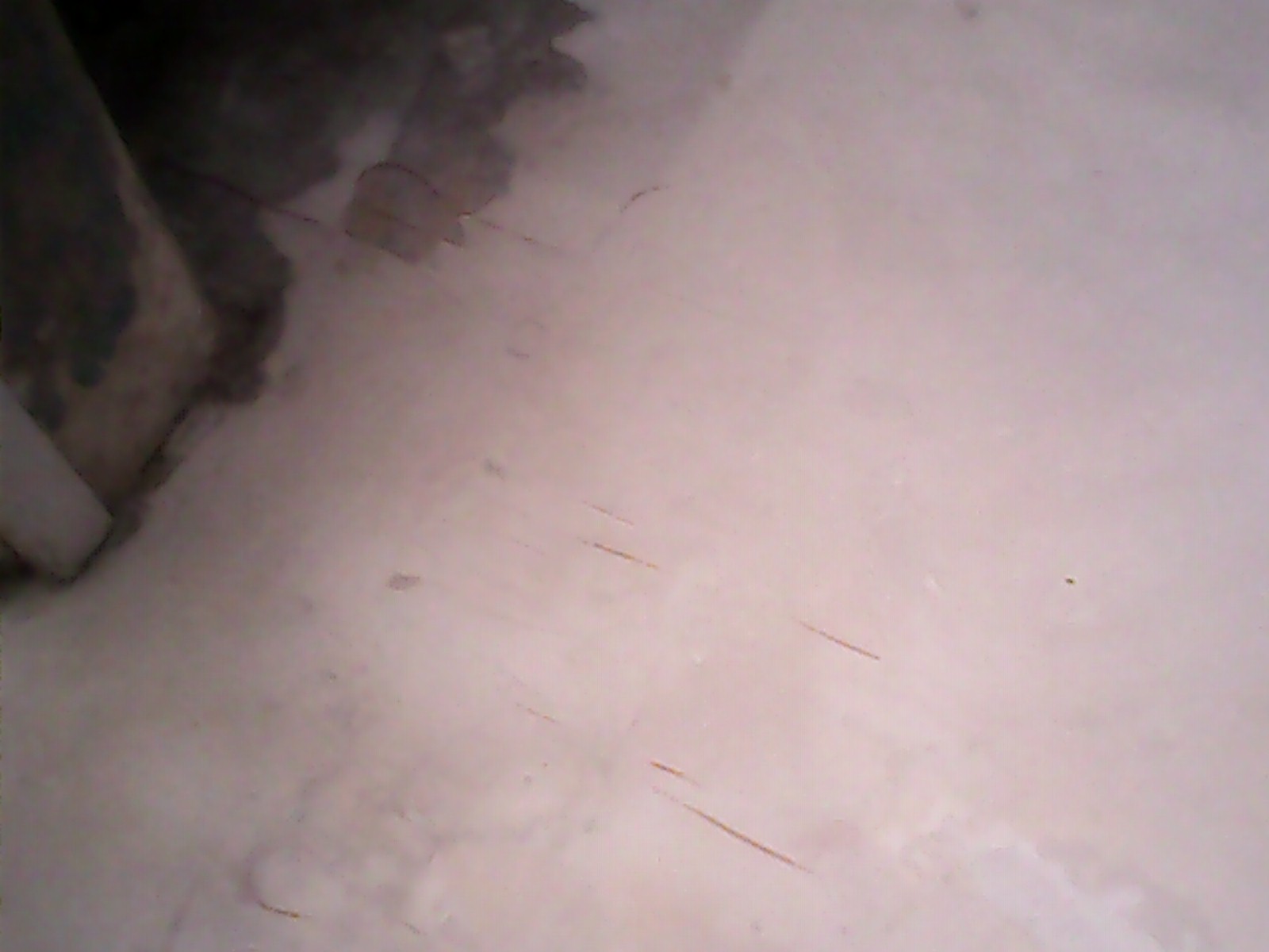

My first post, joined forum to get some help as my husband thinks everything is ok and i am harrasing. We Had warmap Ufh installed on Friday. It went on a bare concrete floor. Tiler used Tarmac floor levelling compound and did on the go as he poured compound. he never laid wires down, they are attached here and there with a tape that is sticking out. Distance between wires varies from 5mm to 15 cm and yes I can see them.
Can this be salvaged and how? I attached pic sorry not the best quality.
My first post, joined forum to get some help as my husband thinks everything is ok and i am harrasing. We Had warmap Ufh installed on Friday. It went on a bare concrete floor. Tiler used Tarmac floor levelling compound and did on the go as he poured compound. he never laid wires down, they are attached here and there with a tape that is sticking out. Distance between wires varies from 5mm to 15 cm and yes I can see them. View attachment 106032 Can this be salvaged and how? I attached pic sorry not the best quality.
Afraid not. Cables should be evenly spaced min 5omm. Should have put insulation board down.
Contact Warmup and explain what has happened. Get it in writing and pass this on to the installer. Mention that you’d like the spec to follow warmups manufacturers instructions.

I'd be passing no information onto the installer, obviously hasn't the first idea what he's doing and should not be allowed back into your property to continue, only thing I'd be saying to him is come and collect your tools and goodbye..
You’ve got to give him the opportunity to rectify it. Legally.
I agree though- I’d not want him anywhere near my house again. You’re better off trying to keep things legal. Perhaps even suggesting he pay for a professional to rectify the issues.
When I say rectify I mean a full rip out and re fit 😀
There is no rectifying that though...what could possibly be done to salvage it, if I were him I'd consider myself very lucky to be just walking away..
