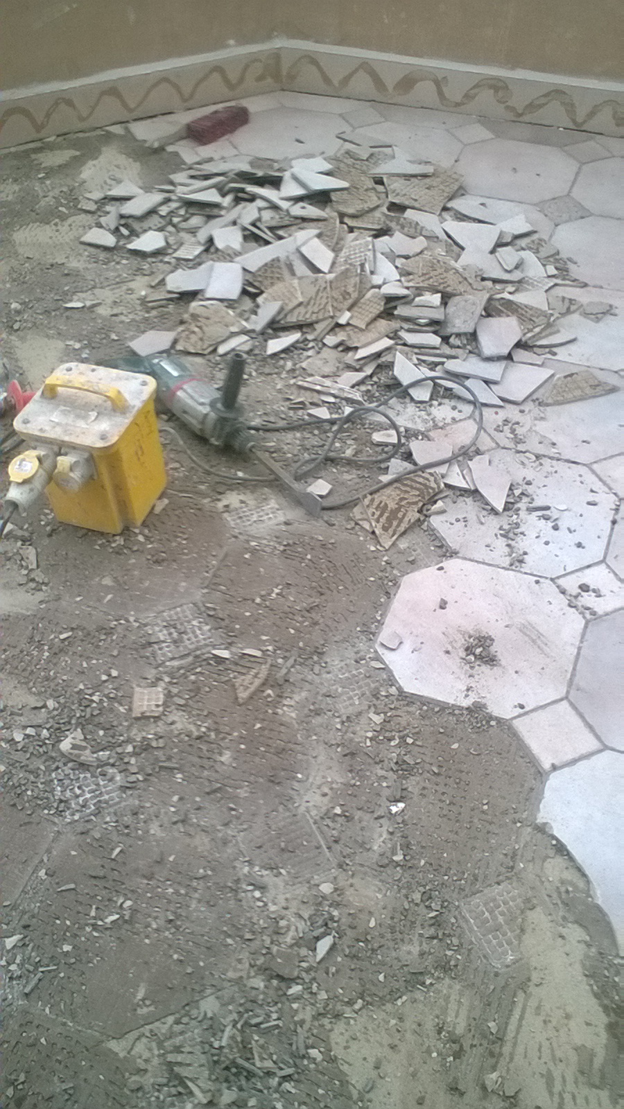

I just ripped up a floor yesterday was tiled straight on green chipboard 15 years ago and while it had cracked the tiles over every join in the boards due to ridiculous amount of deflection it still took me 3 1/2 hours to rip up 9 metres, nearly burnt my sds out.. WP_20150921_11_04_11_Pro.jpg

I just ripped up a floor yesterday was tiled straight on green chipboard 15 years ago and while it had cracked the tiles over every join in the boards due to ridiculous amount of deflection it still took me 3 1/2 hours to rip up 9 metres, nearly burnt my sds out.. View attachment 76953
Shouldn't buy ur tools from Aldi or lidl then Andy! Haha
Spare Tool
Haha..let us know next time there stocking Metabo in lidl mate :) same plumber I work with bought one of there multi tools...the blades lasted longer than the motor :(
