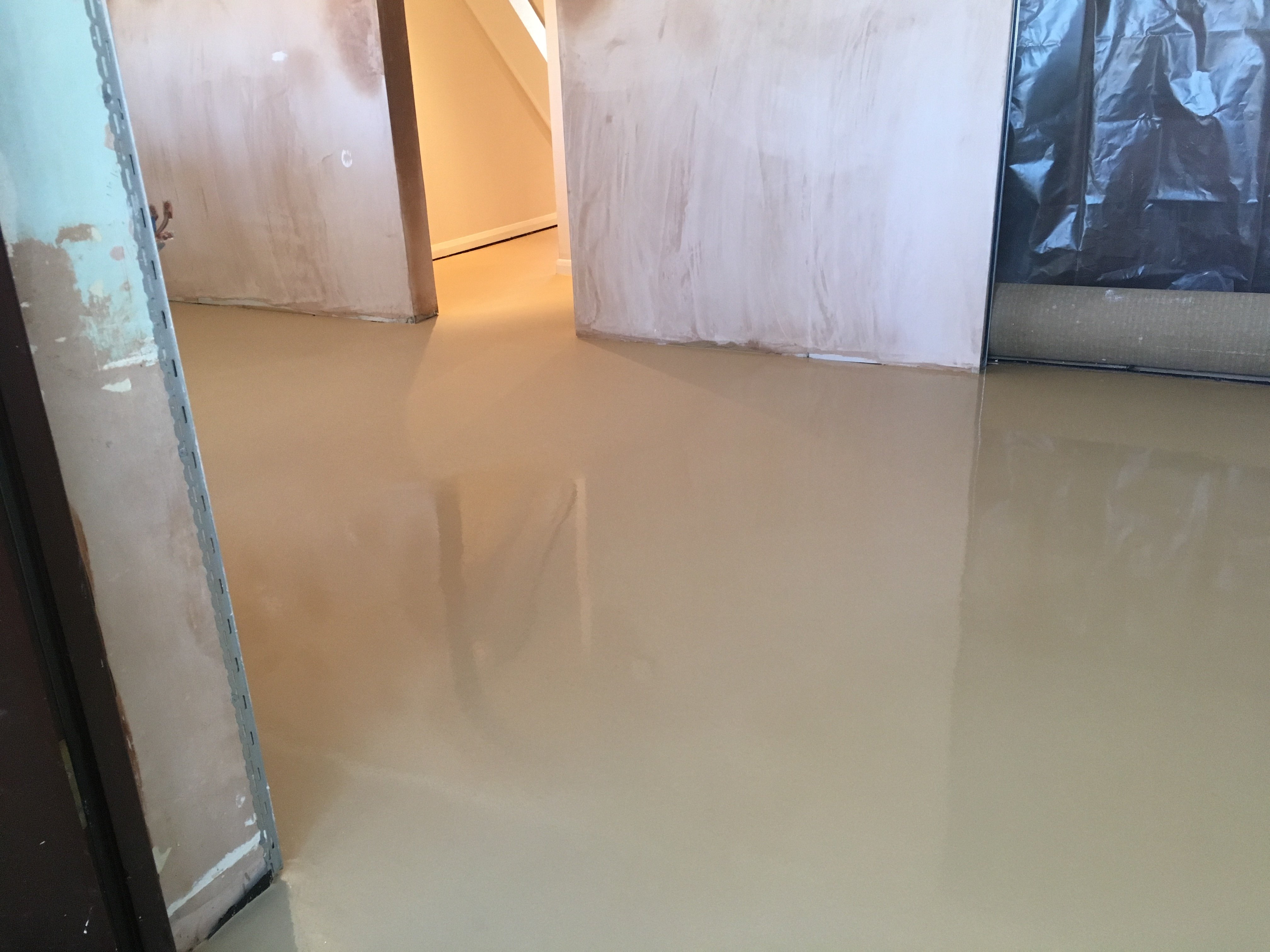

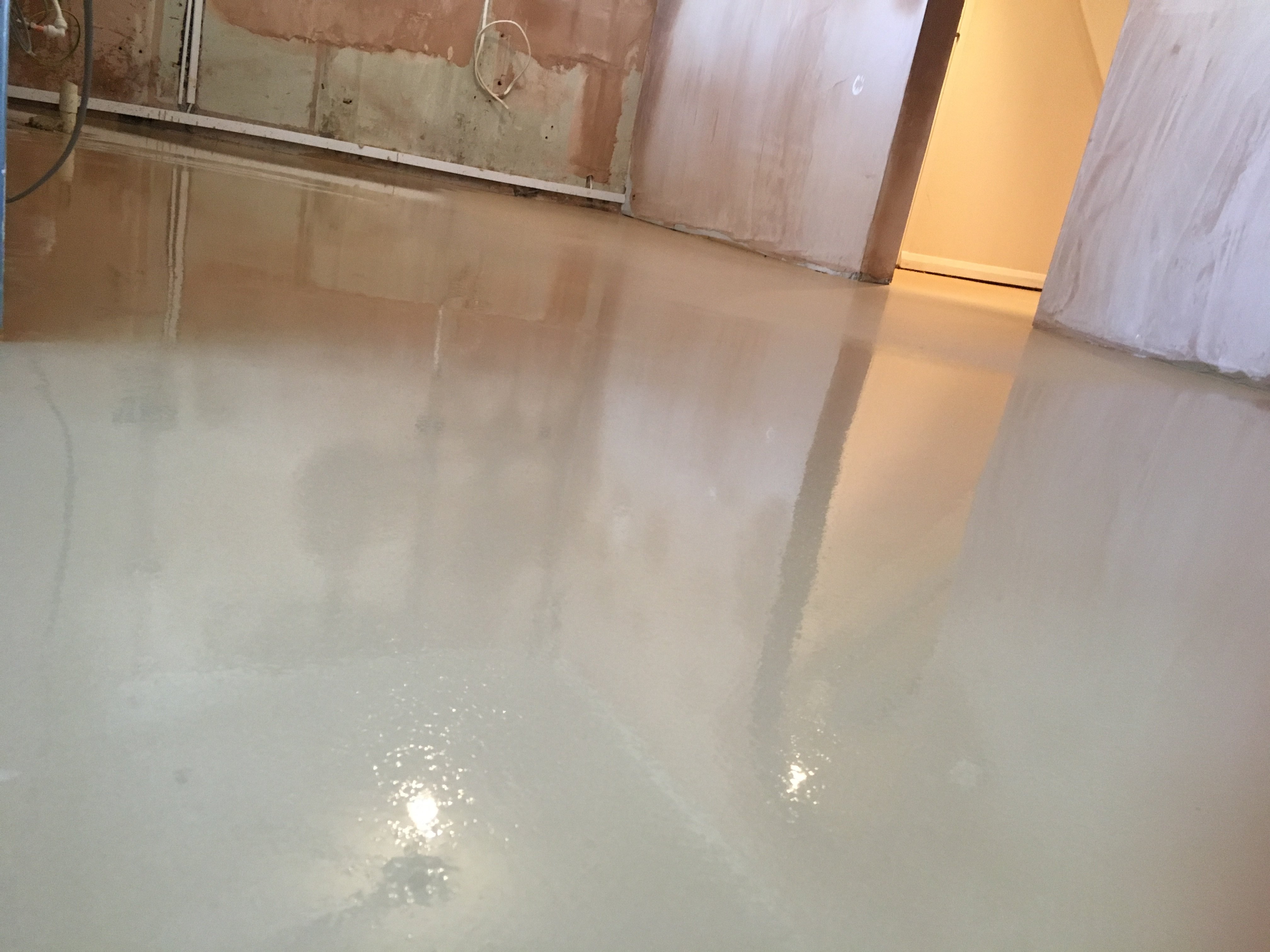

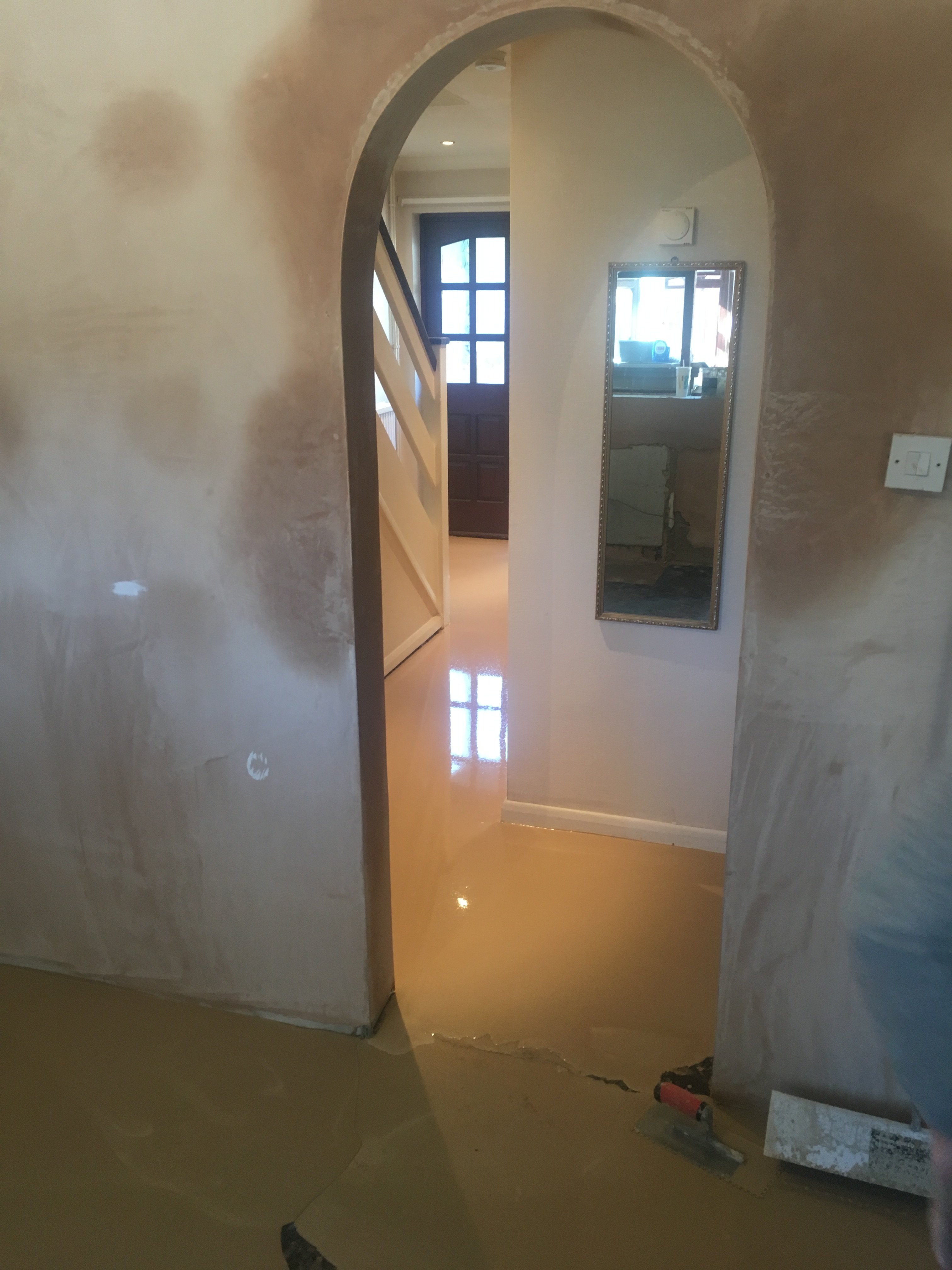

Floor was screed, it varied in thickness as there was a supporting brick wall we took out between the arch and double doors and the original screed was falling in opposite directions.
Just used a spiked roller, helps get the air out and get it flat.
I will say though I used Topps Tiles fast track and it was really nice stuff and we were walking on this floor within the hour!
I highly recommend it.
I’ve used this before also and was pleasantly surprised by it.
Looks like the F Ball stuff I have used in the past, also branded as ‘Setcrete’and sold in wickes.
I’m just glad it’s not grey! 😀
