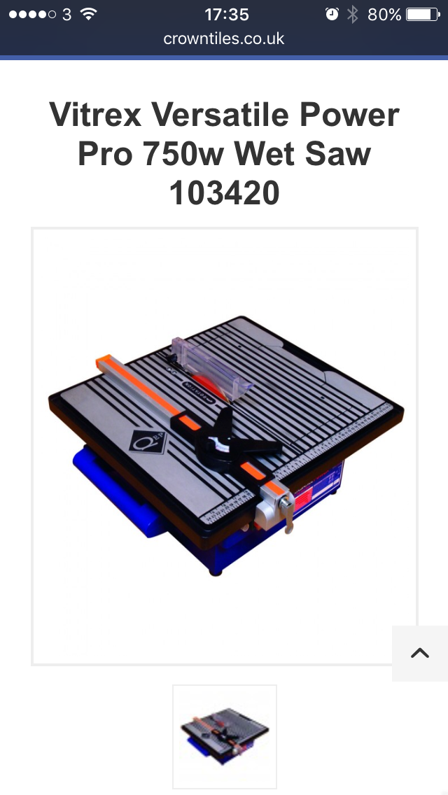

Is it this vitrex that you are meaning?
Bit small for stone work.
