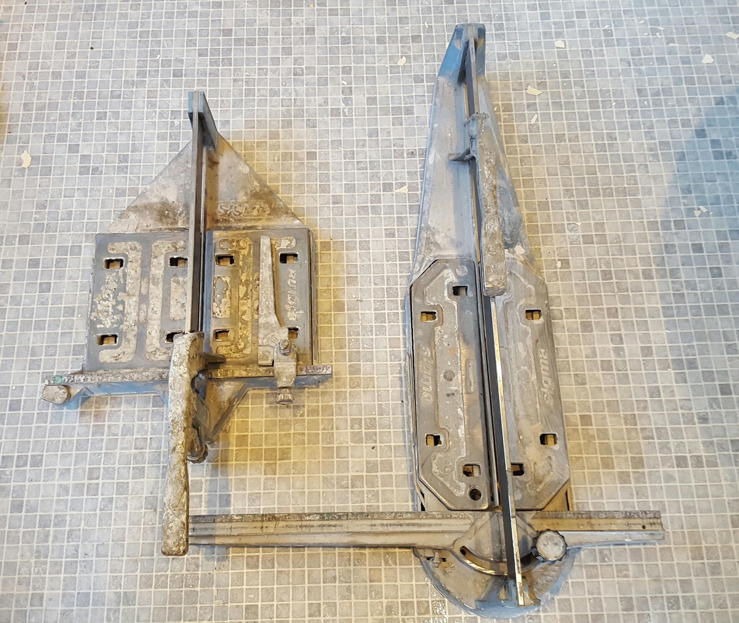

What if your cutting a 600 tile and you want to cut 24cm at one end and 25 at the other end?
Seriously?! You need to ask?
Ok then - If I was a noob, I would mark the 25 and set the tile to the measure tape at 24.
Then just tilt it at the far end to the 25 mark - lining up on the break bar or wheel by eye.
As I'm now 9th Dan in Sigma I can simply guess.
I would measure up the 24 or 25 on the cutter then tweak the top of the tile over by 1cm, unless it's a really off square cut, then i would mark it both ends.
If you want to know if they last I've had my sigmas over 20 years all I've replaced is the cutting wheels..
