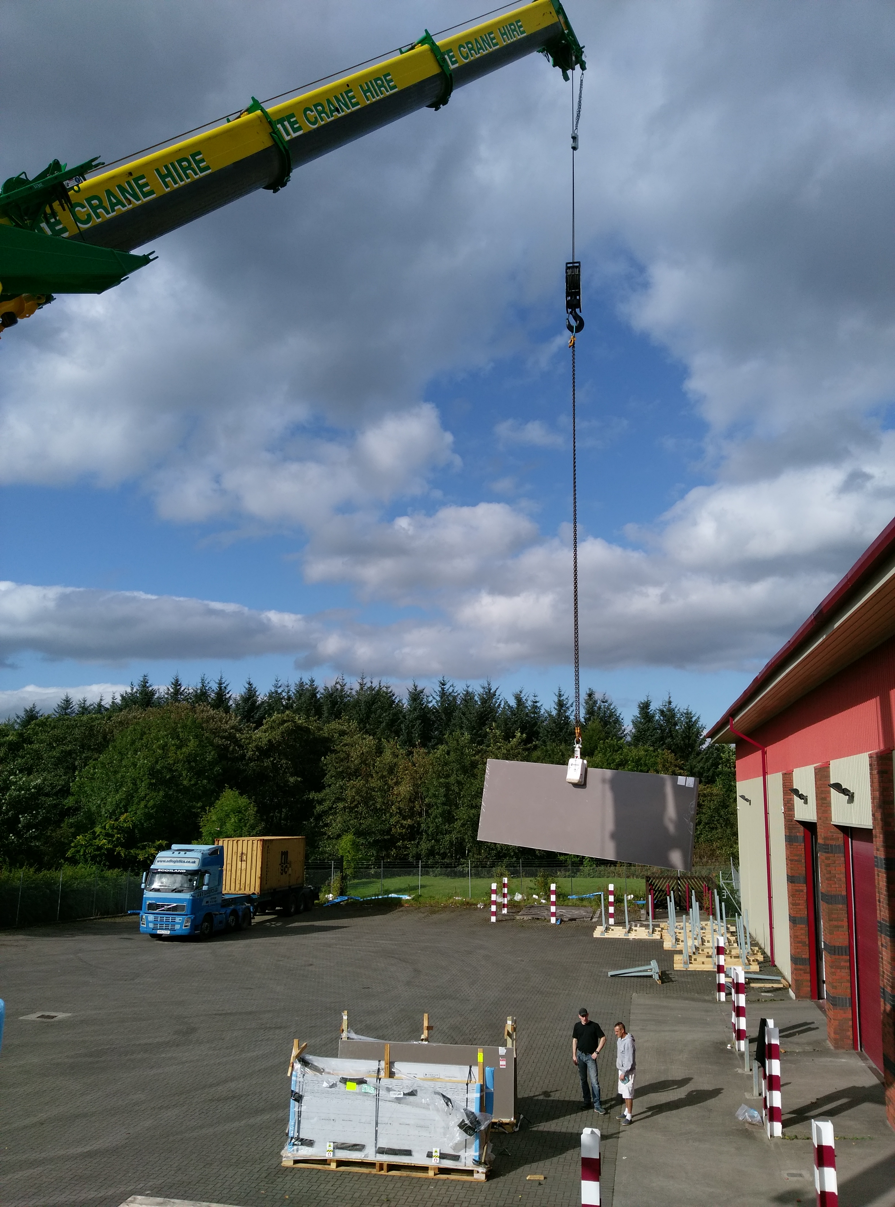

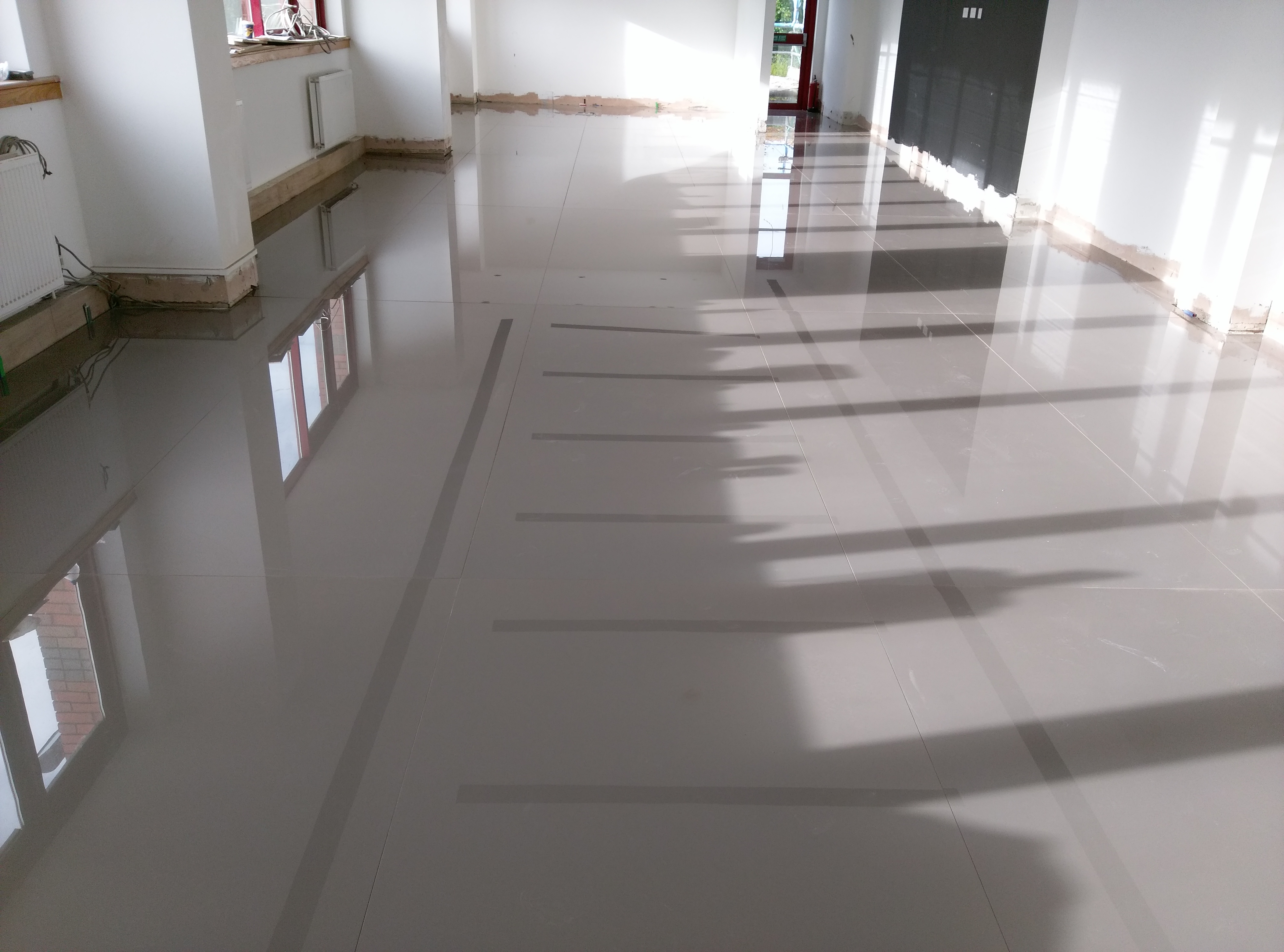

I am just curious if anyone laid or seen anything bigger than this as we were told those tiles are the largest format ever laid in Britain so far. I don't want to take a credit for that as I heard someone is manufacturing even larger format but only 3.5mm thick. Those iles are 3.2 x 1.2 m and 12mm thick. Each weight around 240kg. This is extremely dense porcelain with nano glass reflective finish layer. We did fix them using only suckers without any frames. Leveled with rubi tile level quick and cut with flex cs60.
Tommygun_ski
Do you want to see how they were lifted up the first floor? We have now on the floor 6 tons of tiles and a ton of adhesive.

Neolith have slab sizes of both 3.65 x 1.25 and also 3.2 x 1.5. I've never laid that size but i've seen it done, in the UK too. Yours are pretty close and a lovely job, but sadly you were told incorrectly. Although don't want to take anything away from you pal;)
Tommygun_ski
I knew that some manufacturers do larger formats but only heard about ultra thin porcelain like ecoporcelain or that casa florim oversize. Yeah. Client got slightly overexcited
