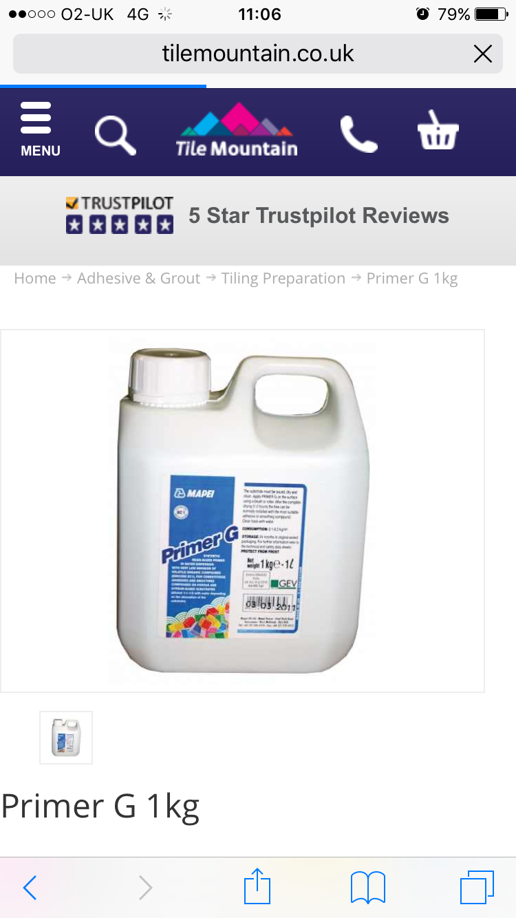

Could I mix this primer with a rapid set flex bagged addy!?
50/50 mix !?would a ceramic or porcalin stick to this type of base with out priming!?just so I no for future jobs🙂
I've tiles straight to it & also primed it then tiled.
Depends how long it's left for before tiling & if any dust or that gets on the surface.
I've also primed & tiled onto bitumen & I've never had any problems..........just wouldn't latex onto it, slurry coat first - ( always )
