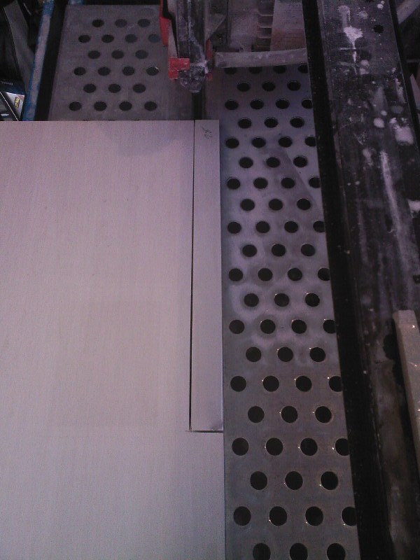

The factories always deny it. My advice - take a tile and run it through your wet saw.
You should see the gap behind the blade close as you get through the tile.
Without cutting right through - take a picture of the closed gap. That's your evidence of poor firing control.
(here's one I had similar trouble with🙂
