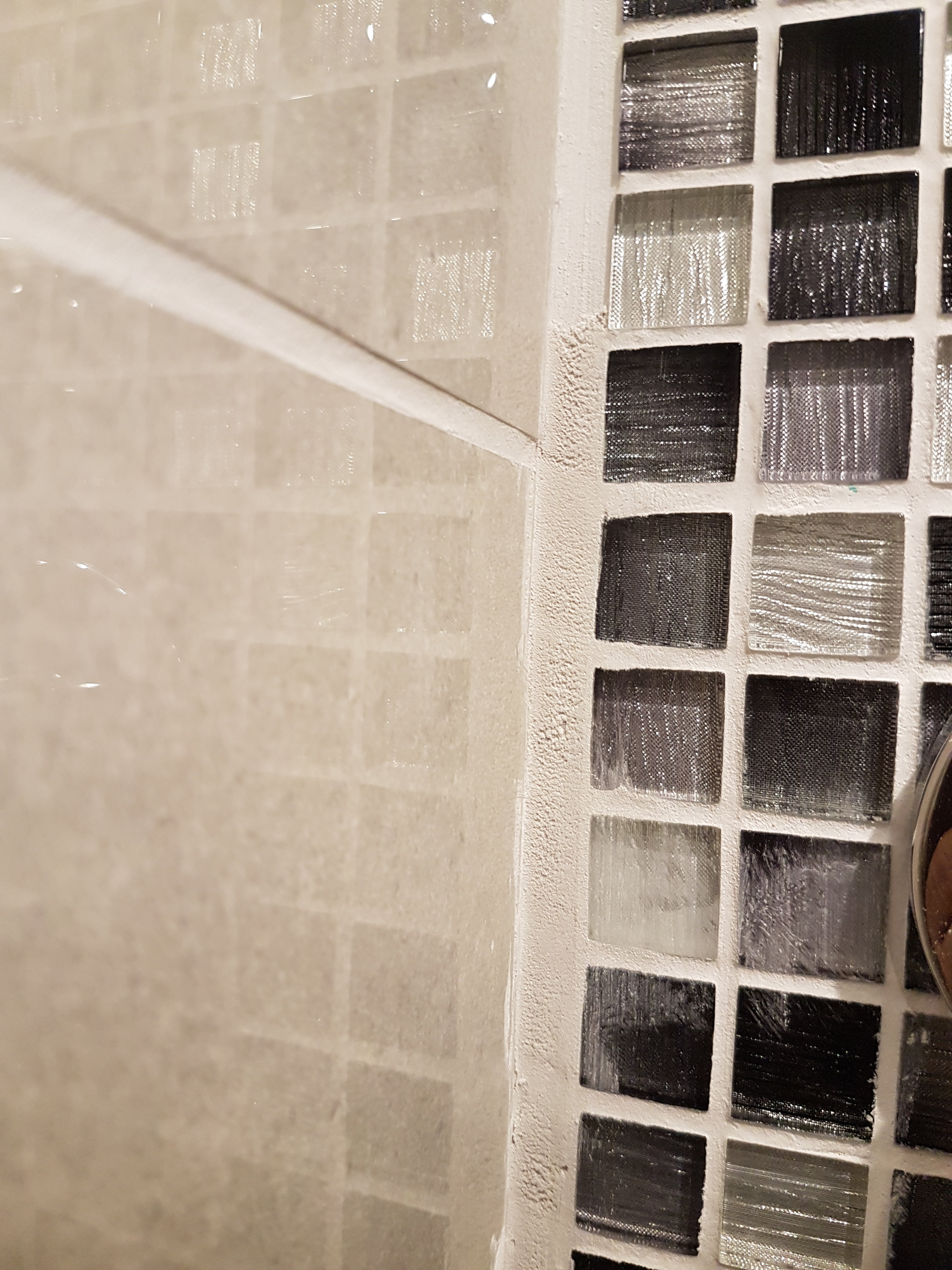

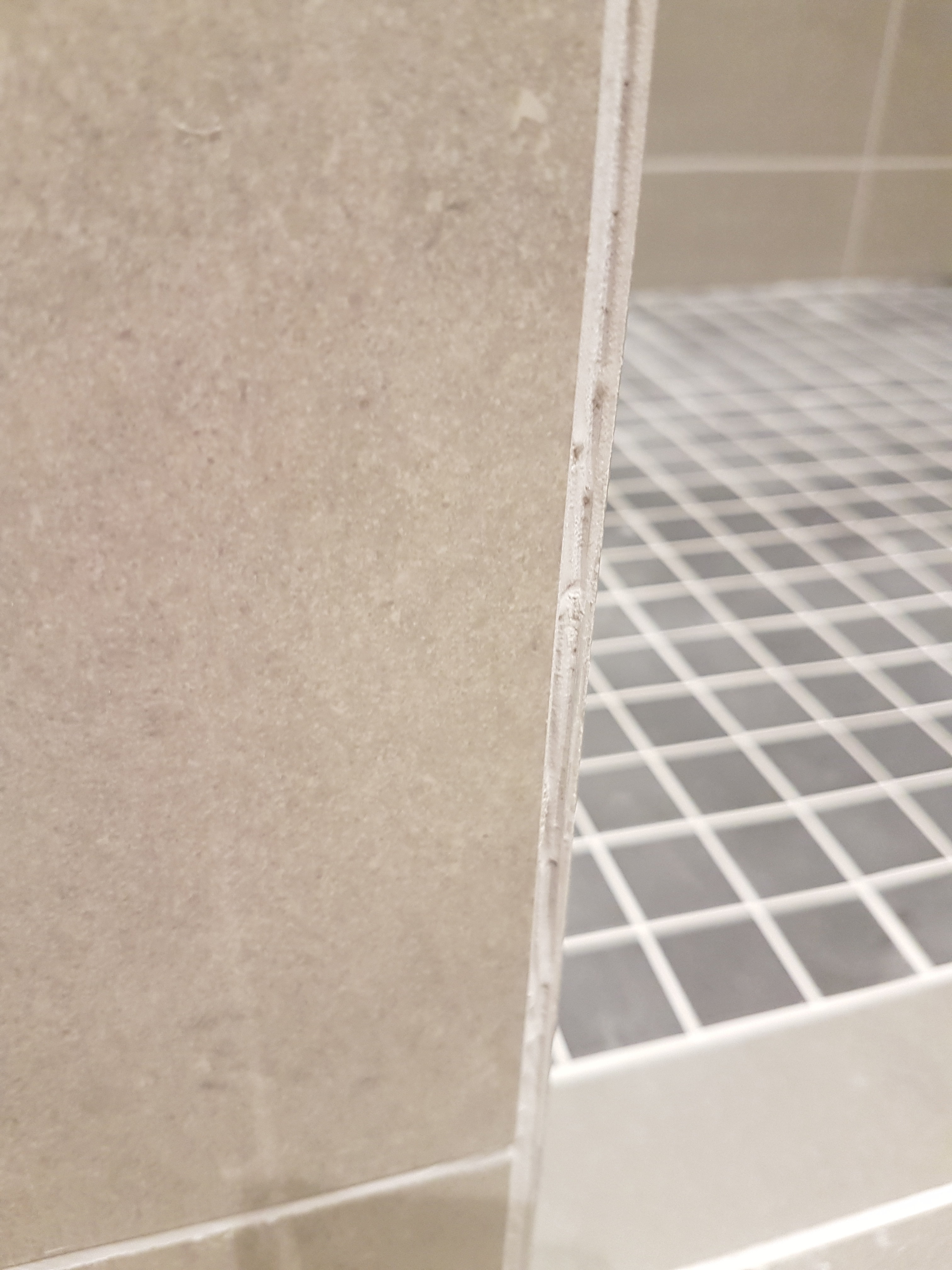

But when an explanation for the cavities and appalling state of the grouting of a 2.38 Metre section of vertical tiling trim is that water would have run down (!) - well, I ask you! The cavities, etc on this trim run from floor to ceiling. At least he and his mate didn't try to say it was my fault because of the materials I'd supplied or that it was because of the width of joint I had specified!
