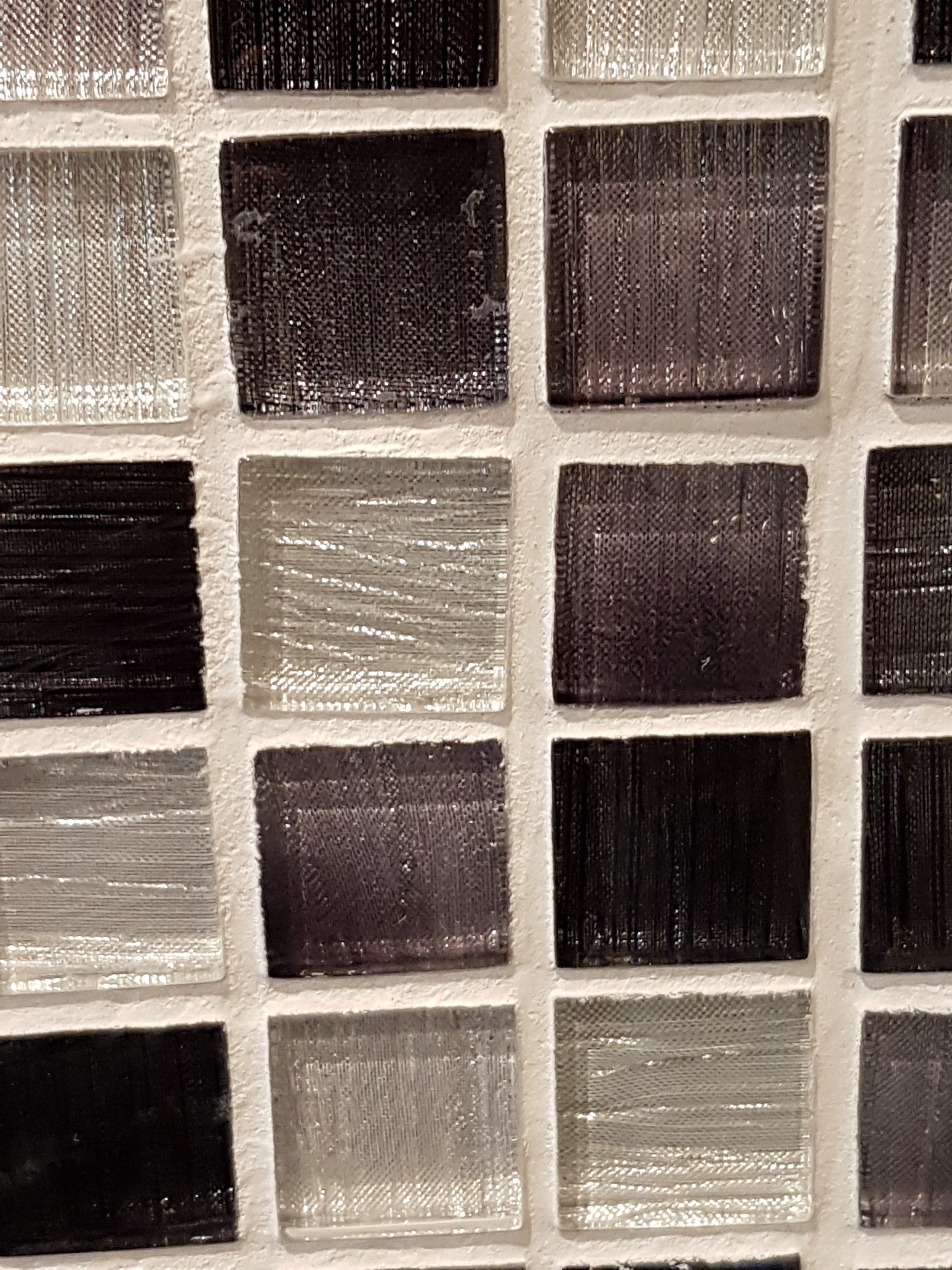

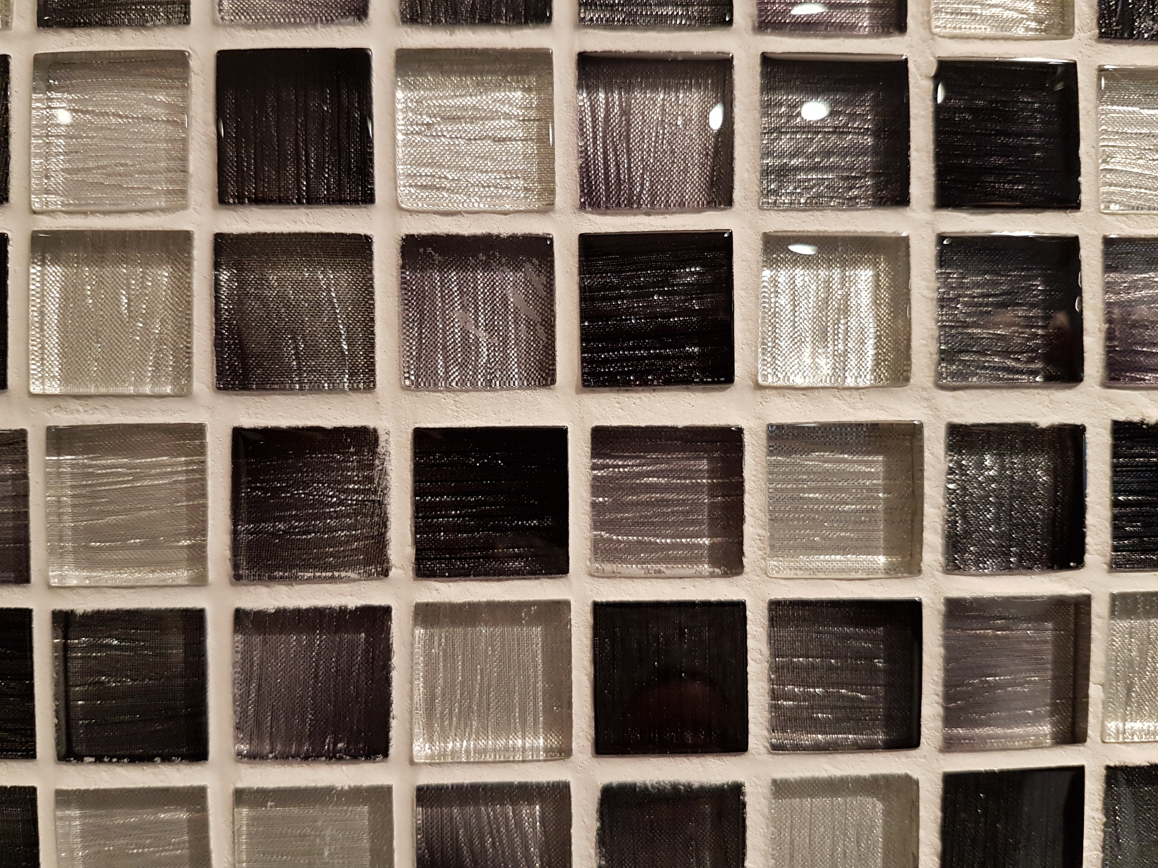

Of the photos posted so far - where are the misaligned mosaics that would not be in a tolerance +/- with BS?

I think we can all agree that the quality of the finish is unacceptable. All areas of the work need a good washdown to remove excess grout and grout haze. Some areas need re-grouting. Some areas need grouting. All internal joints need siliconing.
You will need a professional tiler to visit, as the problems may not just be on the surface. Do you know how the builder fixed (stuck down) the tiles? There may be hollow voids under the tiles.
You may be lucky and get a good tiler to come in for a day and sort out these issues.
Have you paid this bloke?
p.s. I know what you mean about the mosaics. They ARE misaligned. This IS the fault of the person who stuck them to the wall.

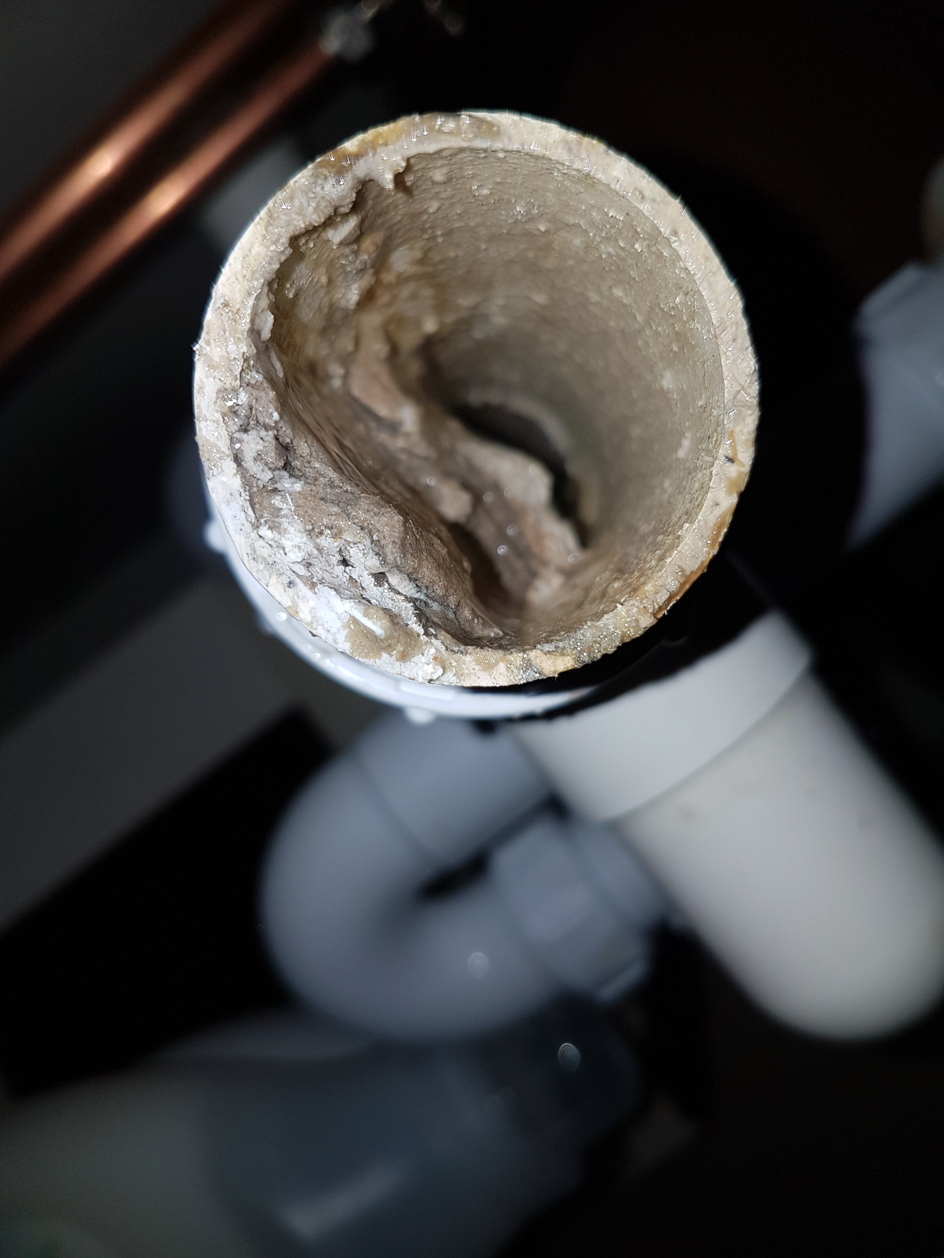

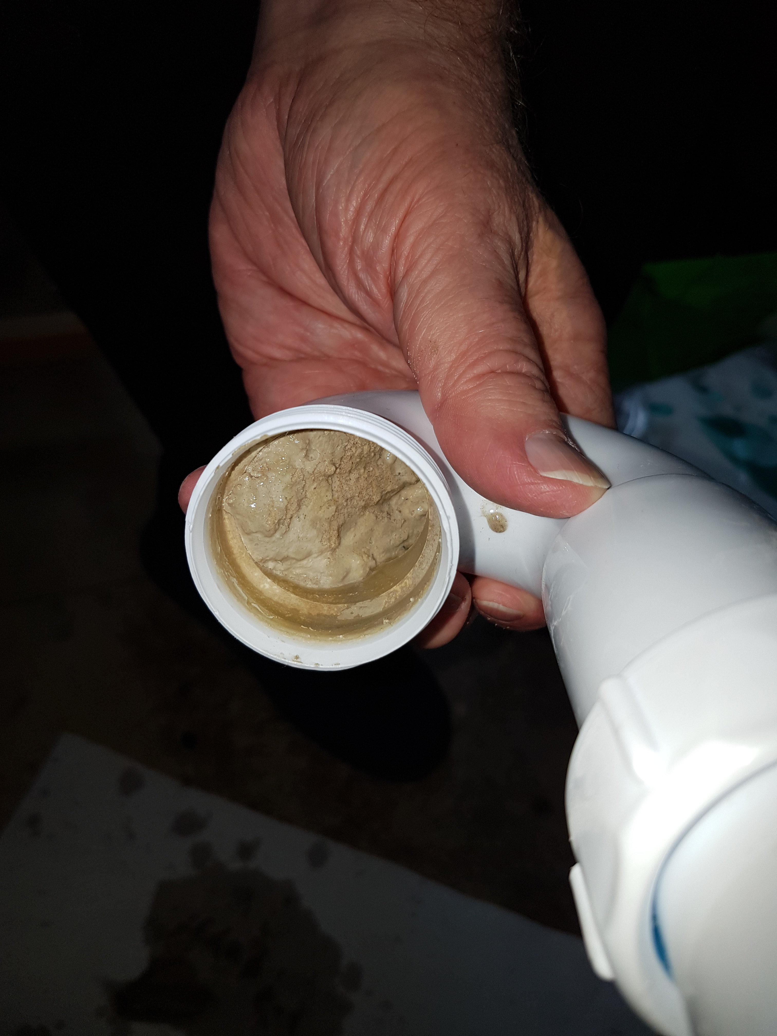

Unfortunately I don't have pictures of the whole bathroom. My mobile phone is the one I bought in, I think, 1990 and it doesn't take photos. Amate had come round to have a look, and he kindly took the photos. And he also kindly cleared out my kitchen sink waste and the drain outside of all the grout and what-have you that the contractor put down the drain. (I have pictures of those, if anyone's interested!).
They are all over the place. I see more every time I look.
You can see the difference in joint width - unfortunately I haven't got round to document properly this aspect of the poor job yet.
I thought I'd also add a couple of pics - one of the fact that he couldn't even fix a door handle vertically, and others of the grout in my waste pipes as well!
