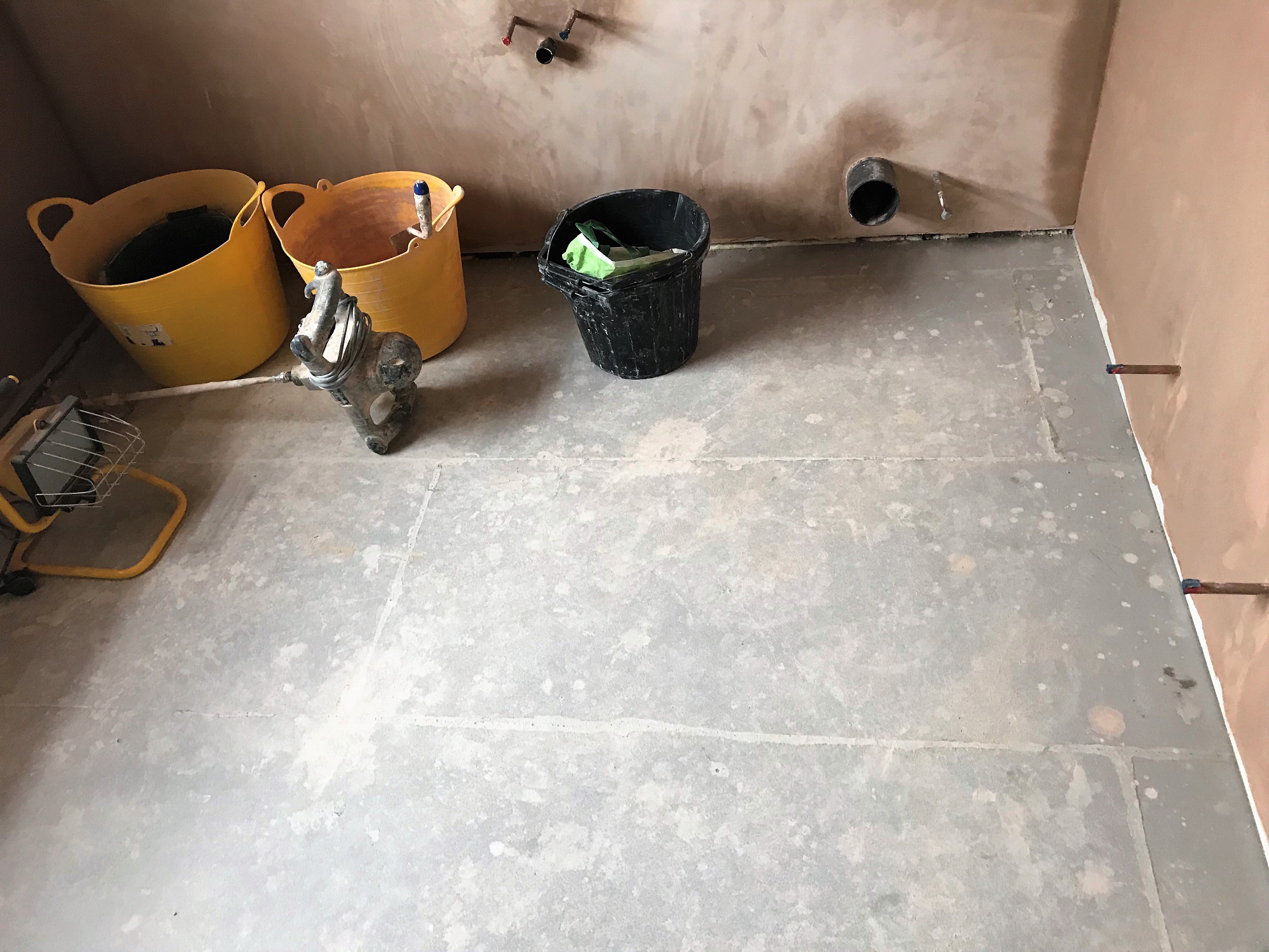

Putting tray in and overboarding the floor tomorrow.

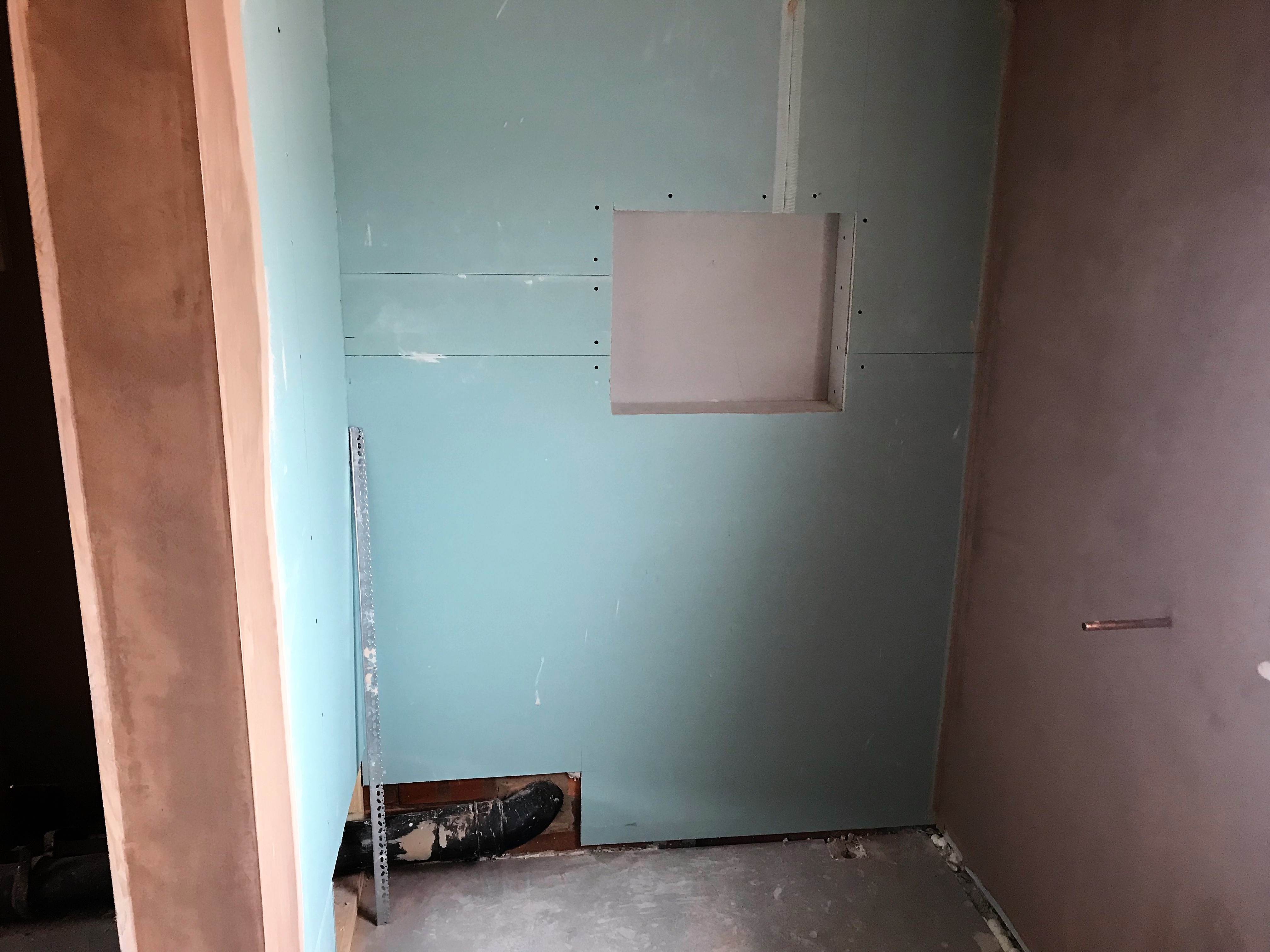

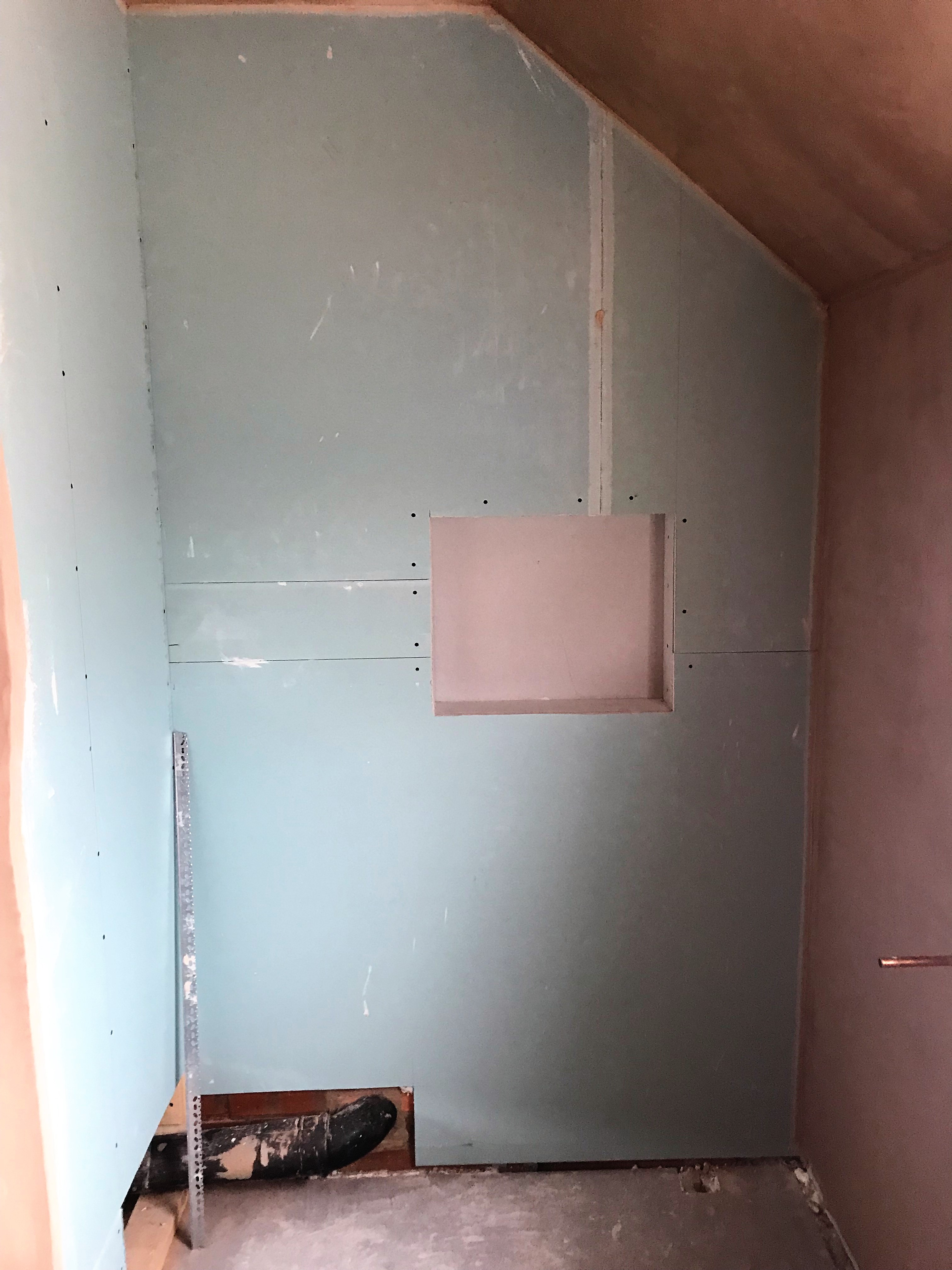

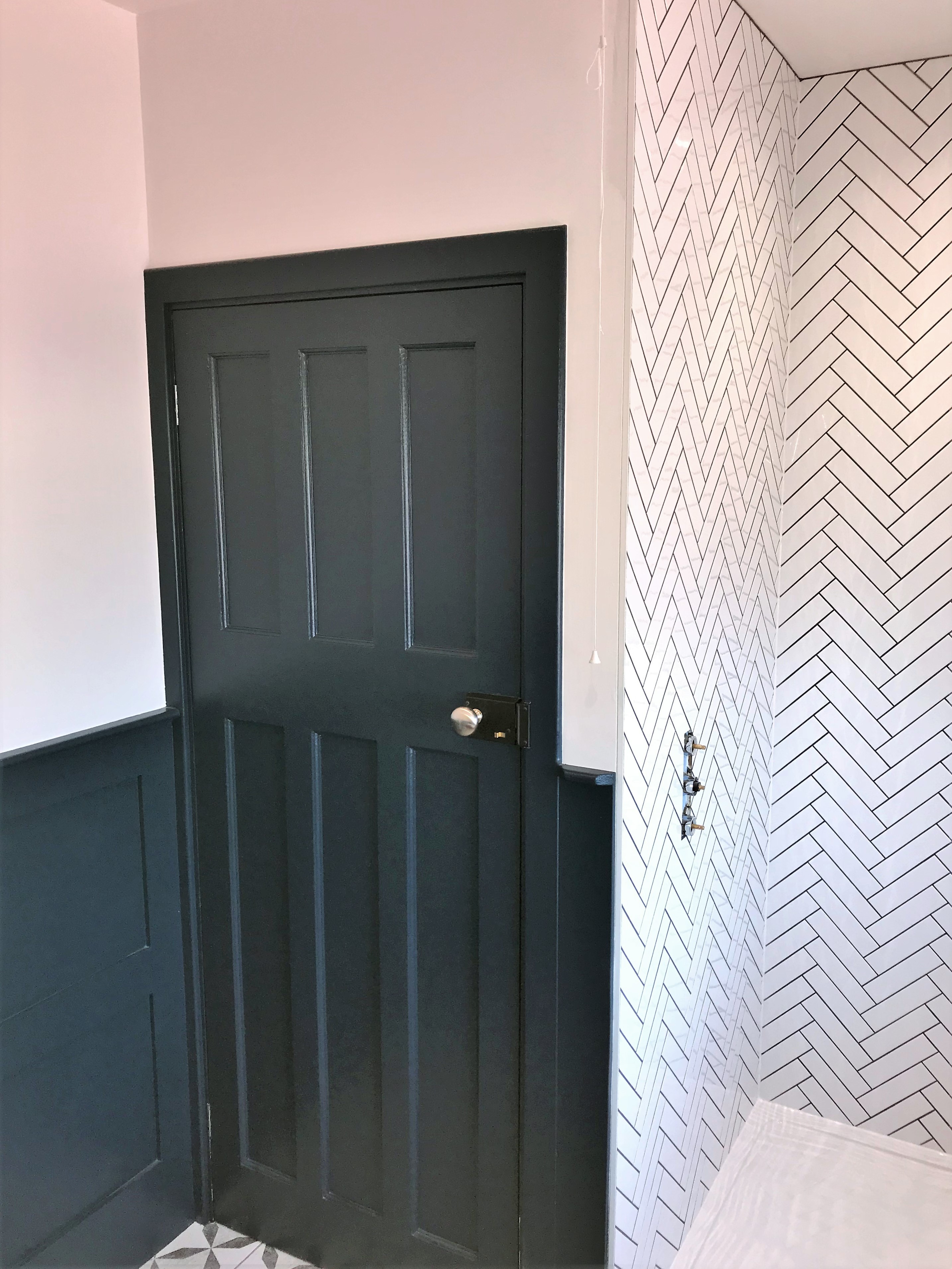

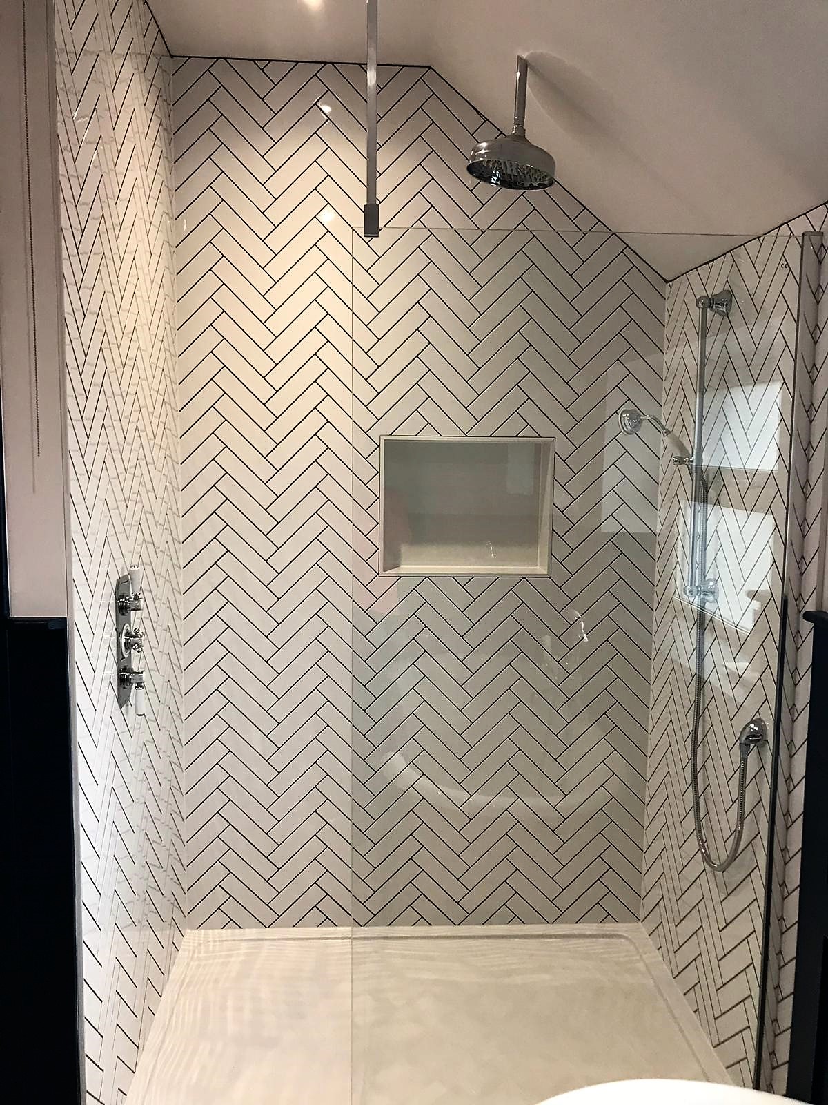

But this is first look at my herringbone challenge and although the 2nd pic looks a bit bendy the walls are bang on flat and plumb. Just a shame it's a sloped ceiling and someone wants an alcove 🙁😡
The tiles are small 2''x 8'' or less but the inside of the alcove will be a solid white gloss tile of some sort so at least it doesn't need wrapping into that.
I did suggest normal tiling with a herringbone feature in the alcove but they were having none of it 😀

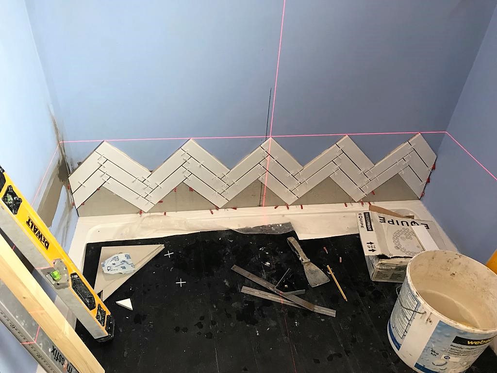

Back off my hols and on to this 🙁

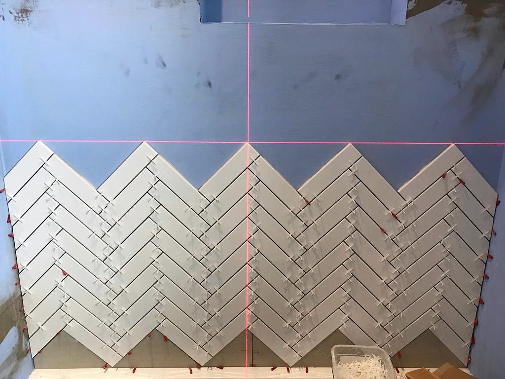

Thought I'd post my (slow progress) as a help to others who are wary of the 45 herringbone wall and share the triumphs and potential pit falls as I go.

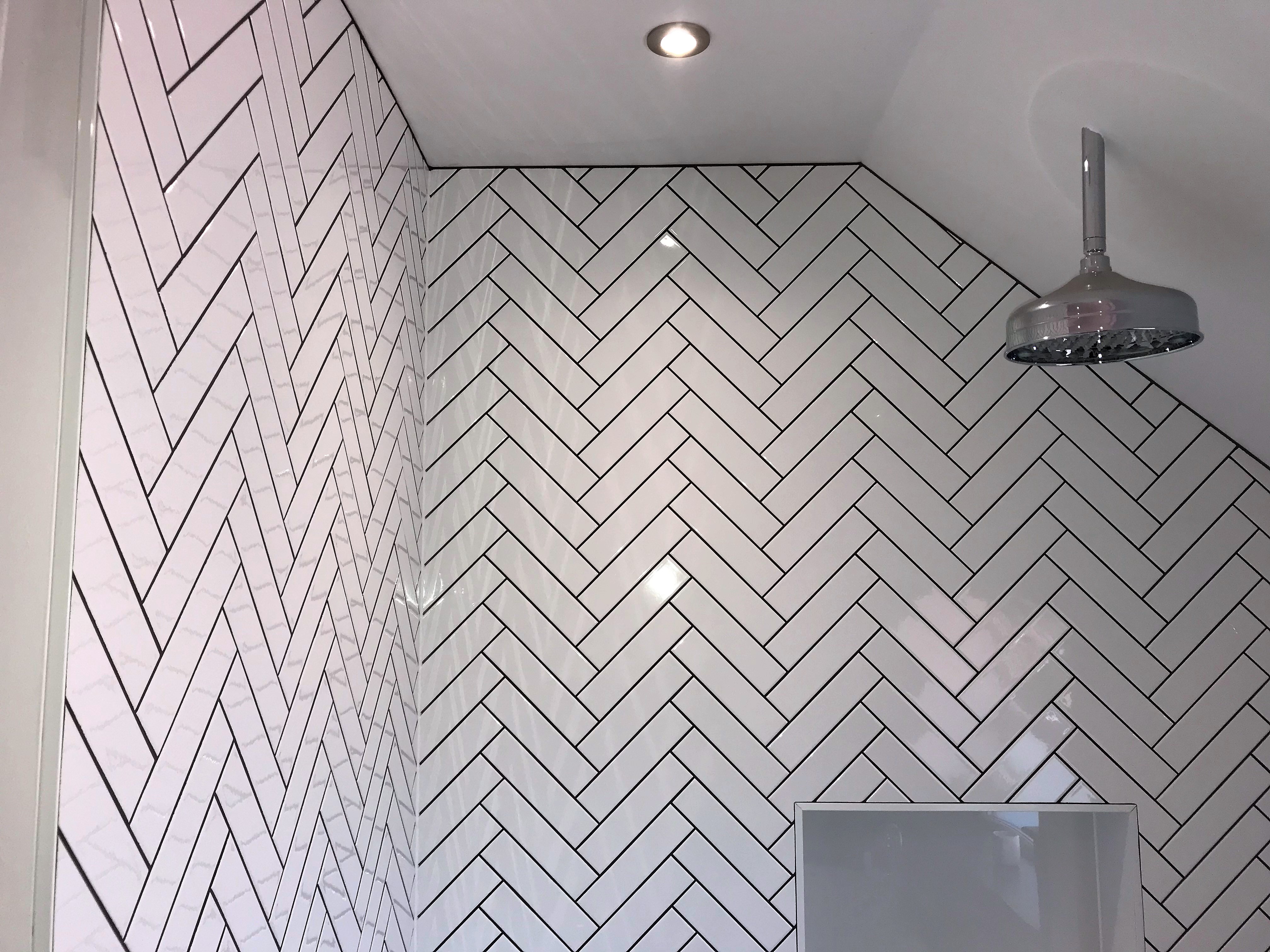

So this morning I worked from home (that's a first) and dry set out on some scraps of Hardi and cut some jigs to help me out. Also using Leemacs' advice I set out for the 1400mm tray by striking the centre line on one of my jigs. Got there after dinner and got a bit done. Going great at the moment but not sure what's going to happen when I hit the alcove, sloping ceiling and the wrap arounds as it makes my head hurt, but all good so far!

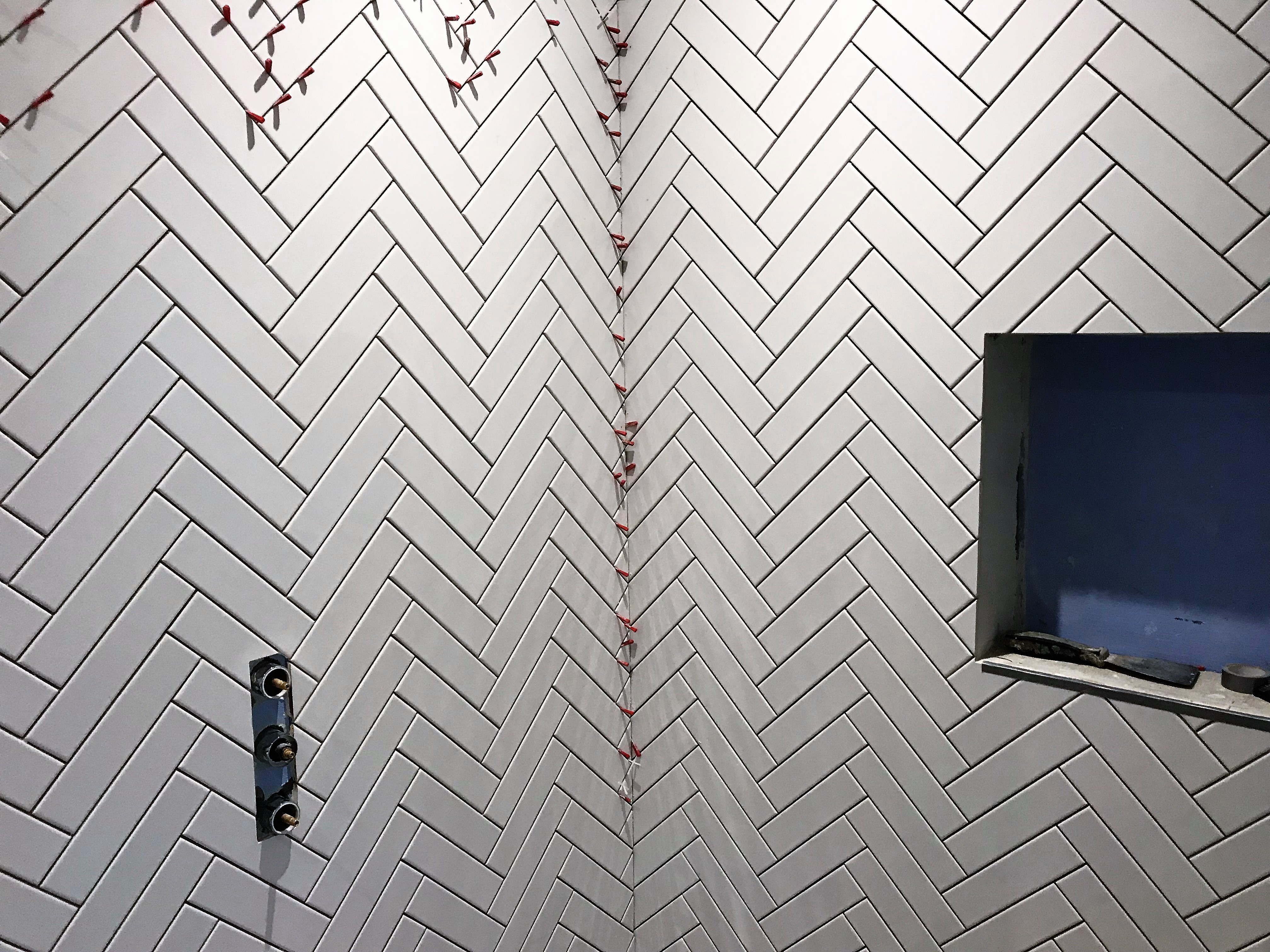

One question - I've been lucky that I get full tiles at each end on this main wall (apart from the 45 corner cut off obviously) So to do a true wrap around I would use the little corner pieces but I'm thinking it would look much better to just mirror it? I know that's not the correct way and with smaller cuts it looks naff, but to the eye would you really notice? Got to look better than tiny triangles - what would you do?
