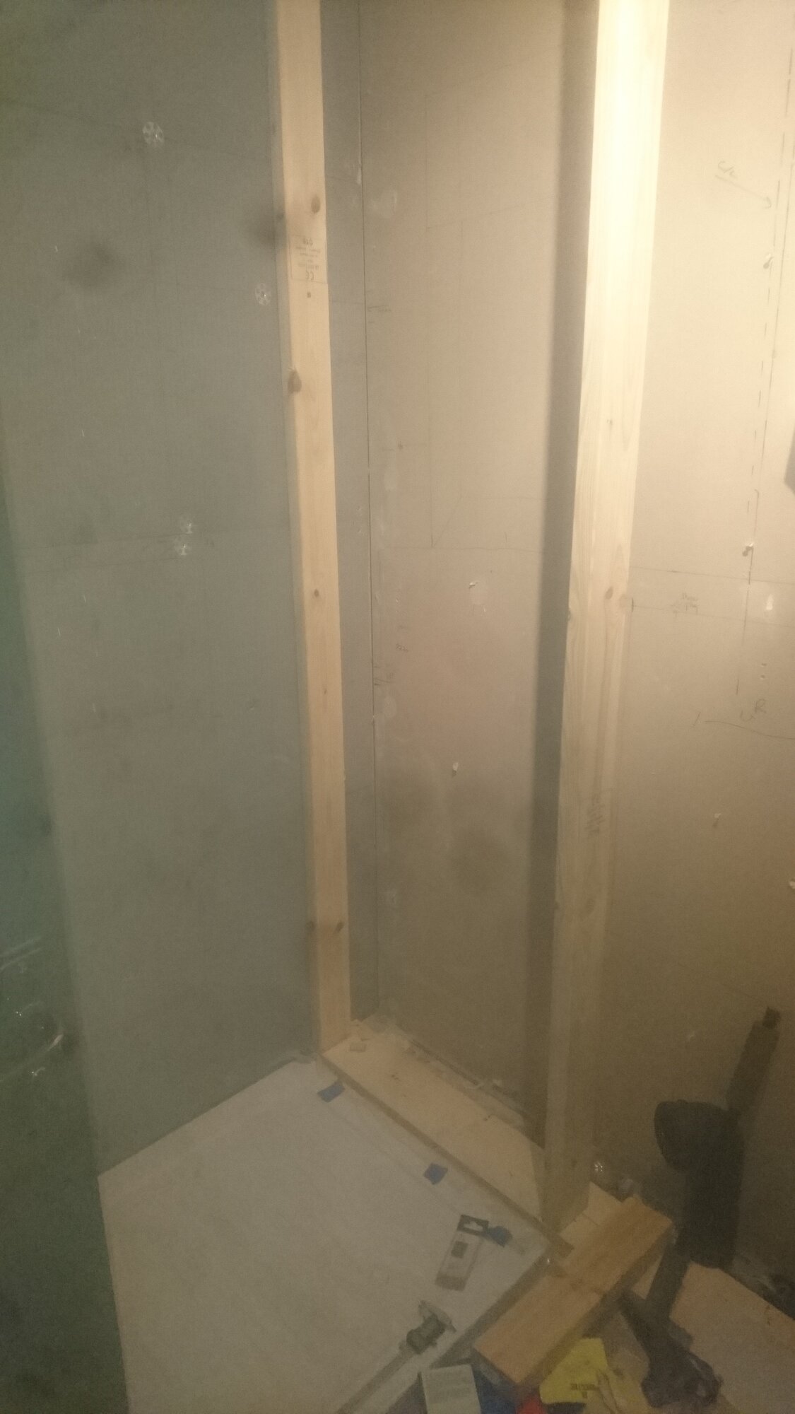

Im in the process of building out this wall that will form one wall of a shower cubicle once tiled.
Id like to build a wall niche into this wall as a feature but im stuck on the best way to set everything out so the niche is centred in the shower tray.
The shower tray is 700mm deep and id be using 600x600mm tiles.
The wall width is about 1780mm and id like the niche to be about 300mm wide.
Would the best way to do this be to start with a cut tile that crosses the mid line of the shower tray and have the niche span across two tiles?
