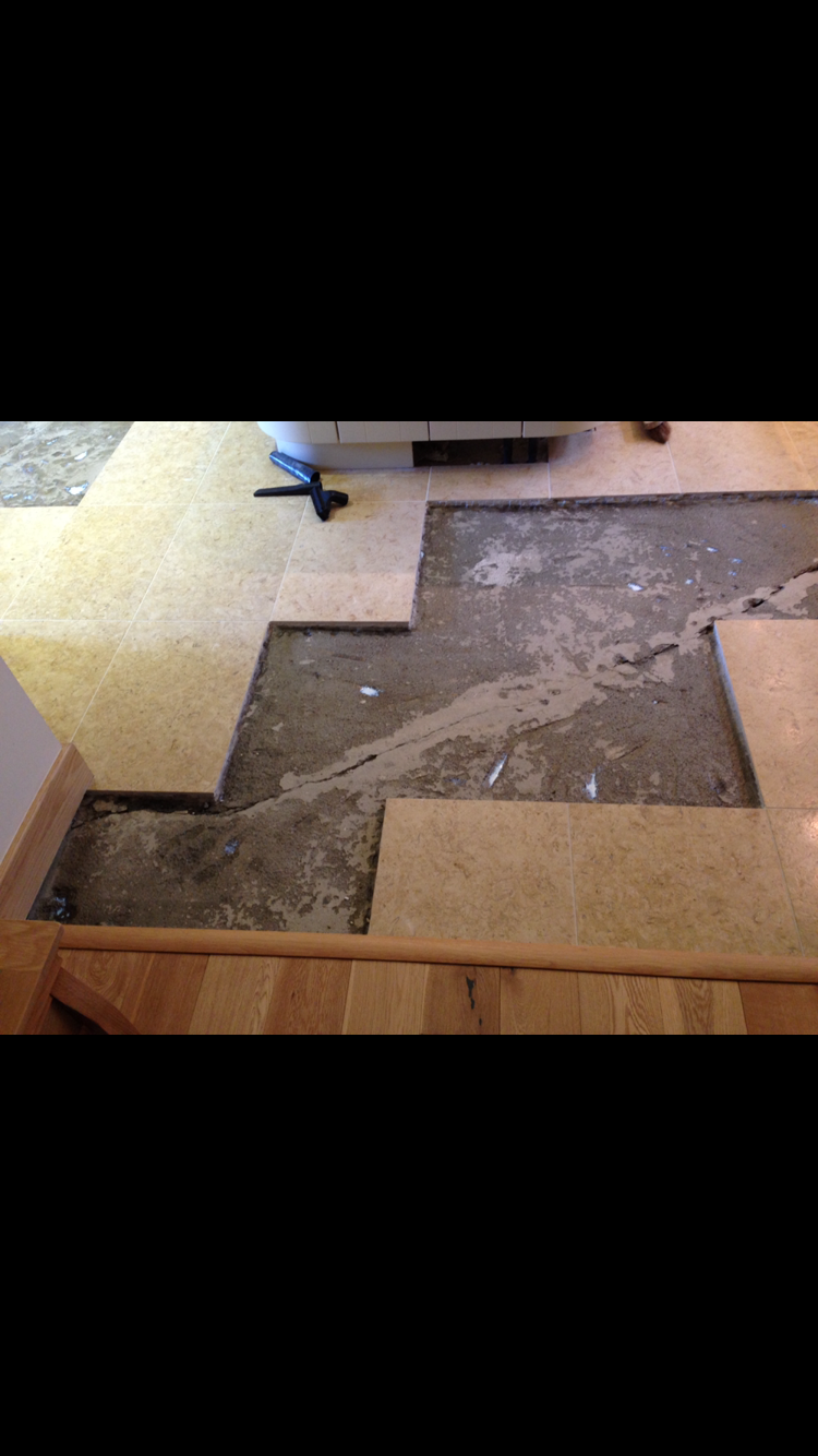

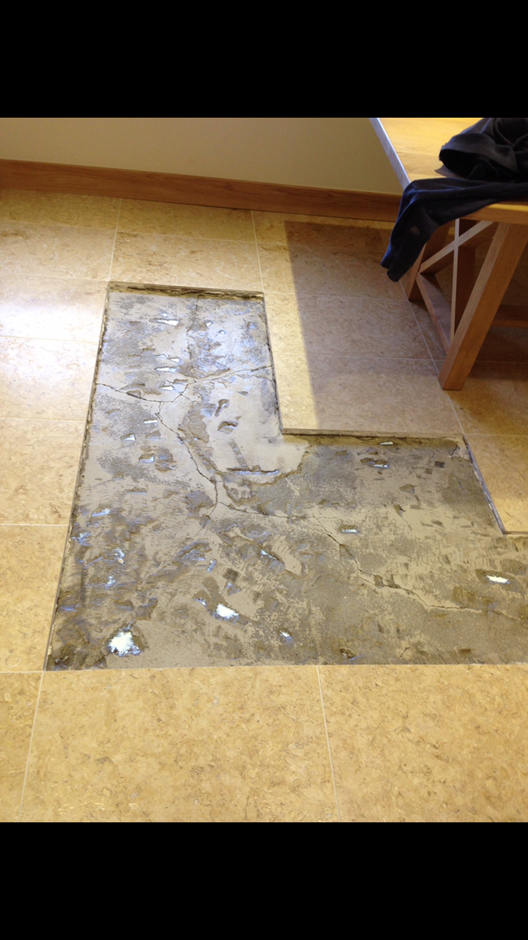

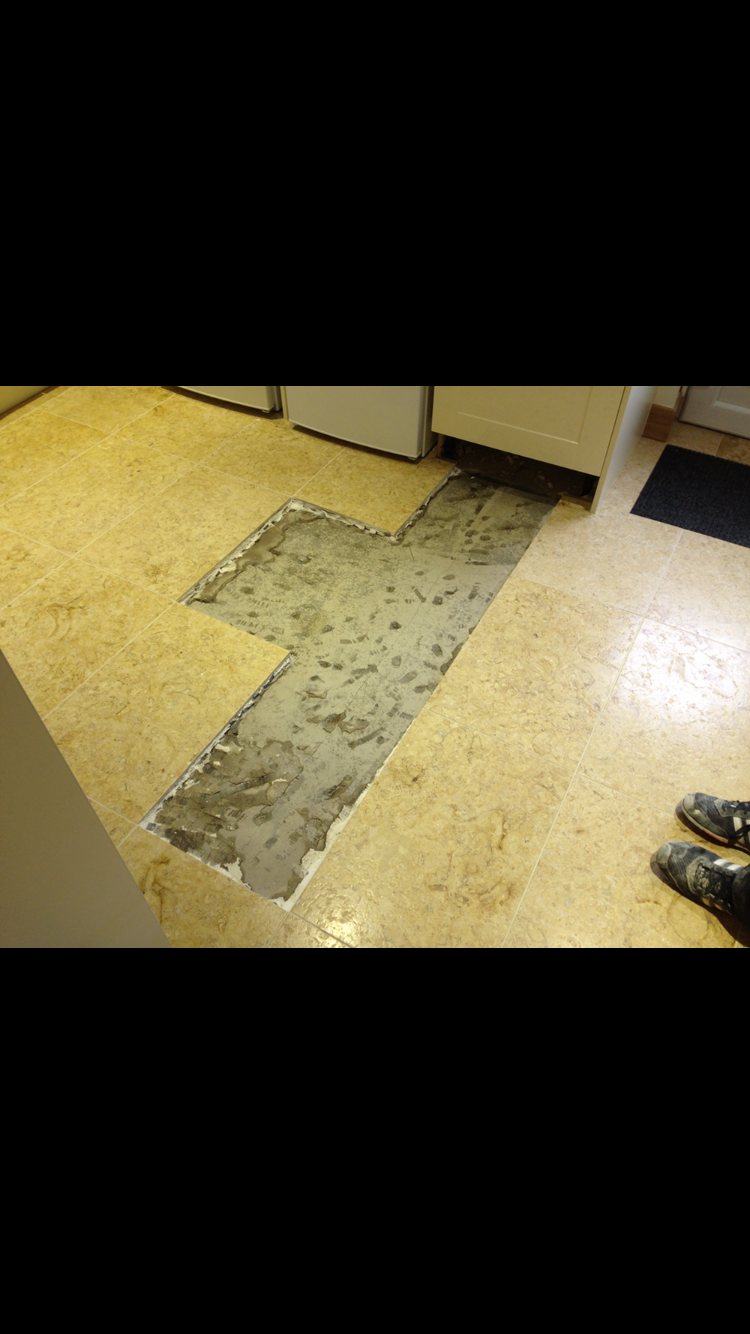

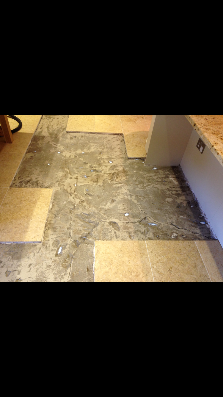

& here's a limestone floor fixed to a screed without a decoupler, all be it a badly laid screed.
I have repaired this floor 3 times, they were told at install to decouple but I'm only a daft tiler, what do I know.
So this, in your own opinion, was a badly laid screed....so maybe that was the problem and not the actual fixing?
