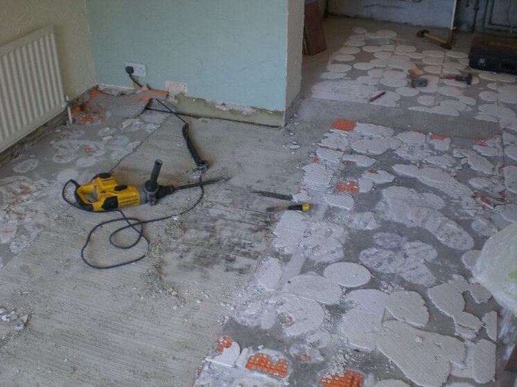

What poor fixing method? (!) Tiler was still adamant that the fixing method was OK. He admitted he was wrong in his choice of adhesive for fixing down the Ditra and offered to cleanup and re-lay the whole thing. On removing - some of the dots were still 'pastey' 13 hours after laying. (2hr rapid set).
It has given me the excuse to break out the SDS Max.... but I've no idea how to clean up properly to give me a decent surface which can be laid on again.
Any way to 'clean' adhesive remnants?

I'm going to be cleaning up the mess myself. What may be the largest problem is that the adhesive used to stick down the Ditra is still soft. All in all a bit of a catalogue of errors.

Seeing as some of the adhesive is still wet and the tiles appear to have come up cleanly I think he may have mixed the adhesive wrong and then adding water as he went along trying to extend the pot life?? Hang just noticed you said the addy to stick down the Ditra is still soft, so have you lifted sections of the Ditra then?
I can see a well used washboy in the pictures meaning it looks like he may have laid a fair few floors like this:mad2: Same old story where someone tells you 'I've been doing it like this for 30 years!' well you've been doing it wrong you 30 years then haven't you!:incazzato:
Yup - I think your bang on there.
Yes to that one too. He actually admitted to using two different adhesives (possibly mixed in places) to stick down the Ditra. One of them is still soft enough to pull up the ditra like a roll of carpet - 2 days on.
The 2nd adhesive (whickes rapid adhesive) has sadly stuck like the proverbial to a blanket. I'm having to chisel the Dirta up Cm by Cm at present.
Nightmare.
On another note regarding the PVA, (it was an Admix from Wickes too - which recommended on the bottle using Acrylic primer for floors instead!) it seems to have given no bonding issues at all. If it had, I'd be very happy as it'd have made all this alot easier to remove.

2nd 3rd or 4th item on this page. Put in SDS, SDS is now a beast, and will rip up anything on the floor. Good luck!
