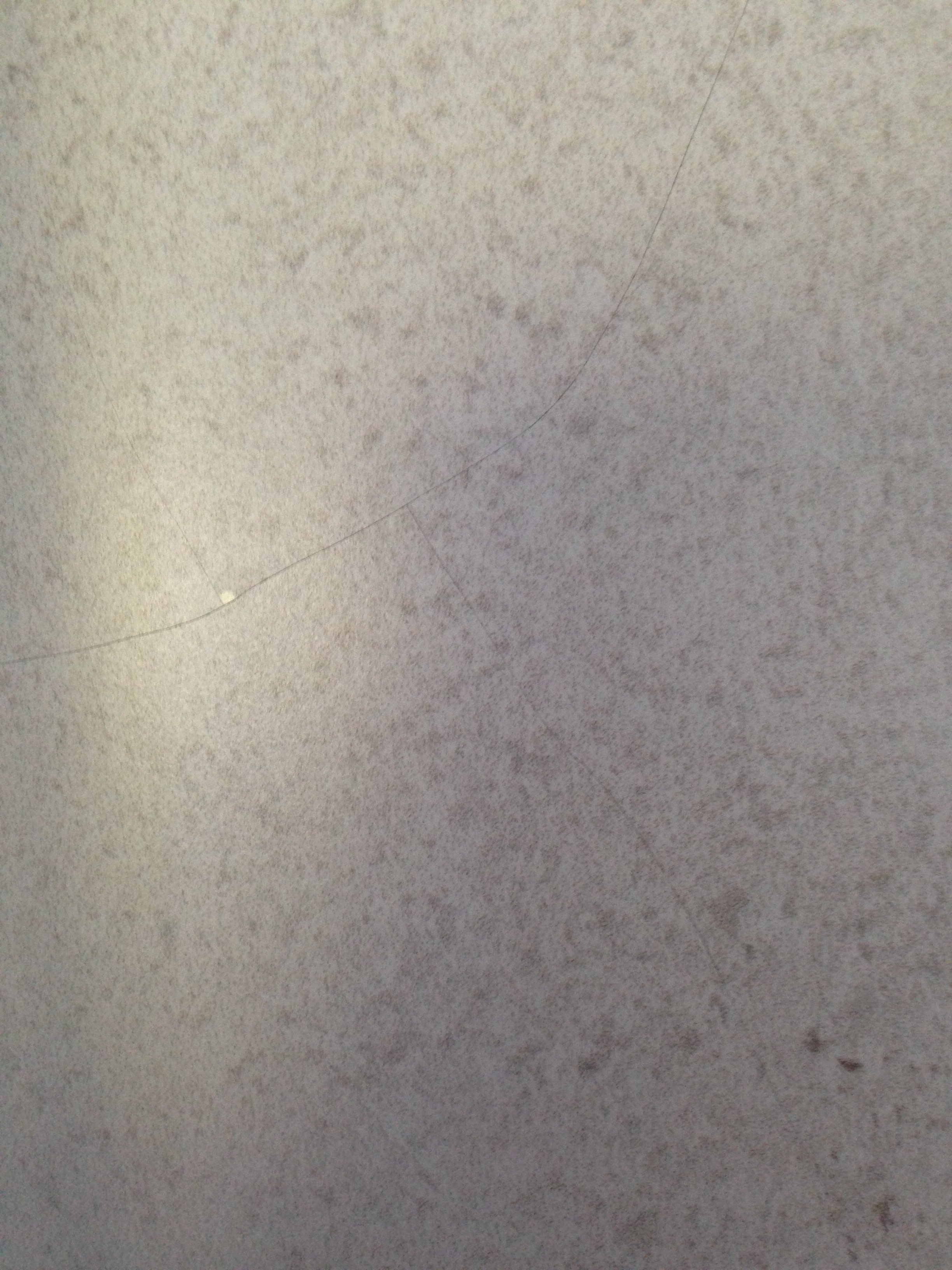

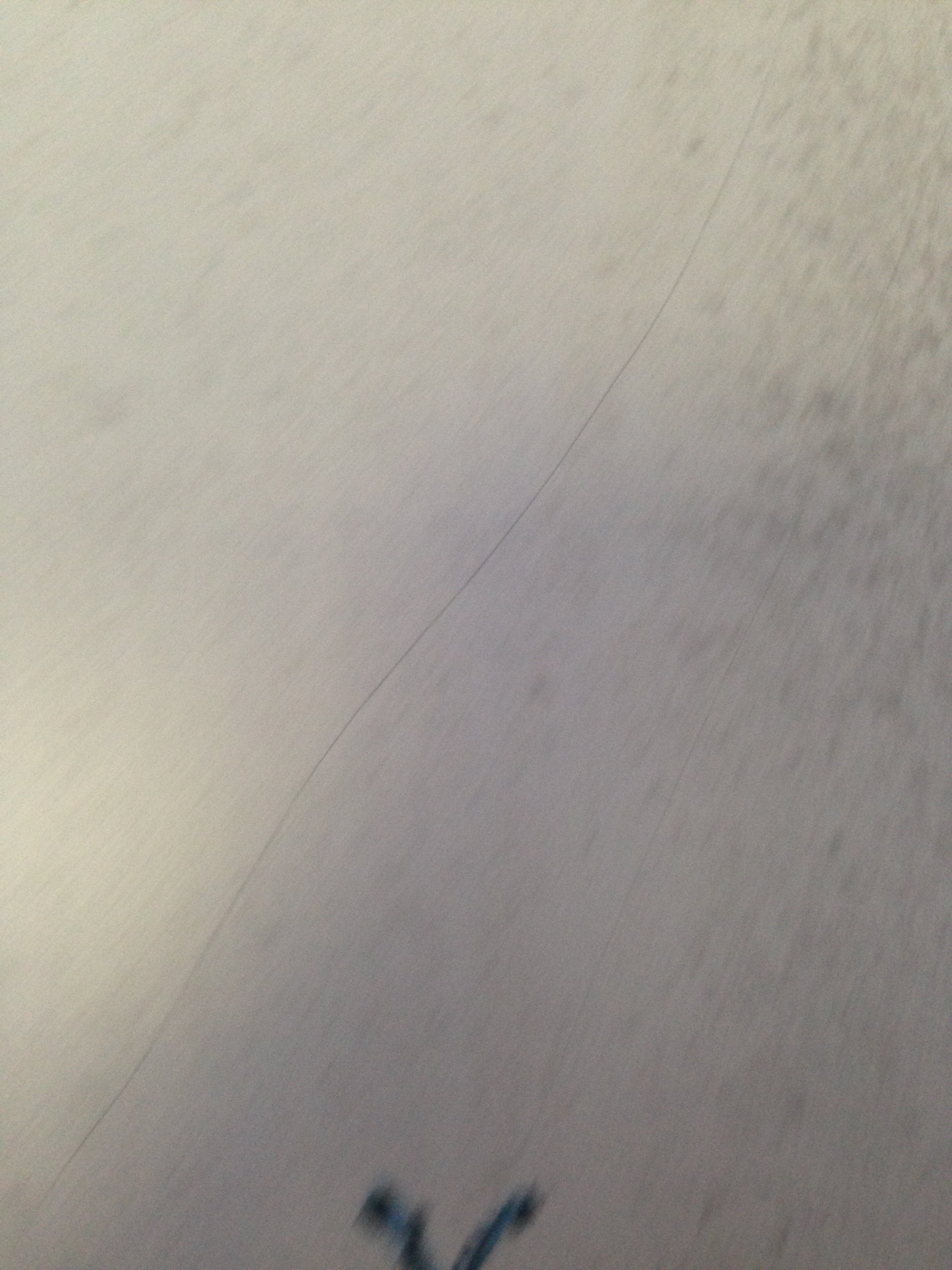

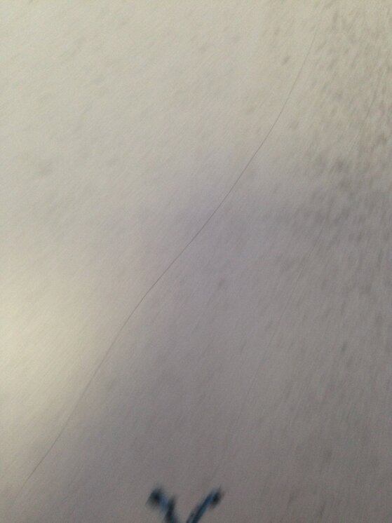

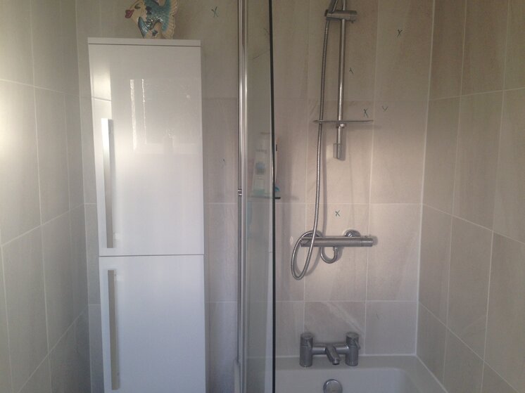

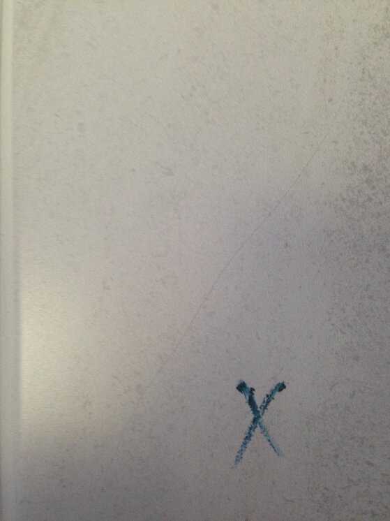

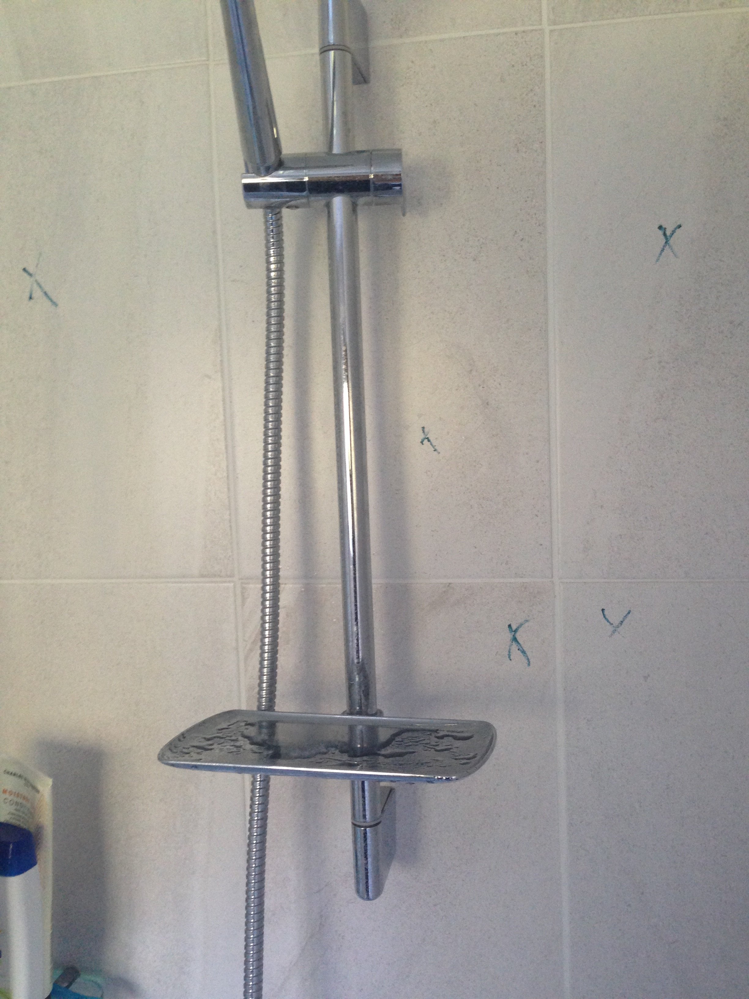

Perhaps you can get some extra light on the tiles and use a good camera to try and show the cracking to us?
Does it run through the grout too? Does it seem to be following a line throughout a while bunch of tiles?
If it does it might be substrate issue that's coming to the surface. Hard to understand how if they've been dot and dabbed but maybe.
Not always. You have to note that B&Q are the largest importer of tiles for the UK. So consistency isn't always great, and they perhaps don't always manage to get the cream of the crop when ordering 500 container loads of one type of tile or whatever crazy qty it is.
You tend to be able to find a lot of feedback about B&Q tiles. Not always good. But the fact is somebody who has a bad experience will tell 10 times more people than somebody who had a good one. And with them selling so many tiles, it's easy to find bad feedback.
I'm not defending them here, some of their tiles are warped, different sizes in the same batch numbers and other shocking things tilers have to try and put up with.
Without seeing the tiles I wouldn't guess myself.
