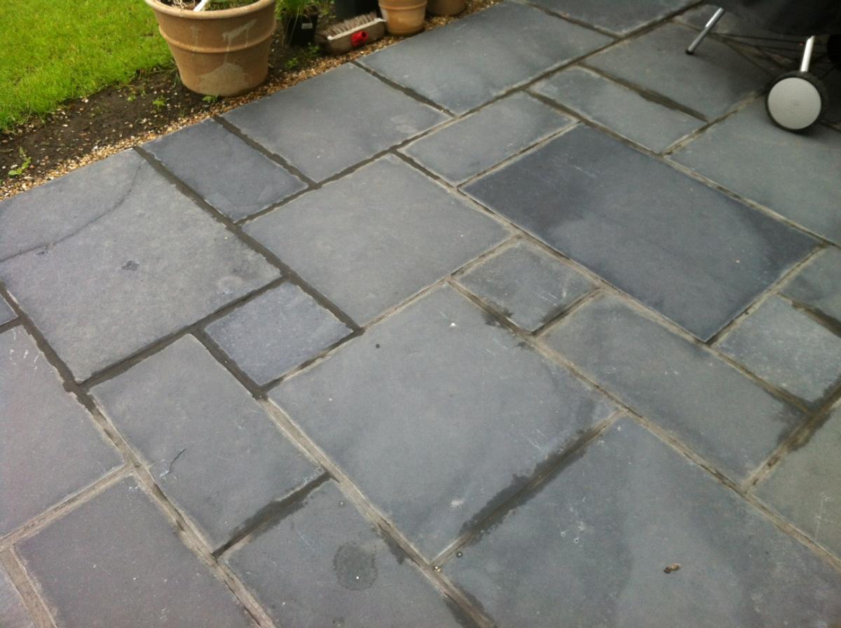

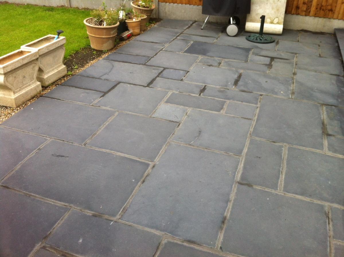

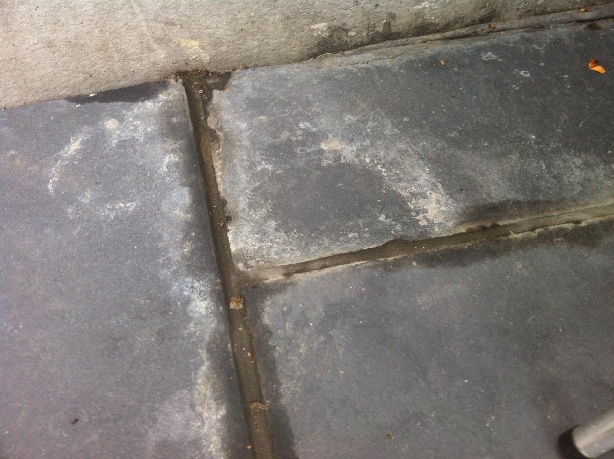

I need advice about the patio, I'm not sure if black limestone and Indian Sandstone are the same things? I had a builder that did new patio and on the contract agreement, builder and I agree to have Indian Sandstone. After a few weeks, I noticed the colour starting to fade out to light grey and I have been using acid based cleaner. I took a close look and realise that my patio is not Indian Sandstone as I guess after doing a few research on the internet. If I was told that patio is limestone, then I wouldn't not touch acid based cleaner.
On the other hand, if the builder use the wrong paving that is not want I want, does it mean I have a good case against the builder? I want Sandstone, not Limestone because I want to avoid high maintenance with limestone!

looks more like a slate than a lime stone .indian sand stone would have done the same cleaned with acid probaly worse indian sand stone is not sutaball for out side patio in the uk the frost will break it down what care info were you give by the surplyer

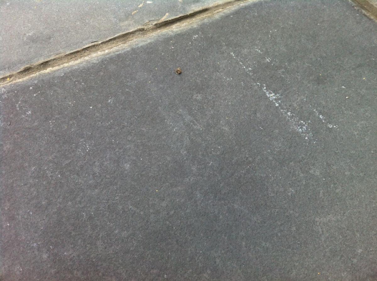

Textured Indian black limestone and the acid had damaged it I'm afraid.
You could try a colour enhancer but it will probs not go back to dark black.
Call LTP and speak to them about a solution, but yes that is limestone.
Thank for getting back to me and I did ask if the slabs is slate and was told it not slate, indian sandstone. It seem to me look like Kota Black Limestone. I wasn't told anything about the care info but was advice to have a sealer on. they didn't clean up the cement stains after filling in the grouts and been raining a lot recently. I wonder if the cement stains damange the patio and edges too over a couple of weeks? I have been trying to get builder come back and clean up the cement stain but he too busy and will get back to me when he is free?!

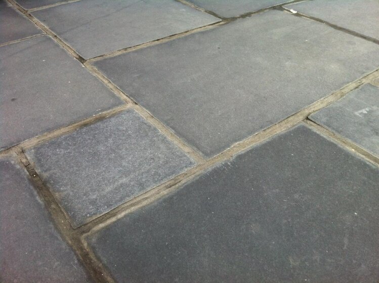

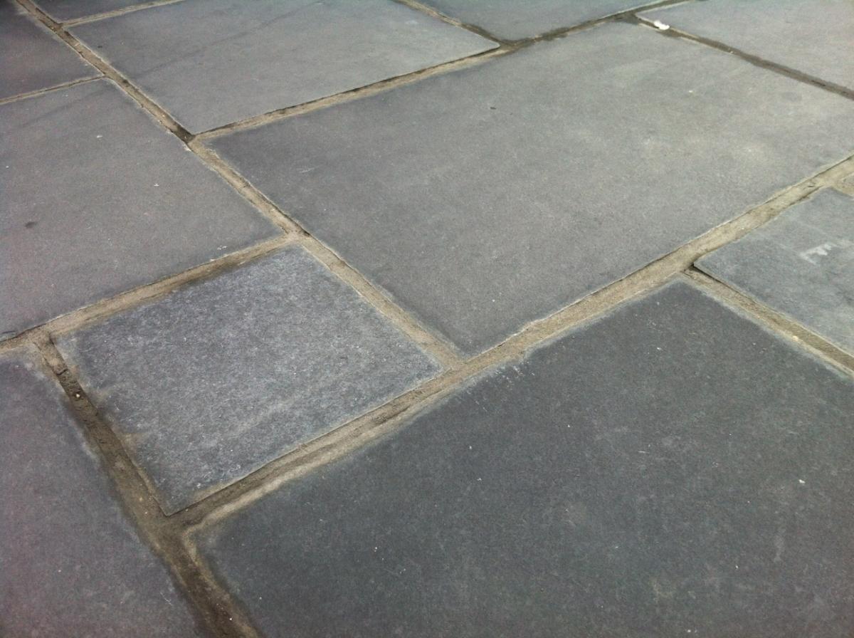

Pls help me, today I had the builder came over after waiting so long. He firmly told me that is an Indian Stonestone but i doubt it. Is there any Indian sandstone are like in thr pictures I uploaded? Need more feedback. Thanks
Is there anyone that can come and inspect the patio, write a report to confirm the type of stone? One person came over and ask if sealer will help, but he recommend to replace the slabs first, then seal and joint grout lasted.
Thanks and how do I prove to the builder that it is a limestone, not sandstone? I did ask him where the invoice, he didn't have it.
You have already found out how to prove that it is limestone - if you put a drop of acid onto it and it effervesces (fizzes/goes white due to small bubbles in the acid) then it is limestone. Indian sandstones will not react in this way.

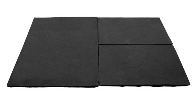

There is a black sandstone called Sagar Black but it looks quite a lot different to your pictures - see below
