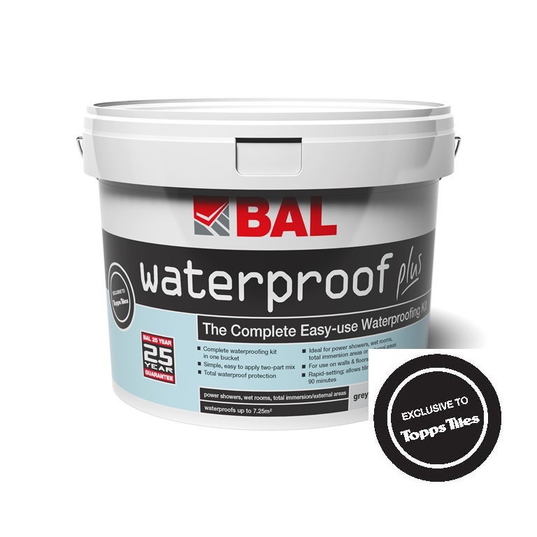

Thought I'd do a little write-up of a new product I just used.
BAL waterproof plus.
BAL Waterproof Plus | Tiling Products | BAL Adhesives
It comes in a huge tub, and costs a shade under £100 from TOPPS on a trade account.
(I think its a TOPPS exclusive product)
Anyway, you get 2 pouring 2.5l containers of liquid, 2 bags of 2.5kg powder, a roll of scrim tape and a scraper.
It gives you enough to treat 2 1m x 1m shower cubicles (3 walls) or probably 1 whole wetroom? (not sure on this, I did 2 showers easily)
The mixing is fairly straight forward, but as you have to mix half of it at a time, between coats, it might be better to give you 4 bags of powder. It was easy to mark up the liquid, I measured the side of the container (16cm) and divided it by 4 to give 4 4cm depths so I could pour out quarters at a time.
Really easy to mix if you follow the instructions and use an electric mixer, it does come out rather runny!
Spreading it on is a doddle, initially I was using the spreader in the kit, by the second shower I was using a plasterers trowel to spread it nice and quickly. Covers really well, dries very rapidly, and leaves you with a very gorgeous looking matt black grippy surface.
Customer liked it so much she asked if I could leave the shower area like it! (she was joking I hope!)
Anyway, thumbs up from me. Its filthy stuff, so deffo mask up any shower trays or taps, and wear gloves!
