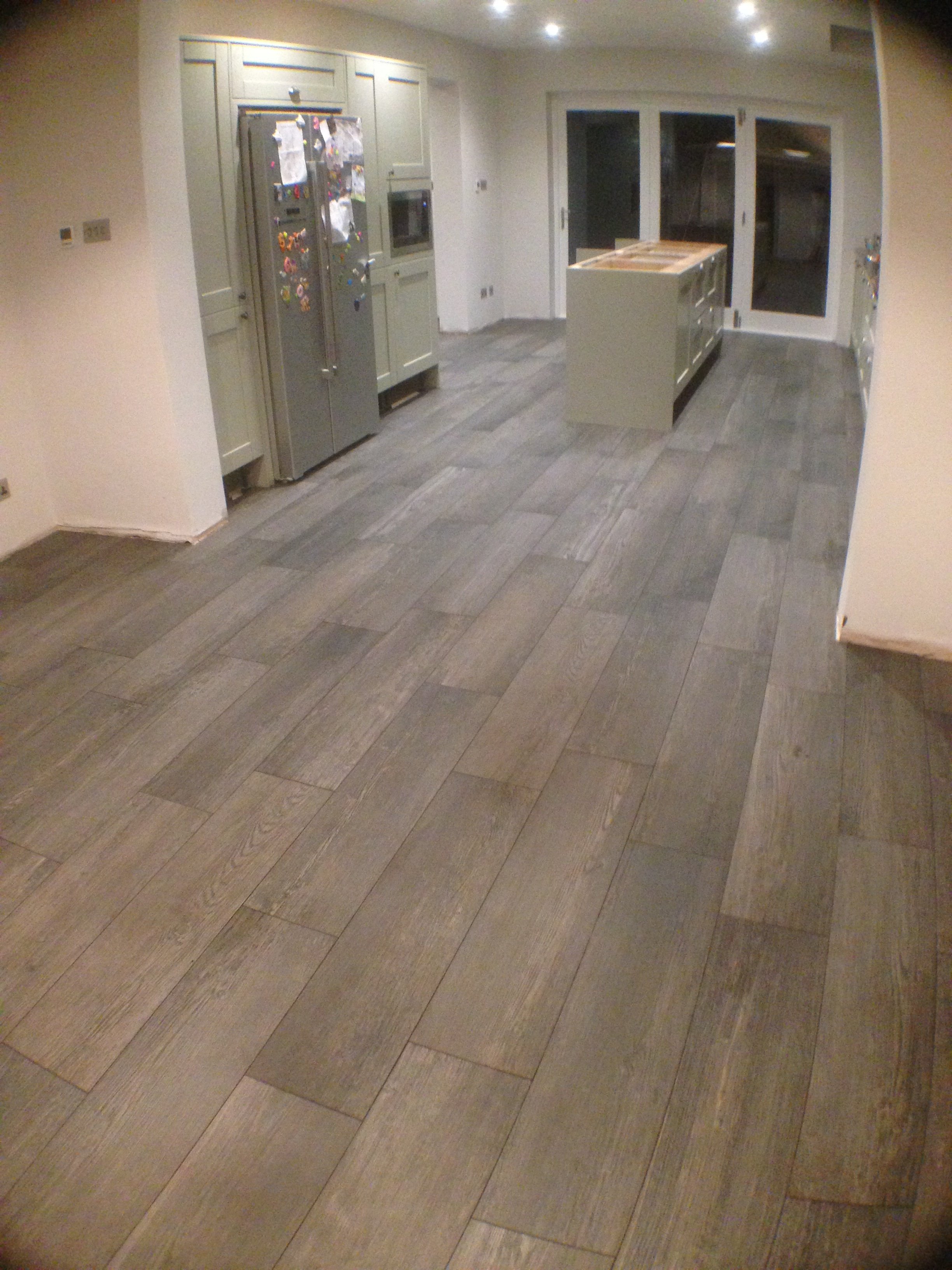

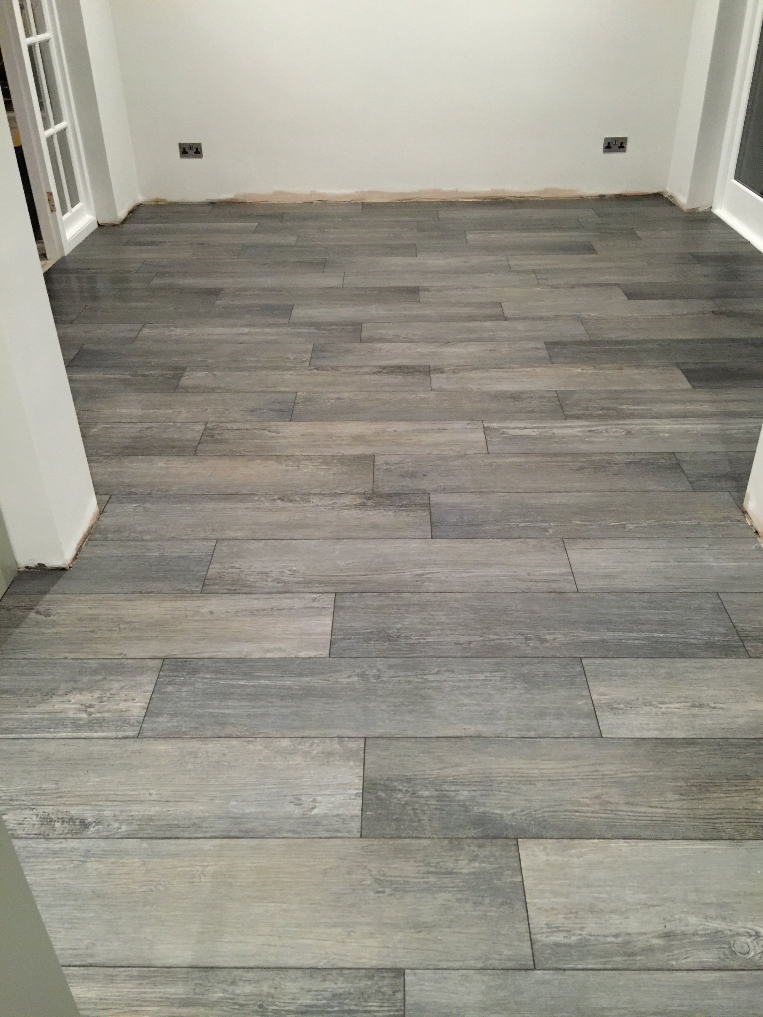

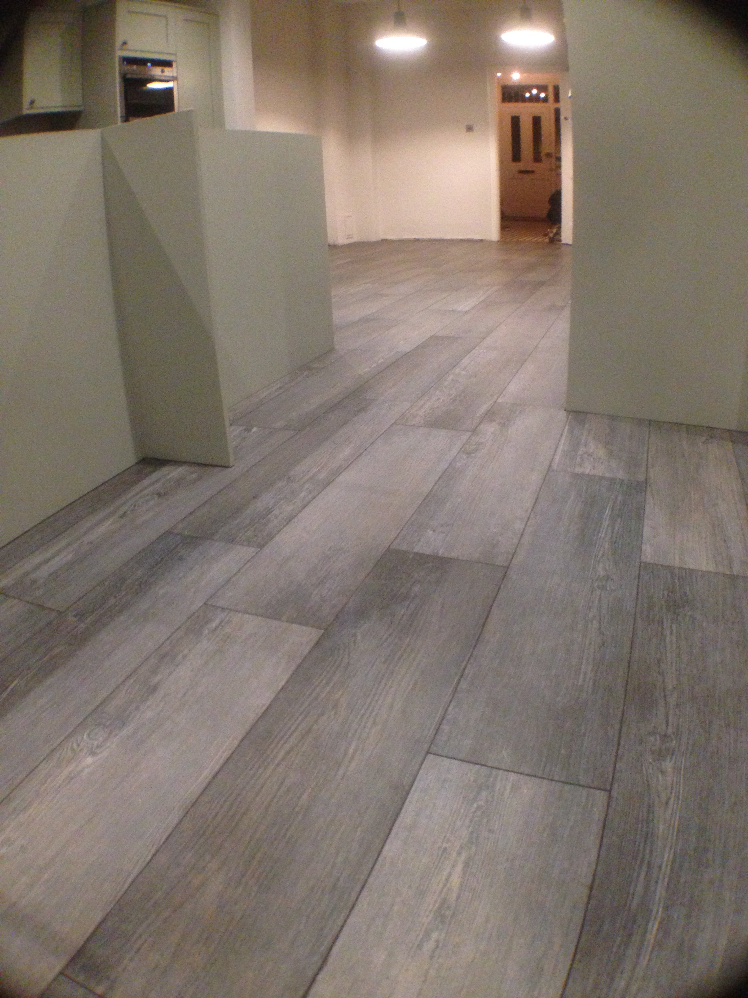

Been asked to lay some wood effect plank floor tiles, I've previously laid these in a brick bond layout in a very small kitchen, however in the pictures on the suppliers website they appear to be laid randomly and this will be a much larger area. Any thoughts on the best layout for a kitchen with an island into the open plan dining room and up 1 wall.
Lay them exactly like a timber floor!
As long as they are straight enough!
Random broken bond. Use your off cut from row to start the next.

Timber floors APPEAR to look as if the off cut begins the new row.
(Because they generally do nowadays!)
And besides, when was the last time you saw a new timber floor laid directly to joists?
Every timber plank floor I've see laid in recent memory is overlaid on a boarded floor, or screed.
I'd agree that random bond is better looking though!
That's cos it is. Haha
Imo there is nothing more unsightly than an imitation plank floor laid like a tiled floor, ie half or quarter bond.
Surely the whole idea of a porcelain plank floor is to look just like a timber floor, else why would the good quality ones be textured just like timber.
I'm not digging u out impish, honest, but c'mon, you knew what I meant didn't you.
