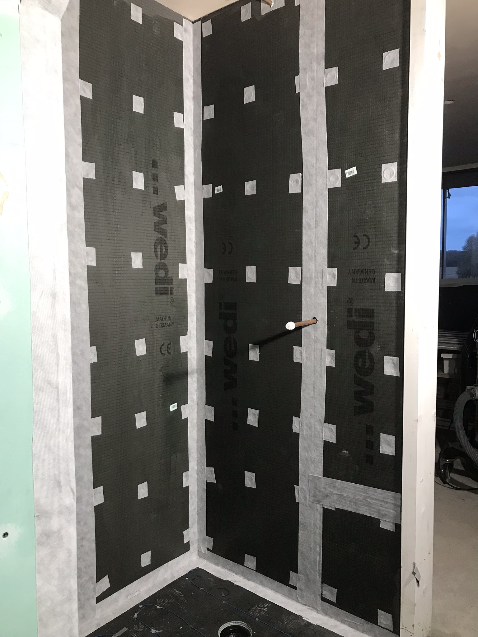

That method will work, but it’s not best practice to be honest.
You’re better off fitting all wet areas with a Wedi style board, which predominantly already waterproof. The only area that will need waterproofing are the board joints and transitions, and over the top of the mechanical fixings.
No other board is water proof and will require full tanking.
Wedi style route is by far the most efficient in my opinion.
You can waterproof between the boards with Wedi 610 adhesive sealant, and just apply waterproof butyl tape in corners and over fixings.

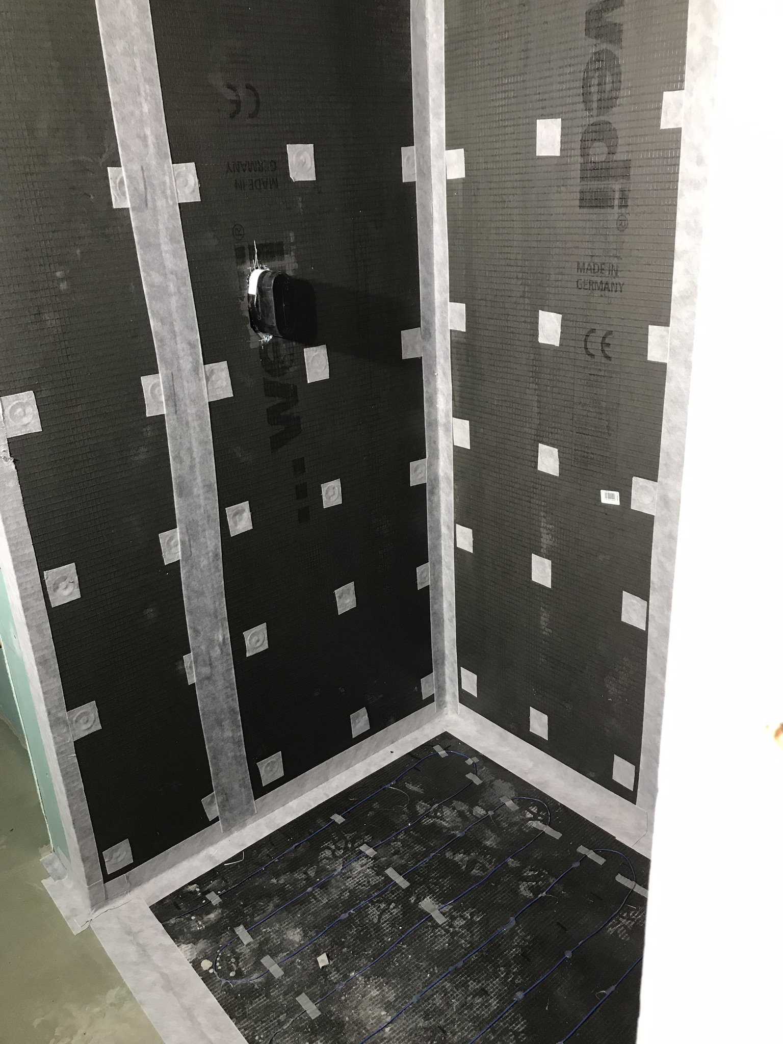

Well that looks good. So i could do say 1000x1000 wide in the corners of the quadrant area. I see the tape also sticks to moisture resistant pladterboard. Should MR plasterboard be used on the rest of the room or can i get away with standard board as long as wedi is used in the shower area?
Obviously theres a lot of vapor in a bathroom so i was thinking MR plasterboard should still be used in other areas? Maybe im going over the top?
When it comes to protecting your bathroom and rooms below, I’m not sure you can go over the top tbh. Of course MR board is a better option.
In a perfect world, I’d do whole room in Wedi style boards.
But it’s rarely my budget that I’m playing with.
