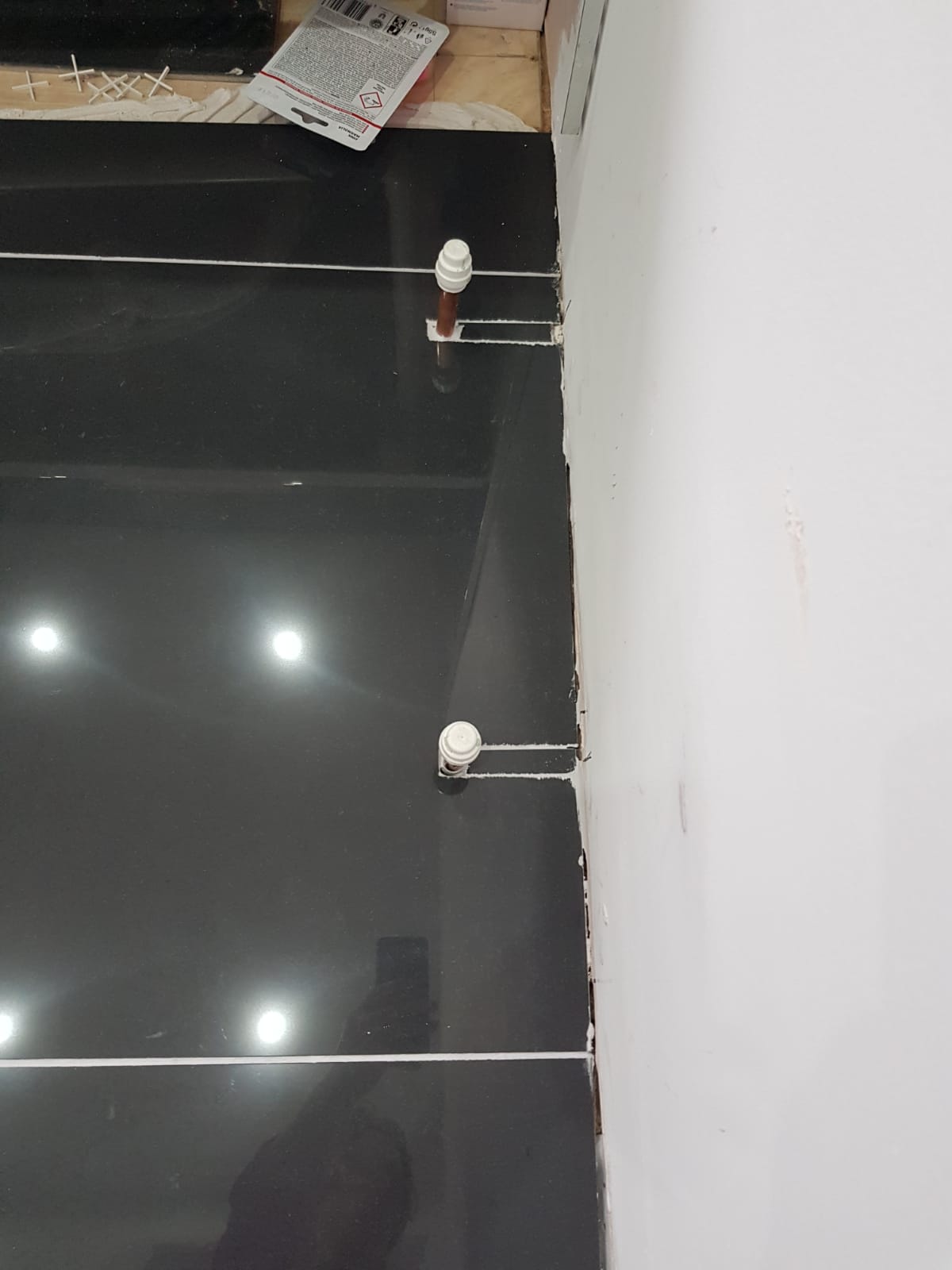

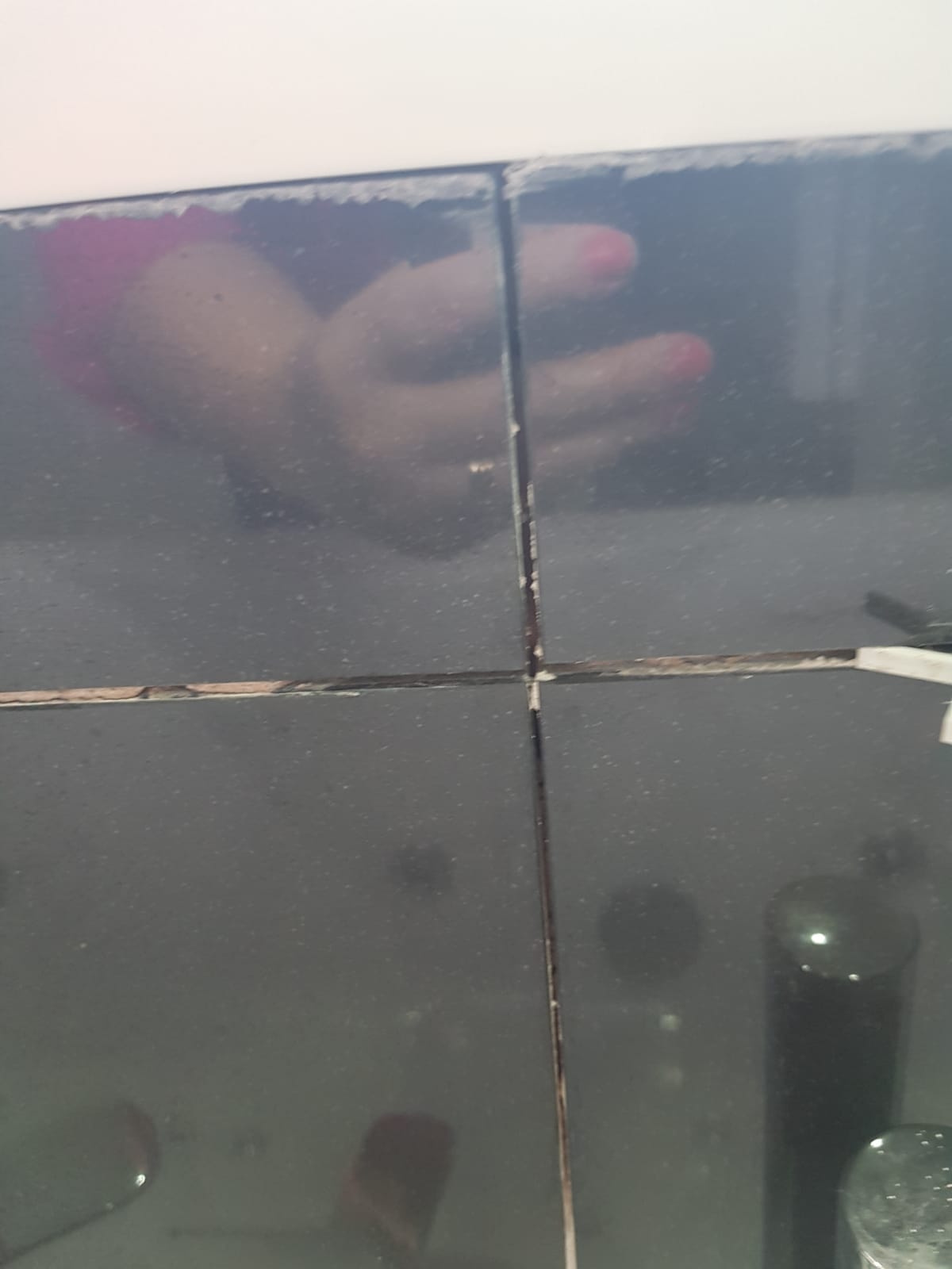

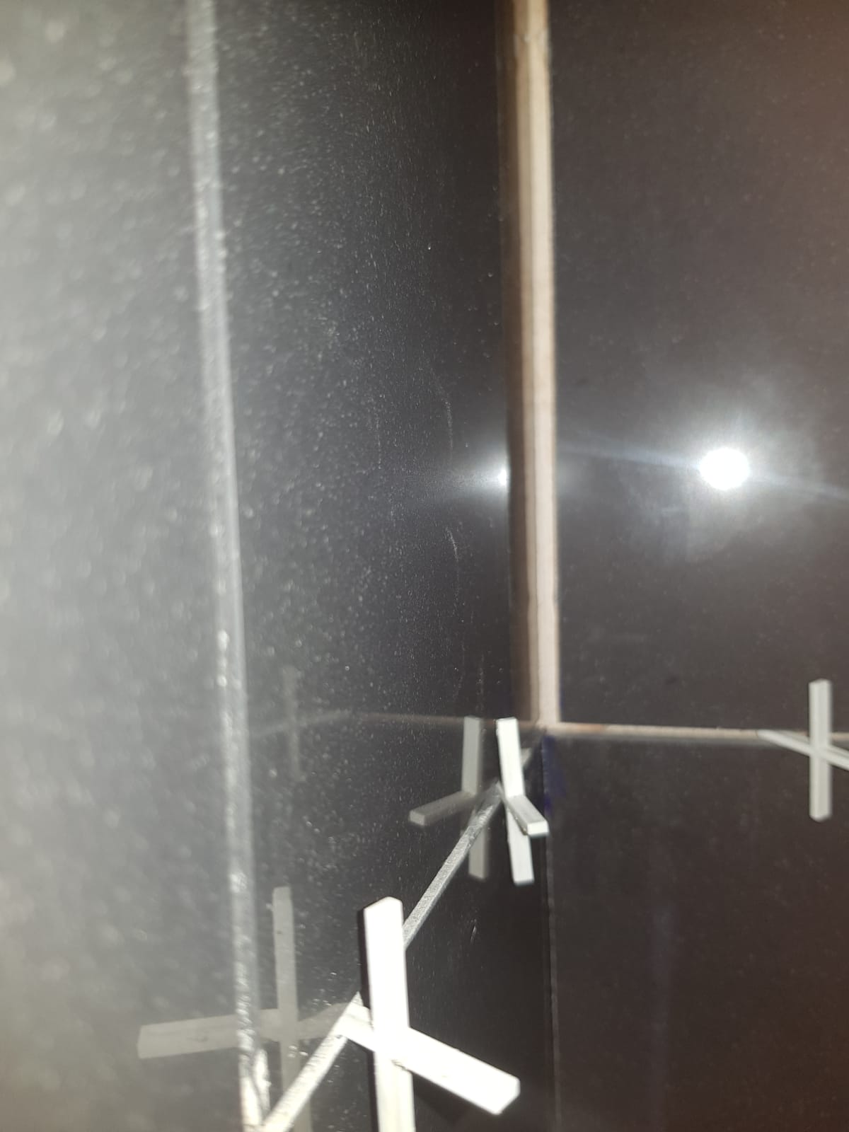

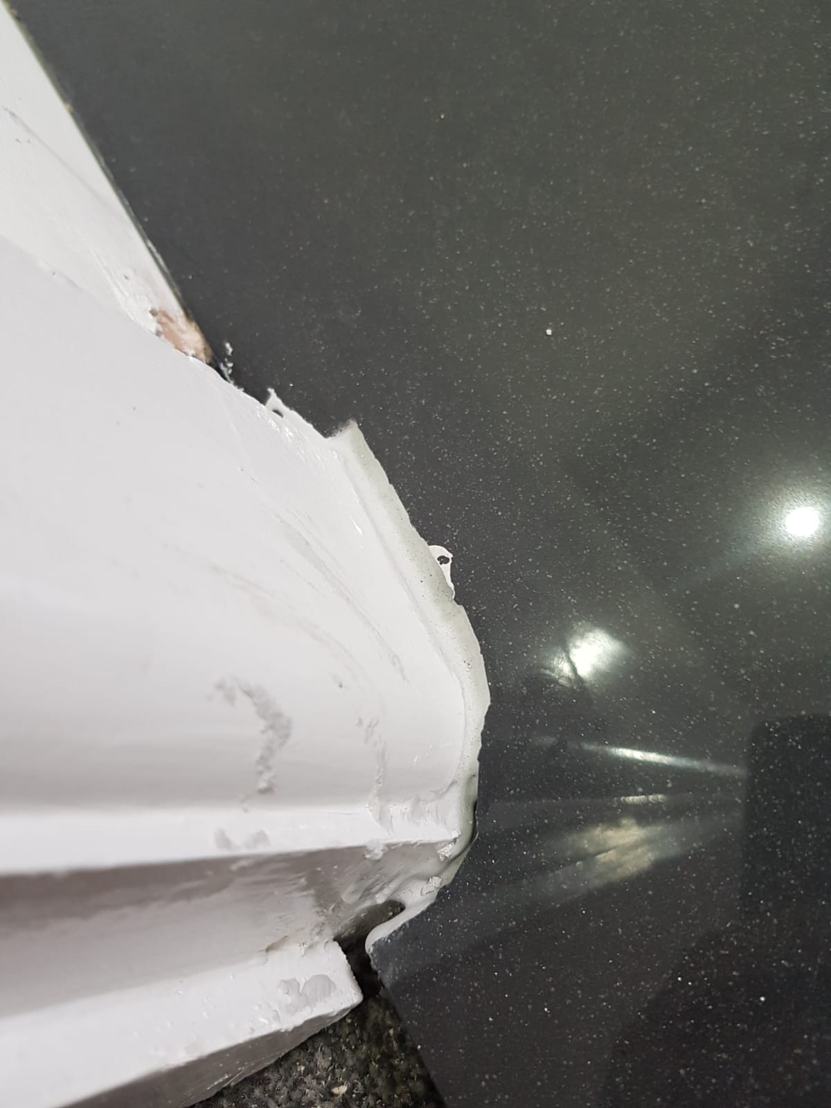

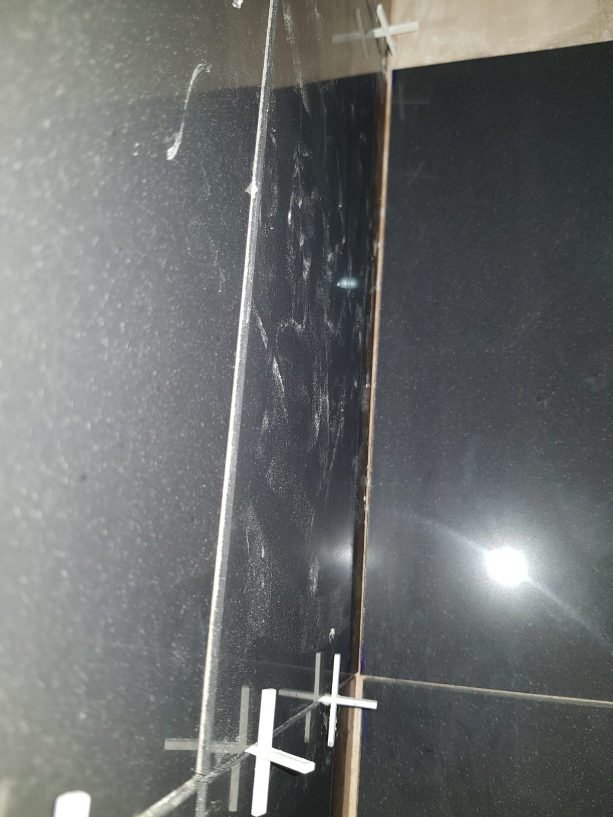

Just wants some professional opinions please as having a new bathroom fitted and this is how the tiles have been done.
He probably doesn’t have a hole saw to cut holes in the Porcelain so that he can drop the floor tile over the speedfit caps. He doesn’t have the knowledge to understand that it’s better to undercut the architraves instead of trying to cut round them.
The rest of it just shows the work of someone who doesn’t really have much of a conscience.
Most decent tilers would be horrified with themselves if they left a job like that.

Its very poor attention to detail, sloppy workmanship and I'm really sorry you have had to endure this by somebody purporting to be a tiler
