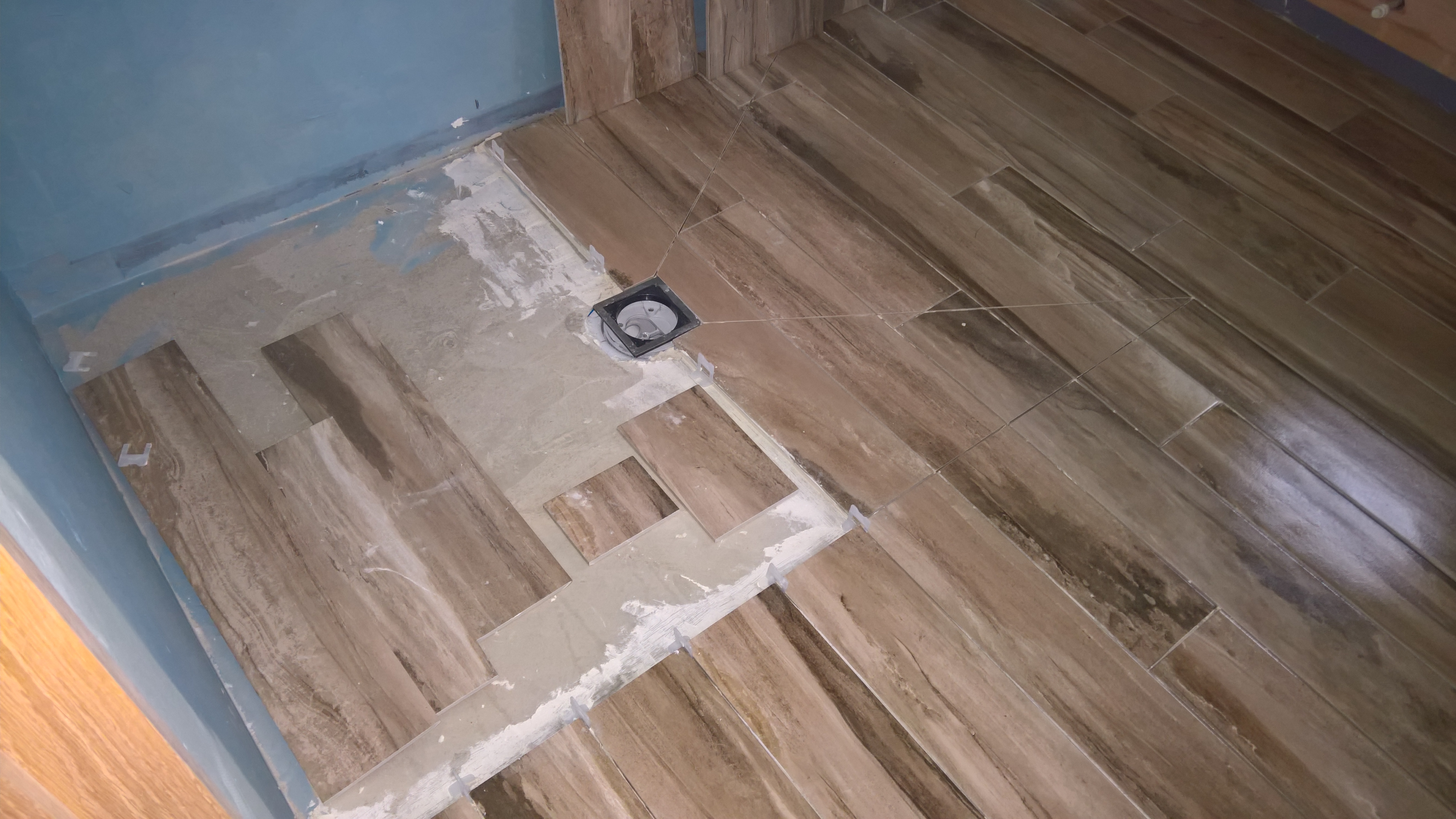

todays job, planks going up wall.
WP_20161114_07_59_54_Rich.jpg always floors first, easier to get joints lined up on walls
