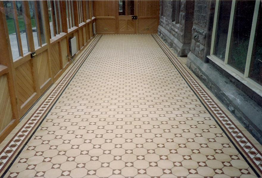

5111.jpgAre they hand cut tiles or standard 'original' tiles.?

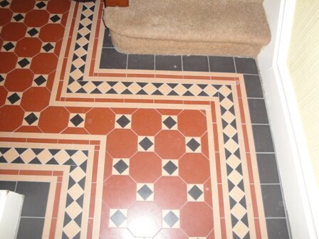

TJ has said it all really, is the stair detail like this?
